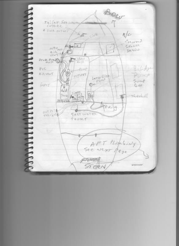

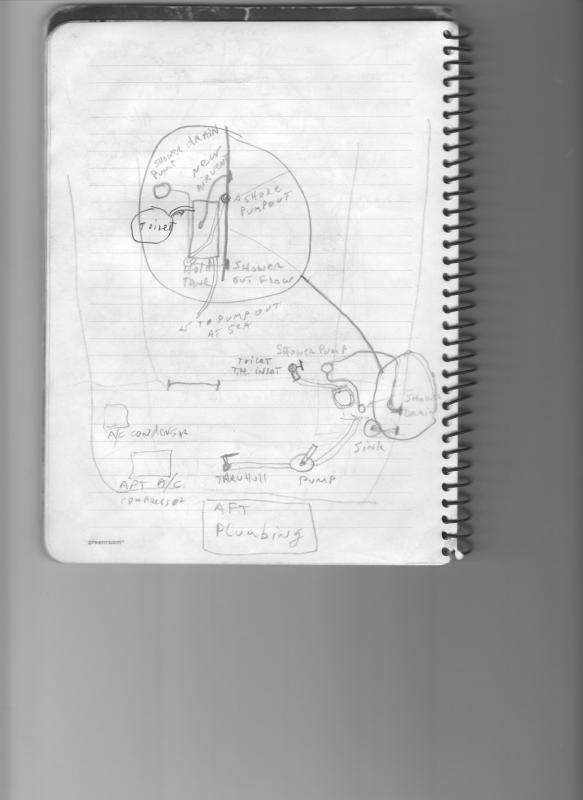

These sketches are pretty primitive but they should give you an idea of where to find the various parts. Your boat may or may not have had "at sea" overboard discharge pumps installed as mine did.
I replaced the tank air vent hoses that had absorbed potty odors with 3/4" rigid pvc pipes.
