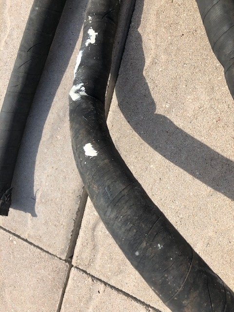

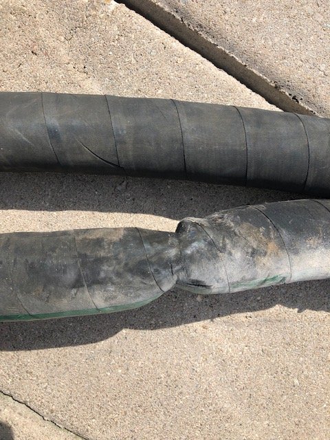

Well, I finished the hose replacement today on my O’Day 322.
To confirm, my installation had a 1.5” Trident waste hose from the toilet discharge, down through the toilet base, up into the lazzarette, 90 degree turn using a vented loop, back down through the floor of the lazzarette, across the prop shaft “tunnel” and into the holding tank. I do not have any overboard discharge.
After a lot of work, I got the hoses out and replaced.
A4B9537F-4F5E-4D81-893E-EB8D469E1792.jpeg 39E4C636-2197-4C3F-8F2B-99588EB11FDB.jpeg
As you can see, where the hose went through the floor of the lazzarette and the floor of the toilet base, they were pinched which made them hard to get out. Probably didn’t do the “flow” much good either.
I ran a new 1.5” Trident hose from the toilet to the holding tank directly, cut the length of the hose by 5 feet.
I did have to remove the water lift muffler from the prop shaft tunnel to get an eye on the hoses under the lazzarette and the toilet base. I cut both hoses off flush at the floor of the lazzarette and pulled them down from the engine room. And from there, pulled the hose from the toilet base.

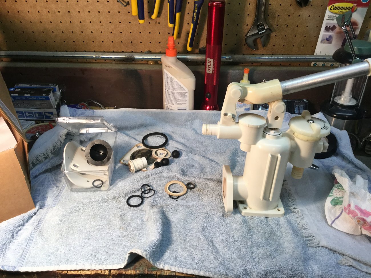

While I am in there, I pulled the pump off the PHII toilet and will rebuild it and replace the joker valve.

@Tally Ho you may have seen this but I did a video a while back rebuilding the PHii pump.
Hey Sefuller,
I did watch your video a while back and marveled that Mrs Sefuller let you do that on your kitchen table! It was a very helpful video.
I rebuilt mine in my workshop, and really did not need the directions, thanks to your video.
I watched your video again today to see if I missed something, because I had an extra o-ring that I did not use. But it looks like you did too. So I won’t worry about it.
I am hoping to get out to the marina today to reinstall the pump and check her out.
Thanks for sharing the video. Very helpful indeed.
