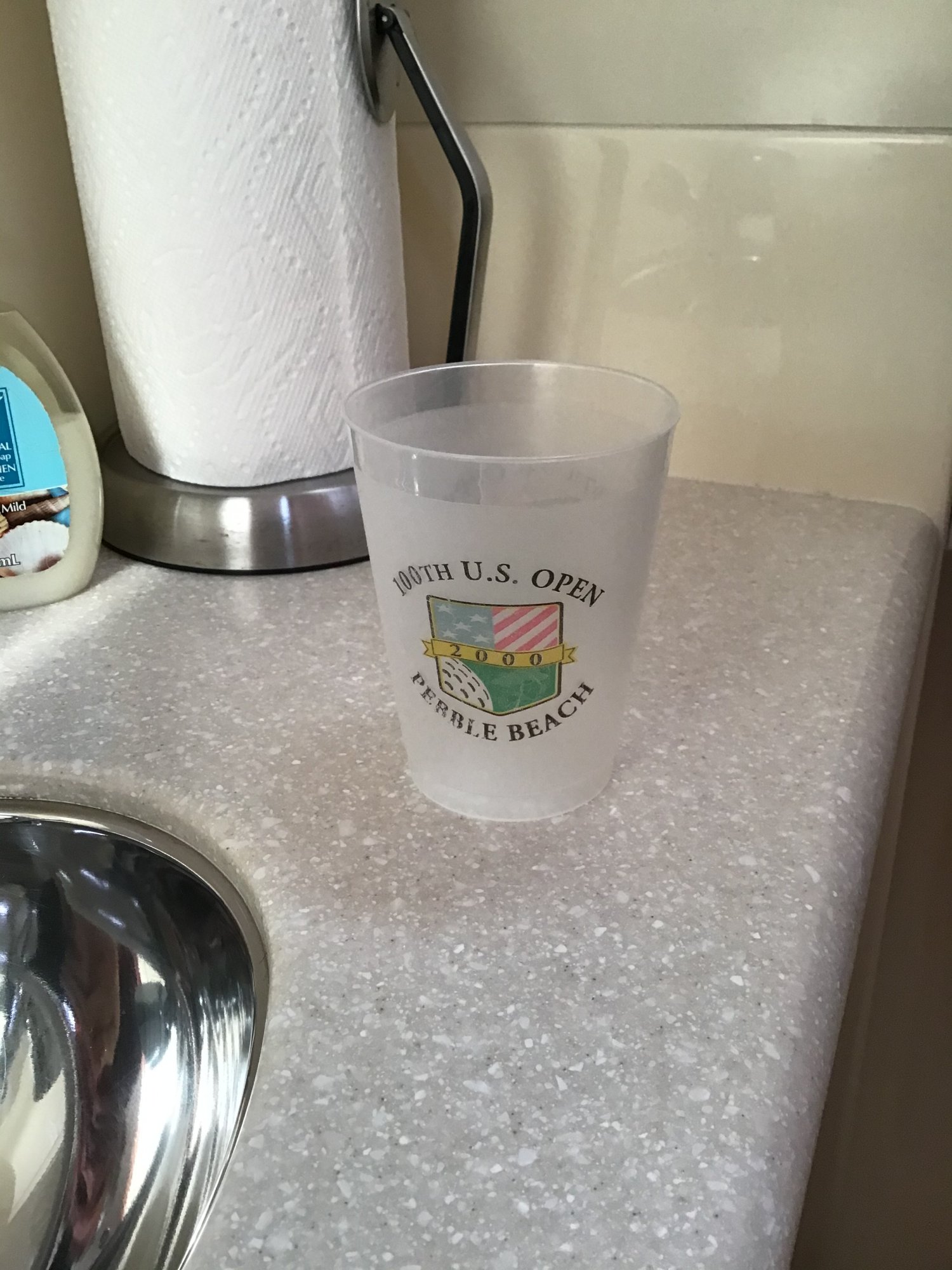

The height was the main factor in leaving clean sea water in the bowl ready for the next use rather than evacuating in an empty
I'm always surprised that it never seems to occur to anyone to use a beer cup to add water from sink to the bowl ahead of solid waste.
--Peggie

No beer cups here, but that is what I did before the new hose. Trouble was the worn out joker valve let the water drain out to the holding tank. Now it remains in the bowl until time to flush.

Oh what a waste of a perfectly good beer cup, Len :D. I use a plastic pee bottle (formerly a plastic wide mouth water bottle rescued from the roadside) for that process. It also serves as a middle of the night pee evacuation rather than using the flusher. Lesson learned from my winter backpacking days when staying warm in the tent was better than tromping in the snow/rain for a late night pee.

I have been doing that for years, Peggy, and yes, it sure makes "stuff" slide better......
