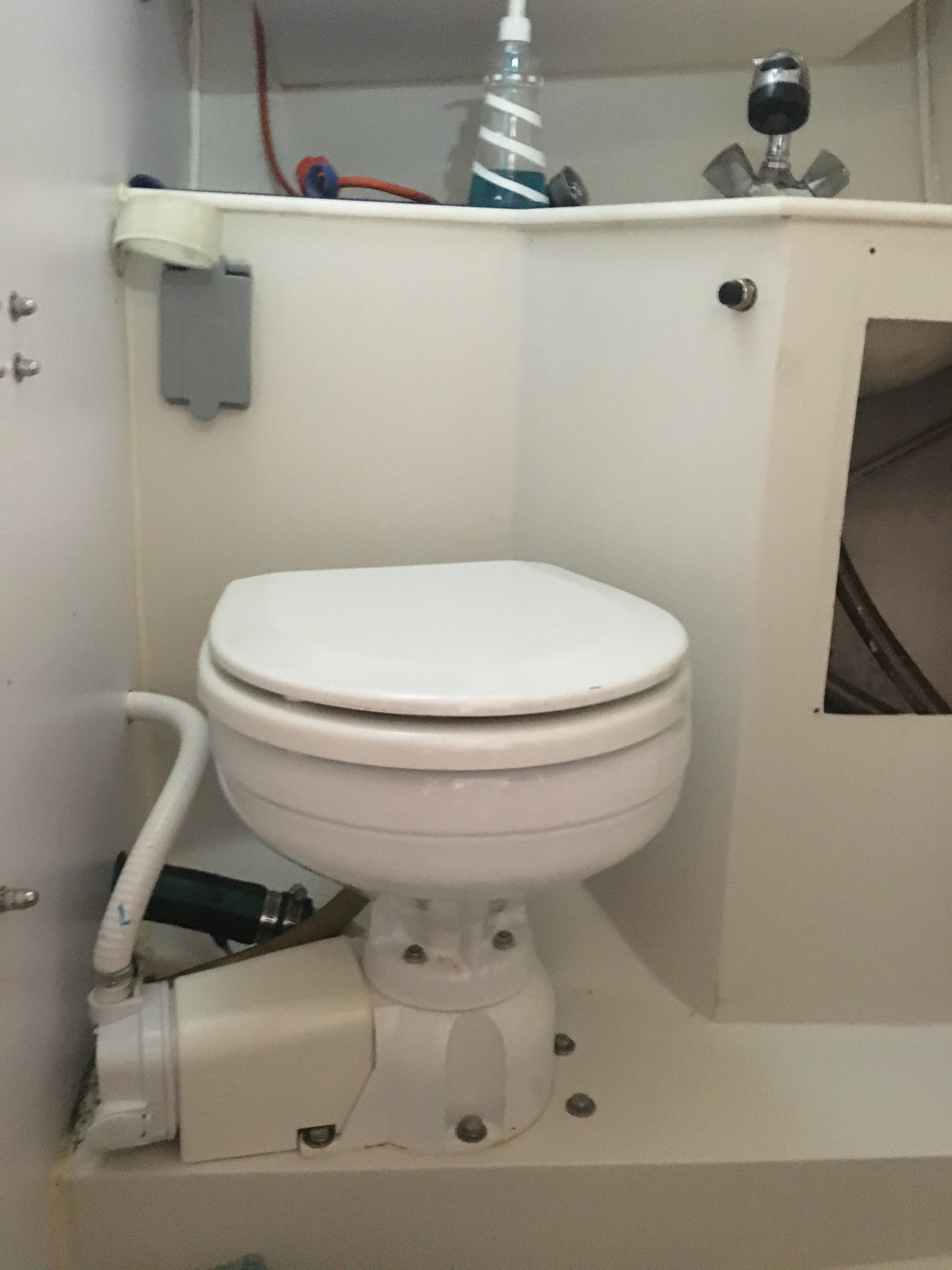

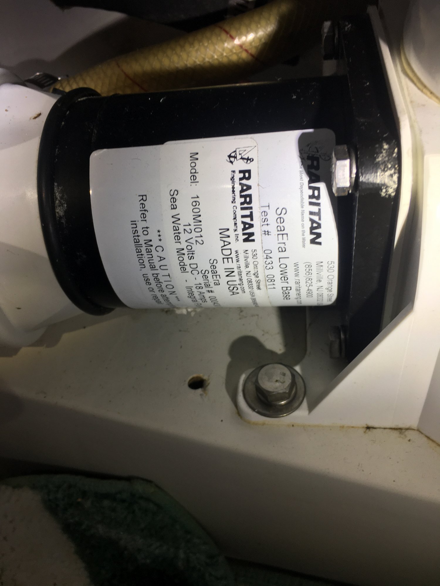

The head is a Raritan 12-volt, with a Sea Era integral pump, on the port side of the boat, forward of the salon, aft of the v-berth.

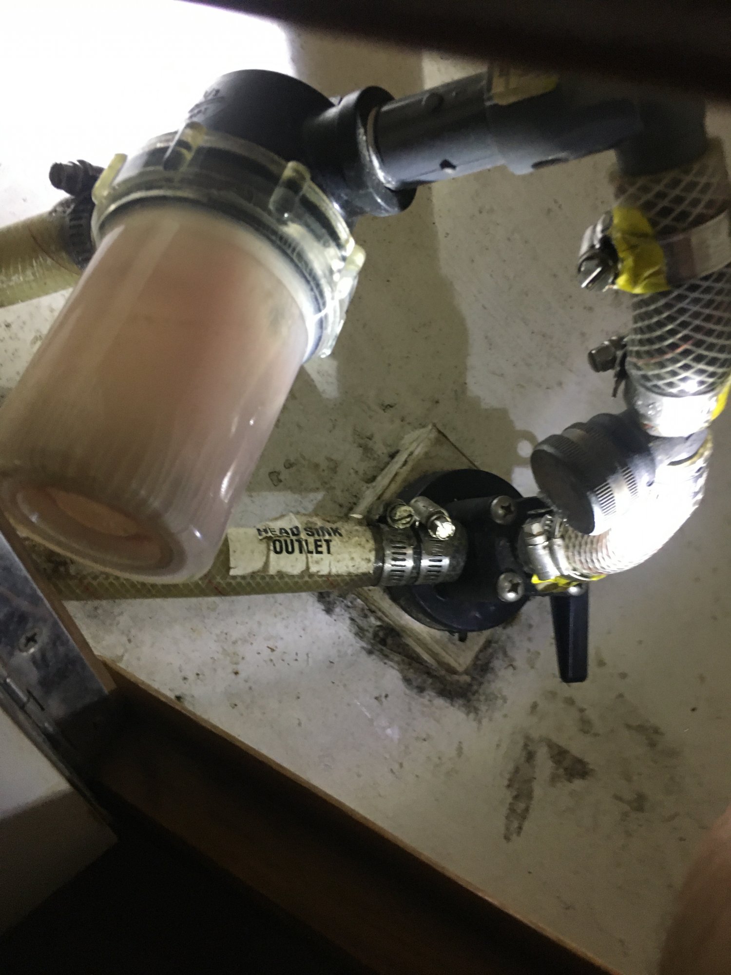

The head draws water from a sea intake through the hull forward of the head, beneath the v-berth but accessible from an opening in the wall separating the compartments.

Intake water is drawn up and flows through the bowl strainer fitted into the clear hose and then on to the pump.

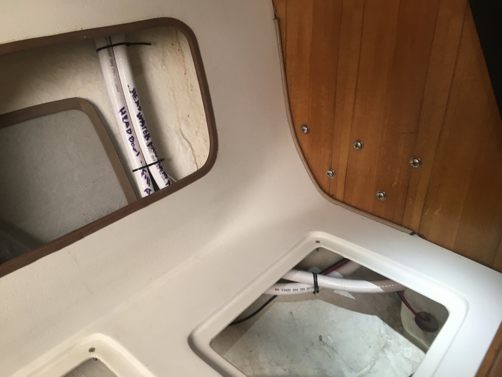

Intake water passes through the pump and now up through the white hose, heading out the wall of the head compartment. This white hose comes out the other side in the storage area beneath the port settee.

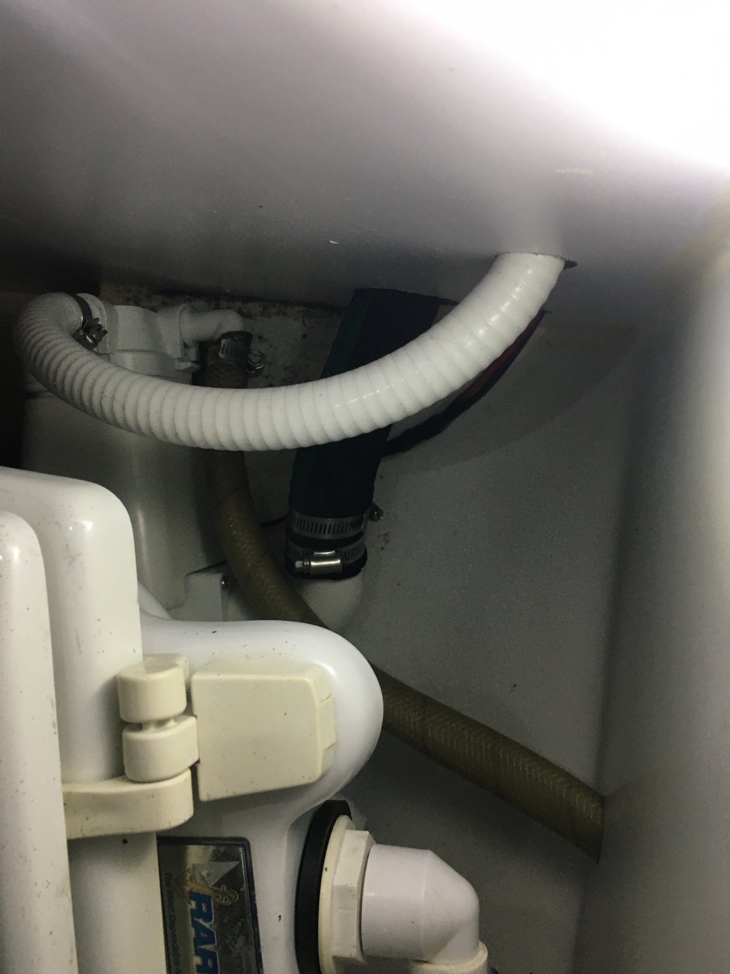

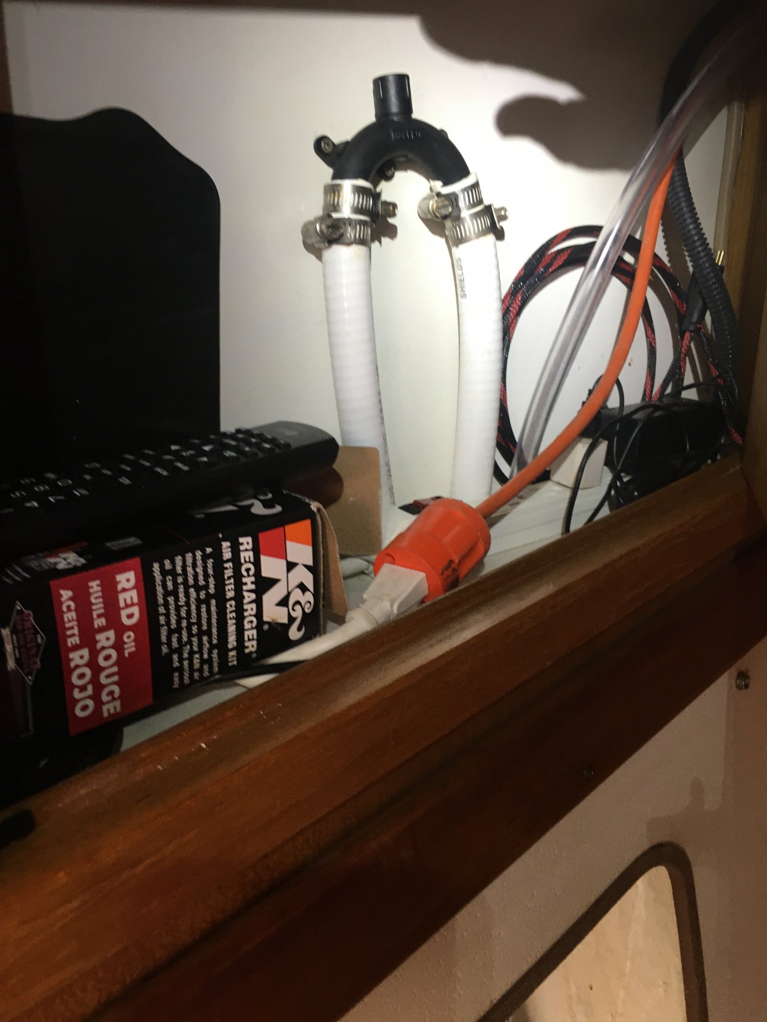

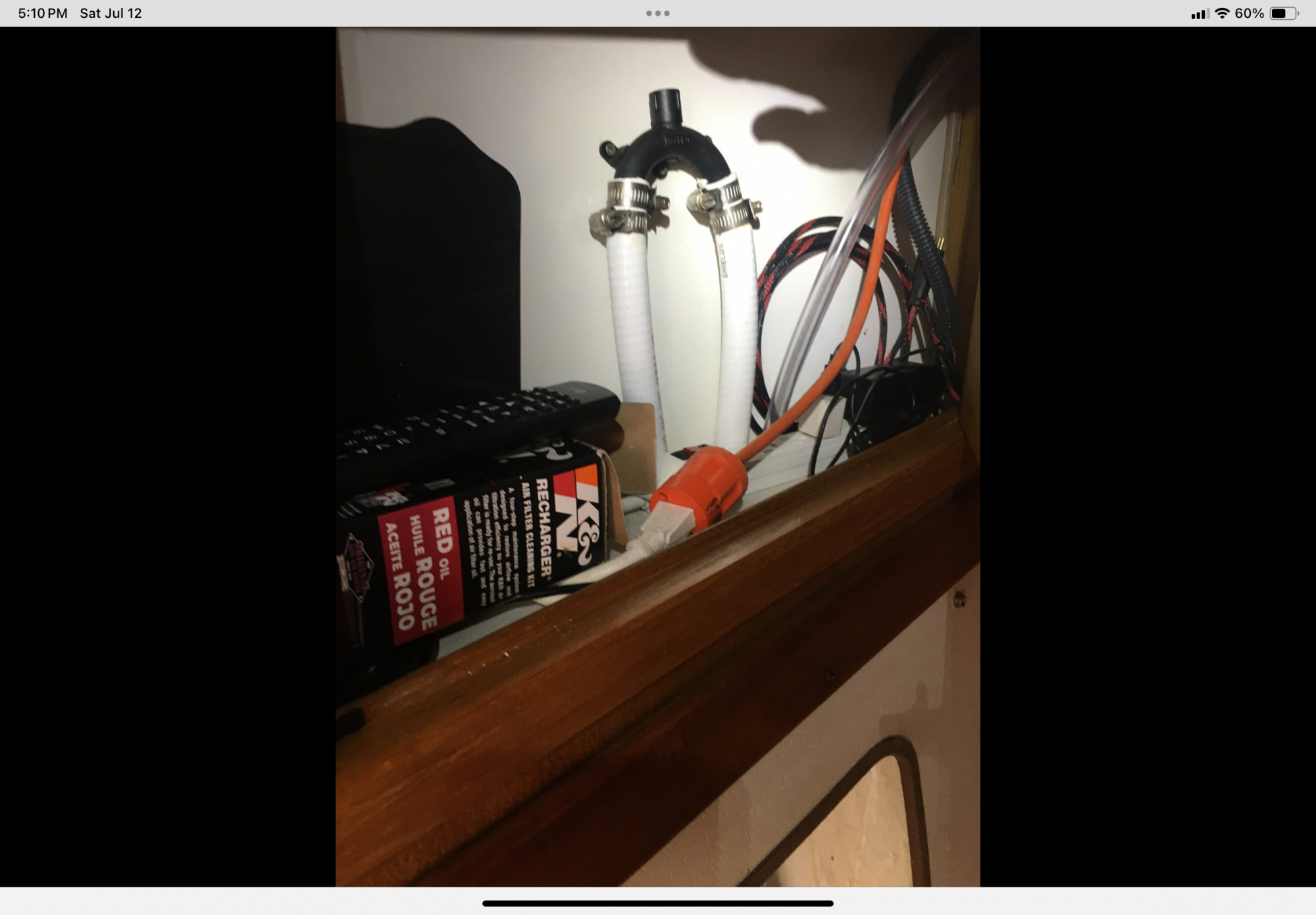

The water in the white hose continues up, until it reaches a plastic Y-valve.
The water then goes back down in the return white hose, back through the settee storage space and through the wall of the head compartment.
And the white hose brings the water back to the head in the center-back at bowl level. (Through elbow joint at bottom of following image.)

Since it fills up in such a short period of time, I would disconnect the hose from the seacock and observe if water drips from it even when it is closed. The head is below water level and you might find a flood in your bilge. I can not think of where else the water is coming in from.
What year and model boat is it?
You might consider adding a second hose clamp on the hose that is going up similar to the horizontal hose clamps.
The only other way the bowl may fill up is the horizontal hose that appears to come from the sink. Is the pressurized water turned off?

I know less than a little about plumbing, much less marine plumbing, so I was surprised to see that sink drain line leading to the intake valve. I'd love someone to explain that.
But to answer your question, this was happening with all power off; I'm not sure if the sink water was still under pressure, but also will have to go back and look at all the sink connections. I didn't take enough photos of that while I was "under the hood."

First, just to clarify, this is not a Y valve. It is a siphon break .

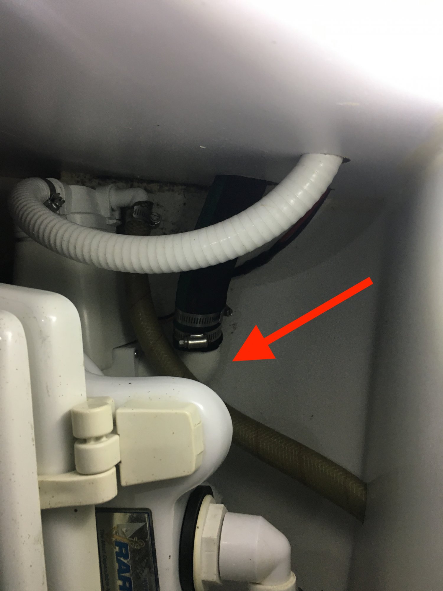

This model electric head *does* have a joker valve. It's in the 90-degree elbow at the back of the head here:
Thanks for correcting me on the terminology -- I called it a "Y-valve" to describe its shape, and I had interpreted this to be the venting point for the siphon loop.
In addition to the post-pumpout clue, I also noted that the water filling up in the head was clear, i.e. not a hint of human waste in it.

there is an actual Y valve, used to route waste overboard or to a tank. But your photo is a siphon break that is common on marine toilet plumbing to avoid having a siphon sink the boat.

The Catalina Mk I also uses the thru-hull by the head sink for both the sink drain as well as the toilet flush water intake. Free flow of flush seawater shouldn't be an issue given the antisiphon loop (pictured) which prevents free flow into the commode if the pump seals fail, and thru-hull is left open. As far as potential commode overflow into the bilge, the Mk I commode rim is set just above the waterline and I would assume the same on a Mk III? What you didn't discuss was black water plumbing from commode to tank and then presumably to a Y going to macerator pump / thru-hull (?) and to the deck cleanout.
I had several similar mysterious fillings of the tank and toilet bowl that turned out to be all of the above. The first issue was back flow from the seawater thru-hull (left open for days) thru a leaking pump which did not have anti siphon loop (but now does) which you have covered. The other problem was backflow thru the macerator pump into the holding tank. The engine raw water thru-hull is right next to the macerator dump thru-hull. Being lazy, I normally just lift the cushion /seat board enough to reach in blindly to open the engine valve. One overnight trip I reached in and opened the dump valve by mistake (macerator is in but electrically disconnected). After noticing dry exhaust I went down and opened the engine valve and just assumed I'd just forgot it and didn't notice the dump valve open. By next morning the tank had filled up and it was high tide in the commode. The boat is lake bound so the fix was capping the macerator side of the Y coming off the tank, removal of the macerator, capping the thru-hull, and tie wrapping the handle shut.

Because your toilet bowl is at or below the waterline, you need to install a vented loop in the toilet intake. It needs to be at least 6-8" above waterline AT MAX HEEL, not just when the boat is at rest, which on most sailboats puts it 2-3 FEET above the bowl. It does NOT go in the line between the intake/sink drain thru-hull and the pump (that would interfere with the toilet's ability to prime)... it belongs between the pump (pump/motor assembly) and the bowl. This requires replacing the short piece of hose Raritan used to connect them with hoses long enough to put it high enough.
This will make it unnecessary keep the thru-hull closed while you're aboard and save you from yourself if you forget to close it when you leave the boat.

Thanks, Peggy. You can see the vented loop in the photos here:

Clean the valve at the top of the anti-siphon. Been there, done that. If it's blocked with "gunk" you're siphoning water into the boat via the head.
Jul 12, 2025
6
Catalina 30 Mk III South Haven
Thanks for the video to go with that tip!
I spoke with someone at Raritan today (thanks, Mac!) who suggested I look closer at this exact part of the system. We shall see!
