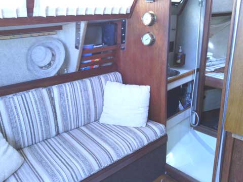

This is picture from an S2 8.5 I yanked off the web. Is the compression post buried in the bulkhead wall to the port of the flip down dining table.

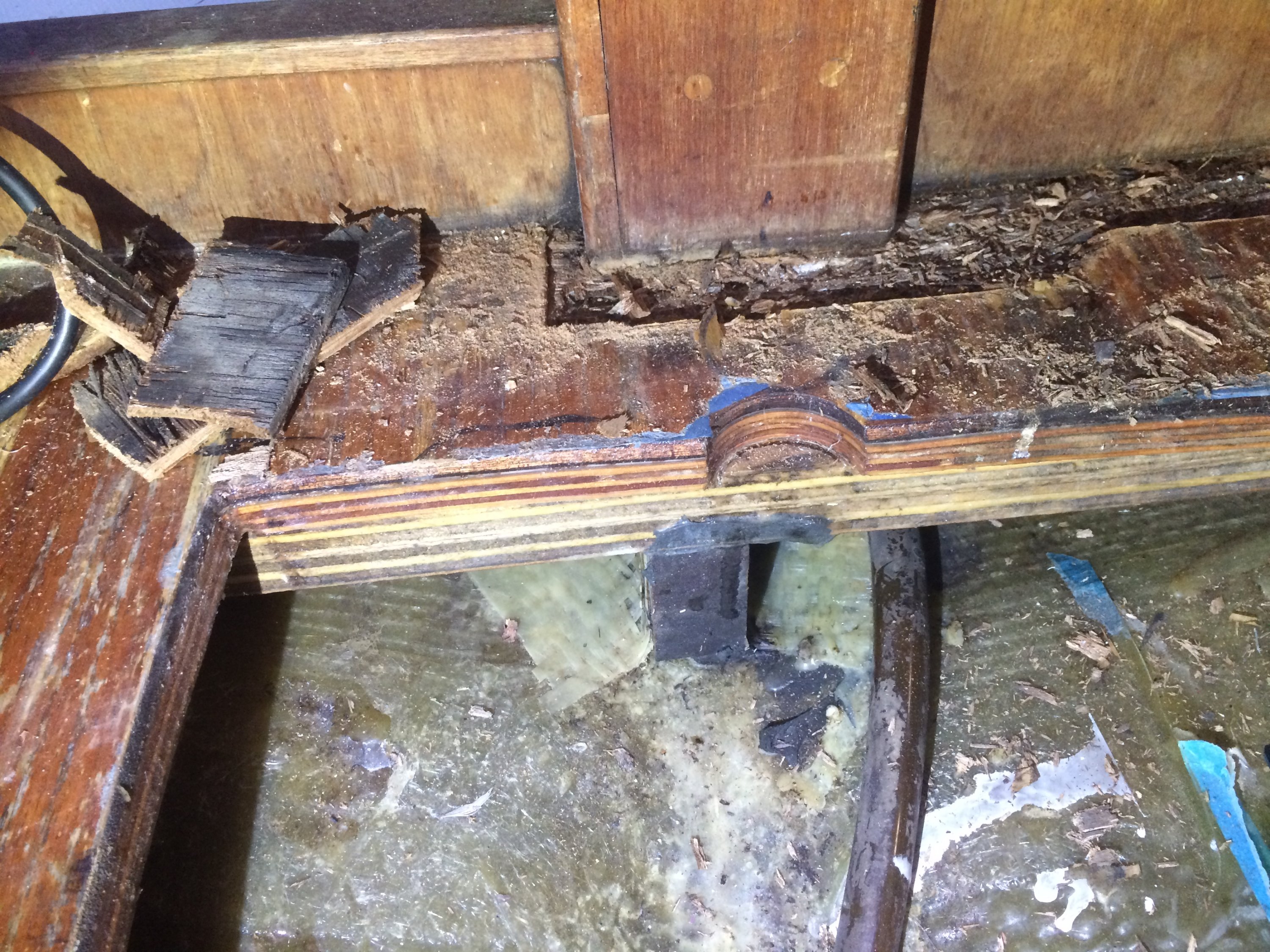

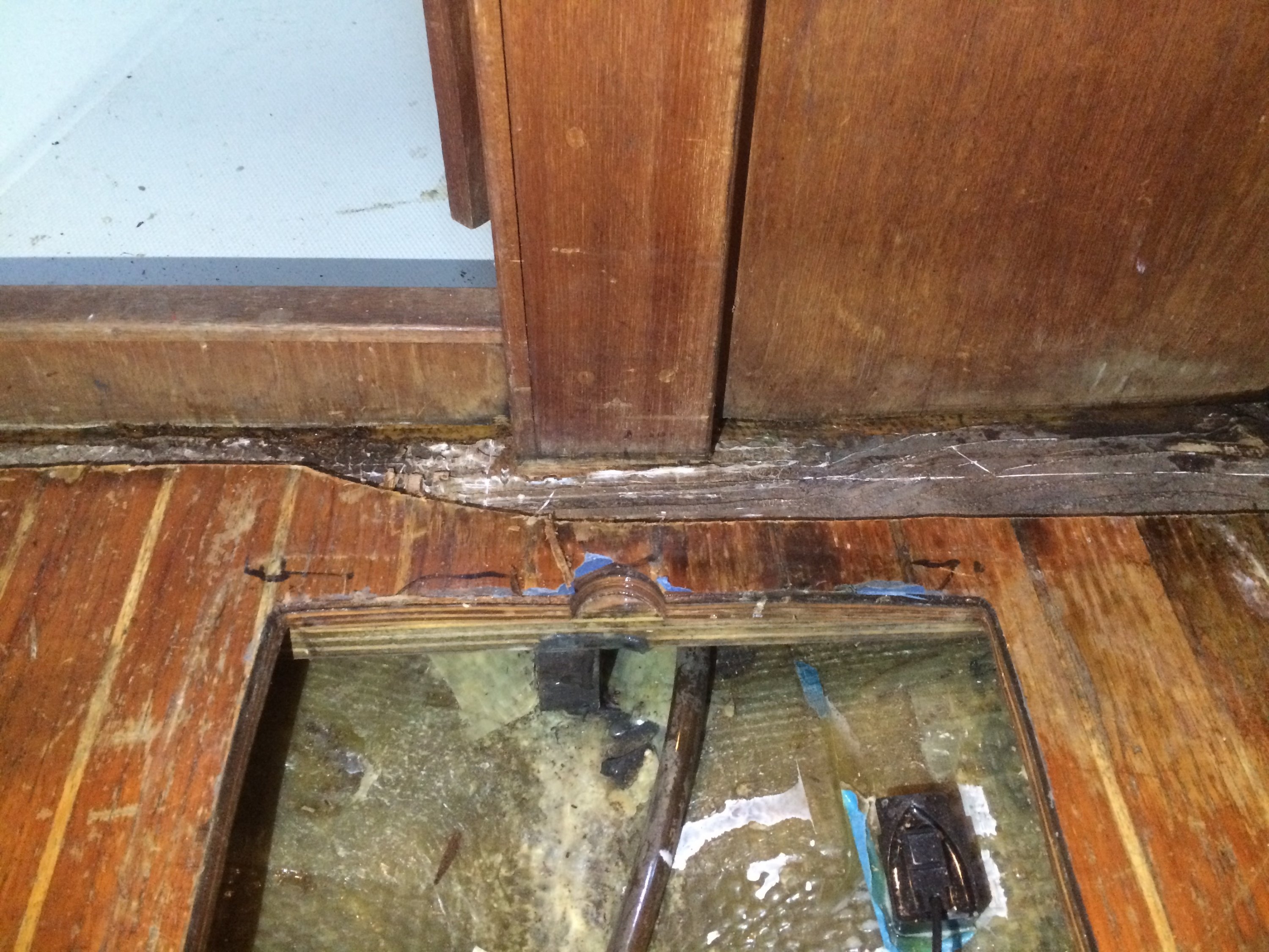

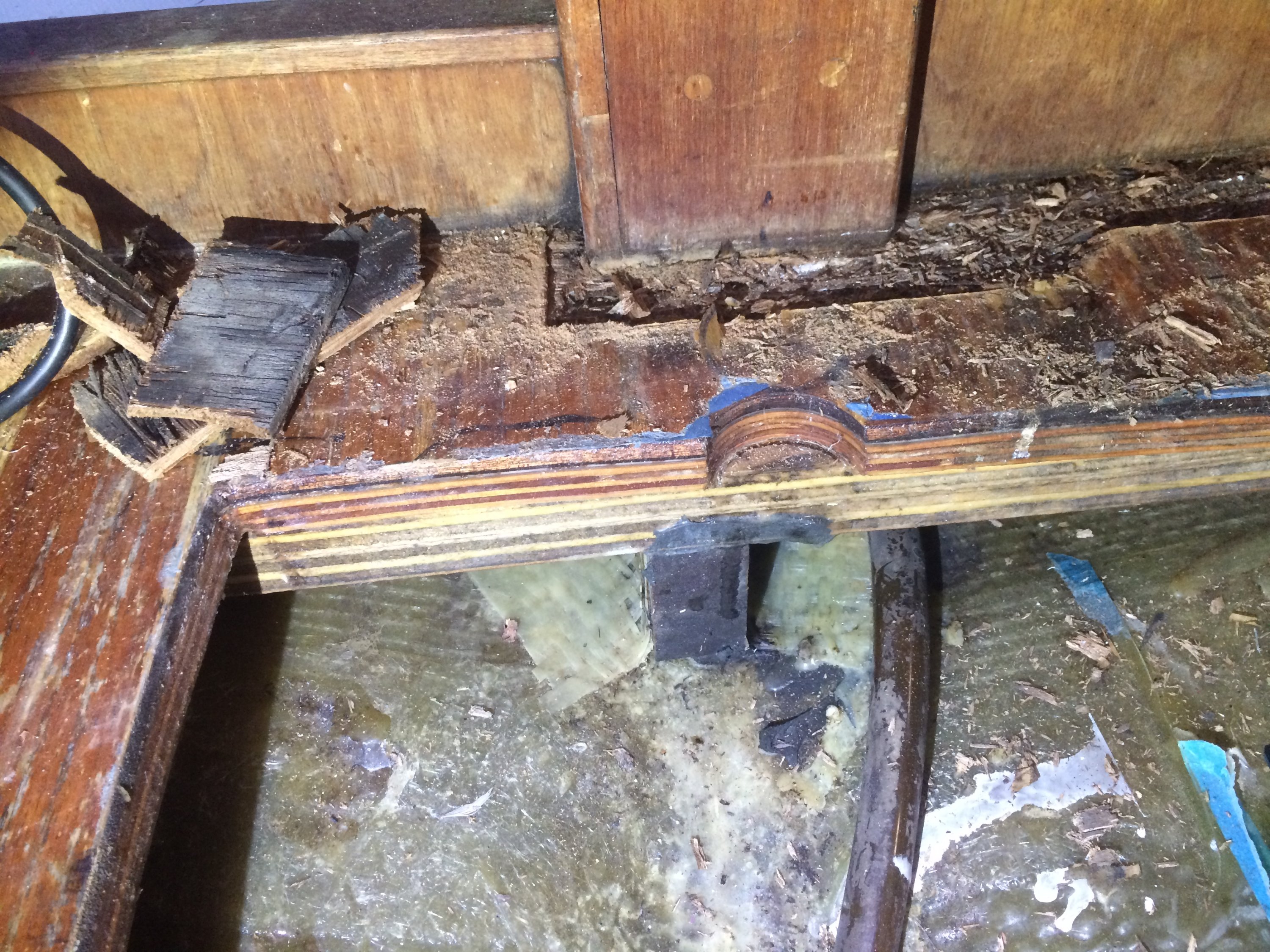

I did some digging. Literally.... I used a hydraulic jack and a prybar to push up my compression post. I loosened the rigging as I went. There is 1/4 inch of teak and holly flooring that was rotted under he compression post and bulkhead. There is a 'sub floor under the compression is 3 3/4 inch layers of plywood then there is a hard wood 2 by 4 attached to the hull. Luckily the sub floor is laminated and not rotted!!!
I will attempt to upload a picture.
I cut out all the rotted wood and dried underneath.
