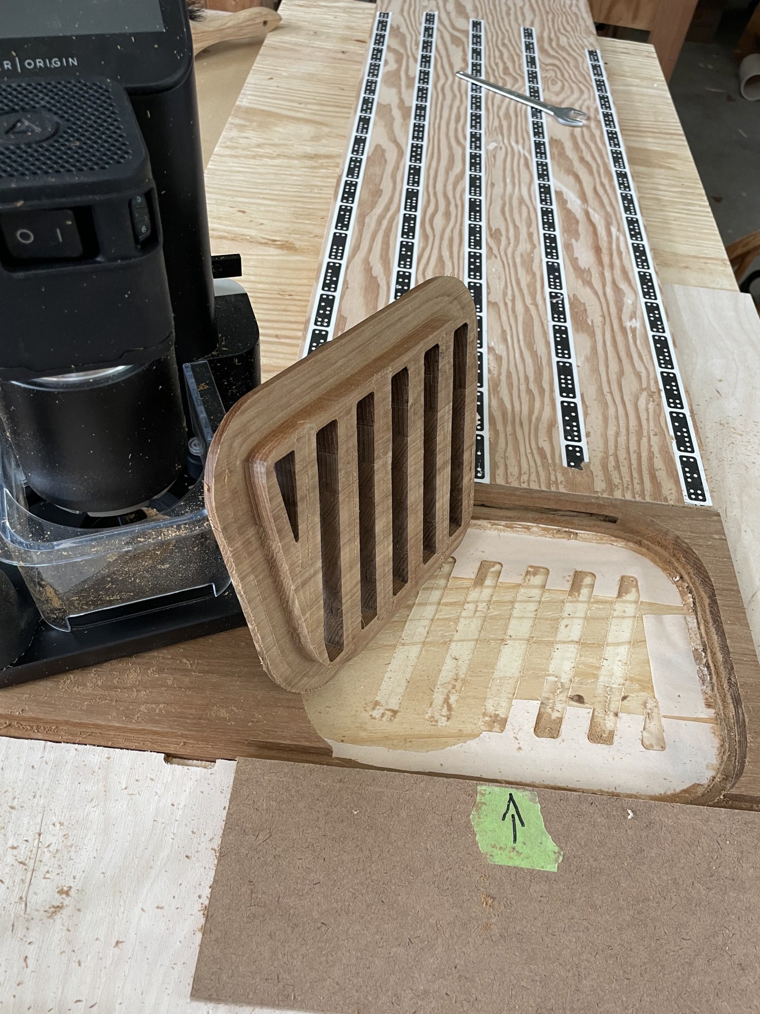

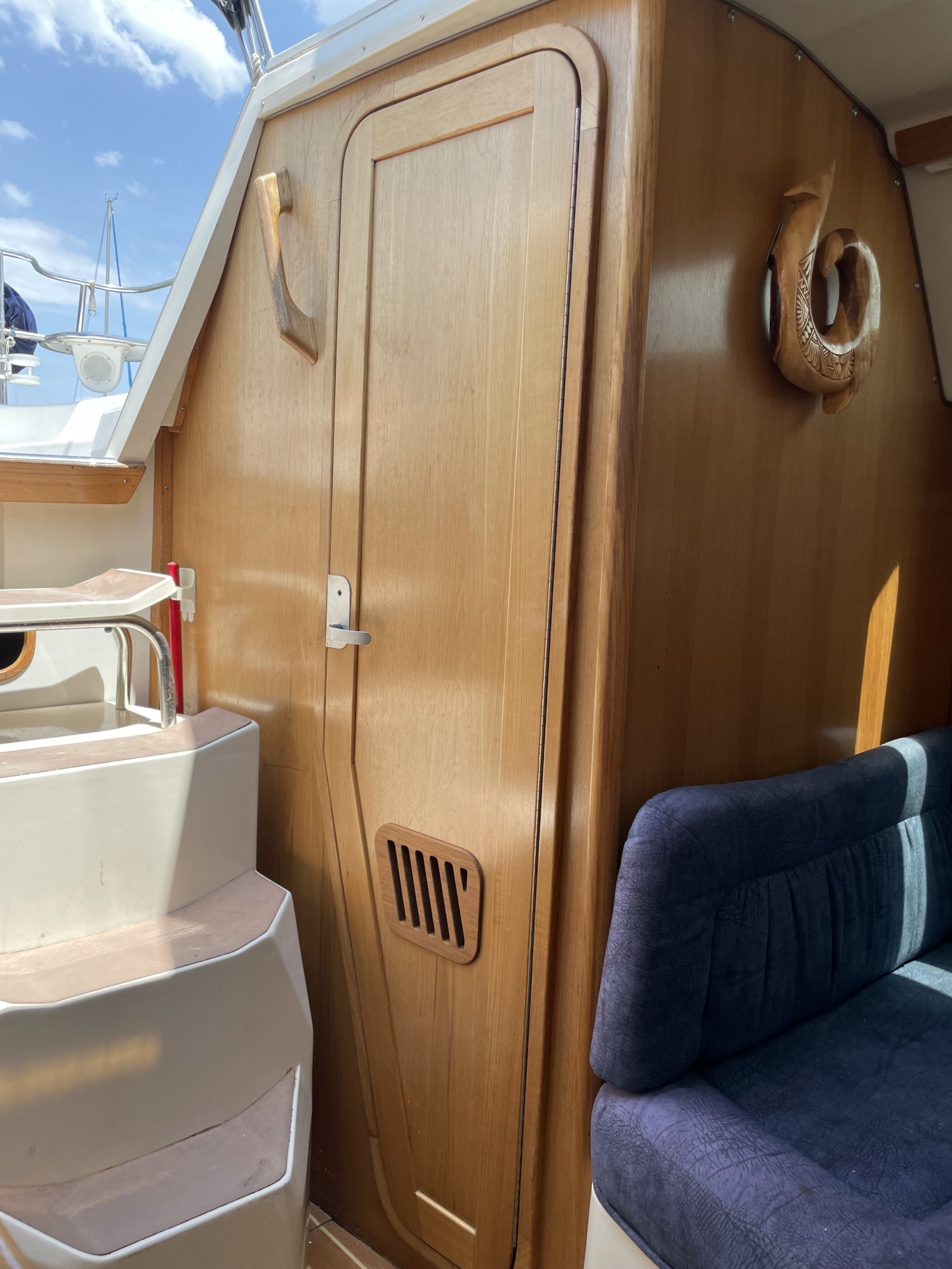

Recently I took action against a long standing problem of not enough ventilation in the head of our Catalina 310. I decided that a good sized vent low in the head door should help. My hope is that air flowing over the outside of the open head window while underway should draw air from the cabin salon and through the head to the outside. I'll let you know how it works after the fall sailing season.
Finished project
Rough cut Vent

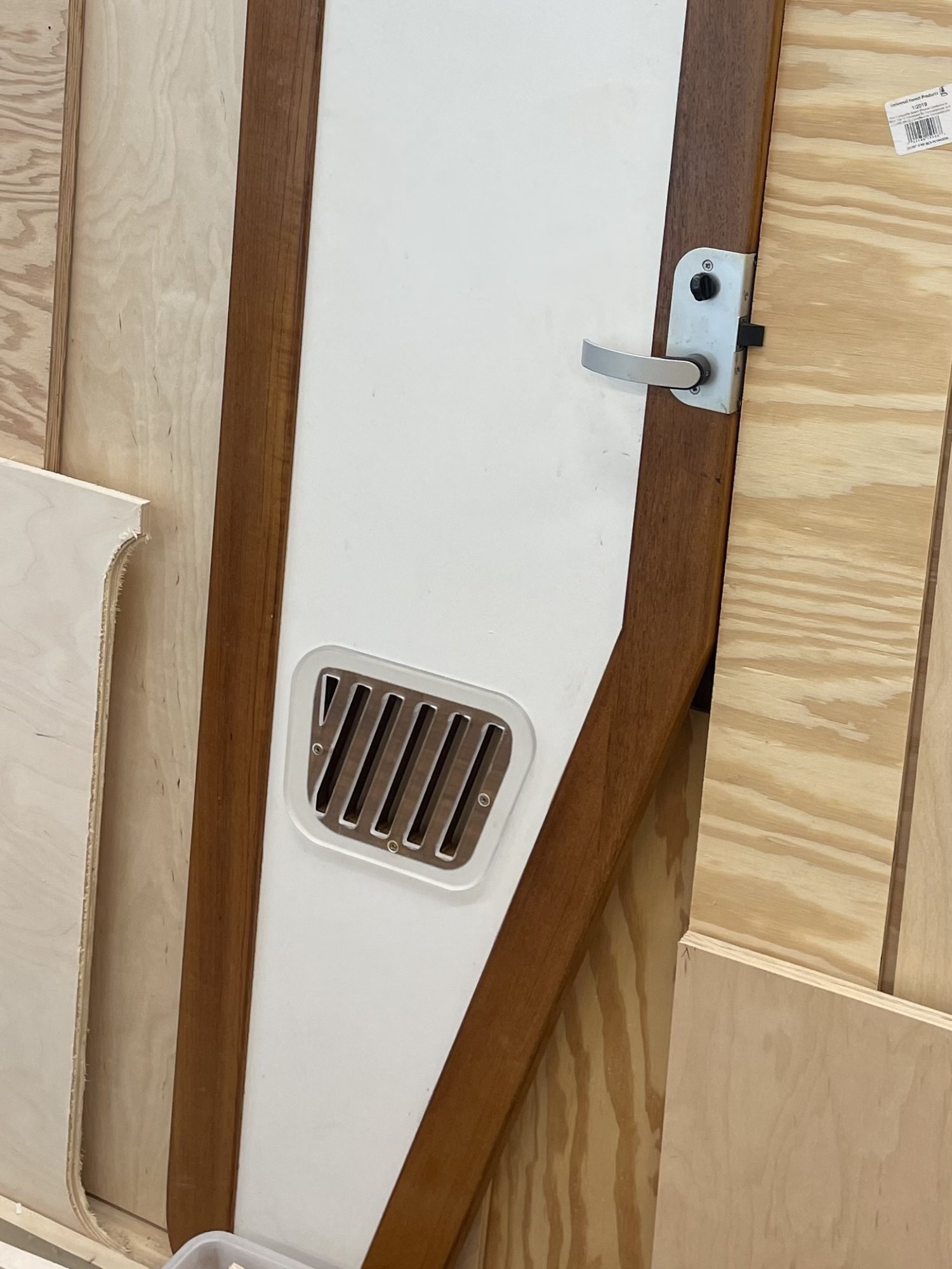

Interior view, (plexiglass interior flange holds the vent in place)
