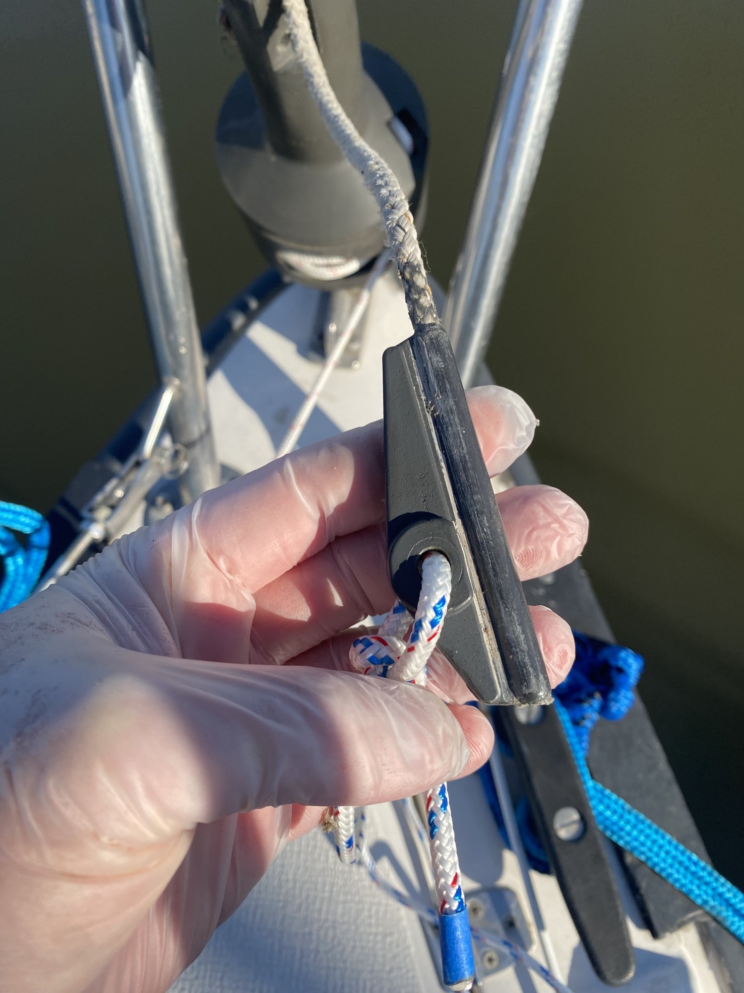

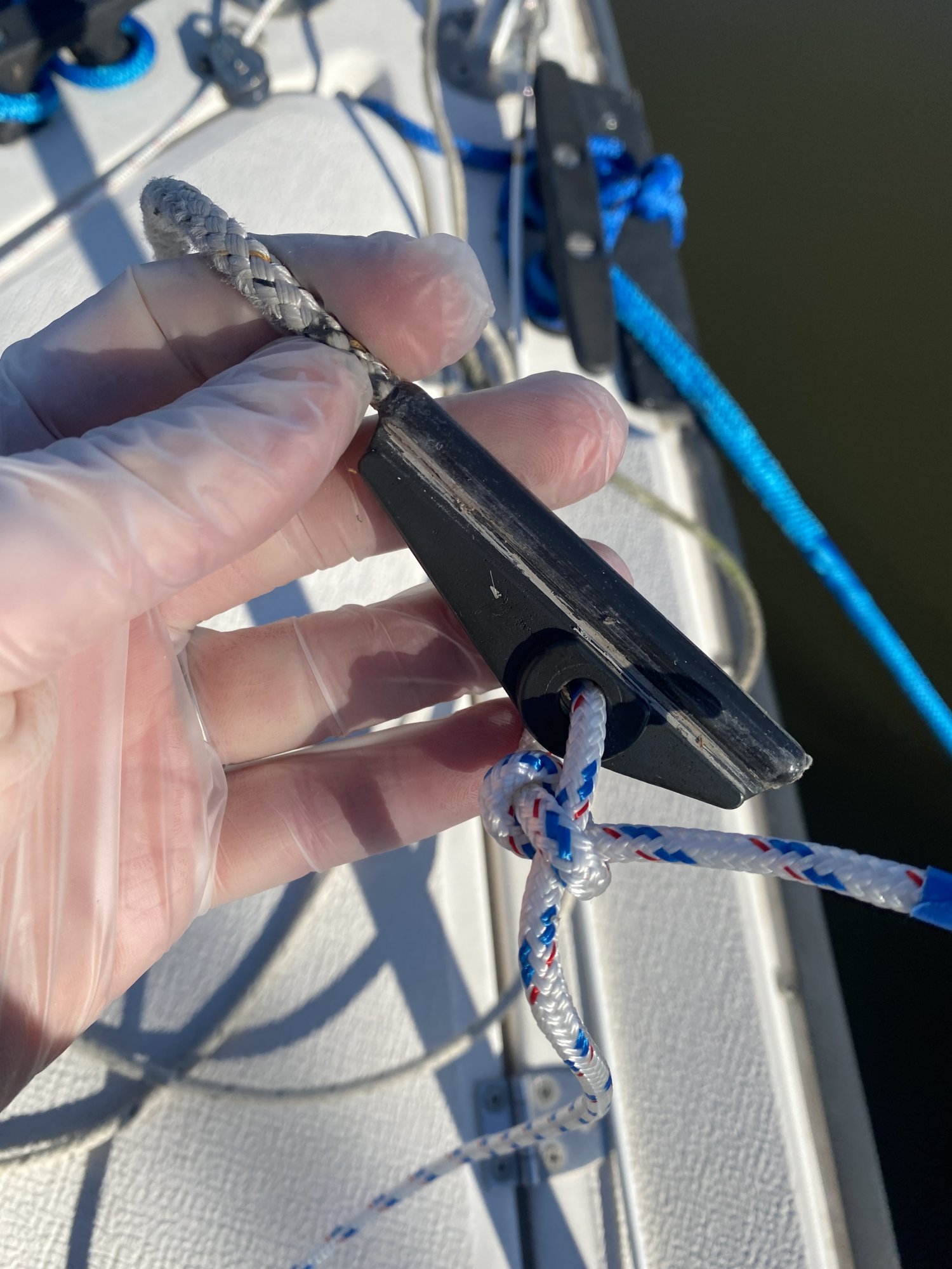

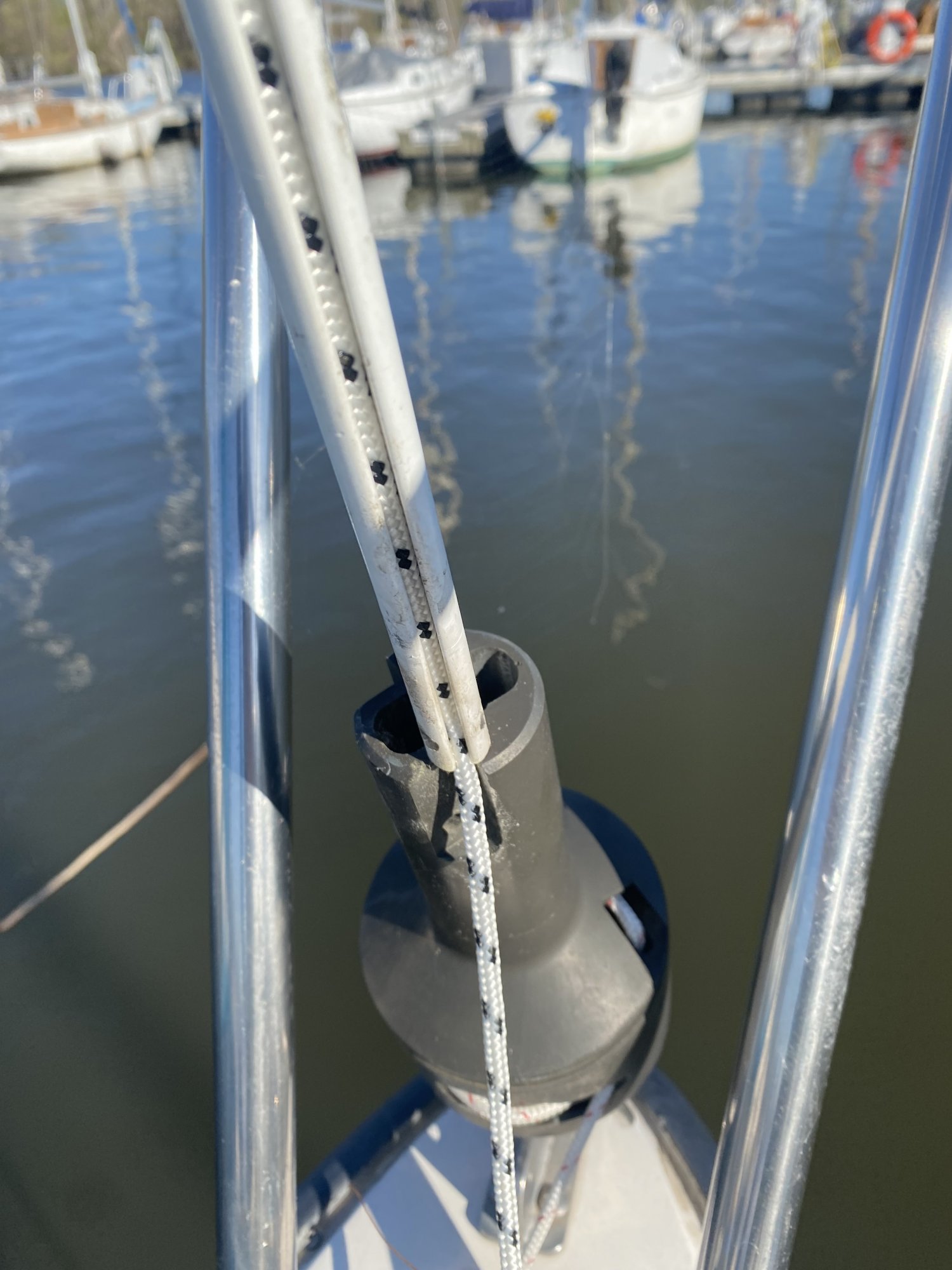

Hi - I went to replace the halyard on my older flexible furler and was confronted with a haylard design that uses a slug that fits into the extruded luff shaft. The issue is that there is no way to place another line into the slug (it looks like it may actually be called a traveler in looking at parts on CDI's website - CDI FF9 Halyard 5/32 wire 53' with traveler).
I'm usually pretty creative on improvising but decided to just leave it alone until I figured something out.
Please take a look at the pics and let me know your thoughts about this.

So the rope in the traveller cannot be pulled from the end (pulling the rope out of the molded plastic)?
What does the new halyard come with…a furrule? How does that attach to the sail?

Is the line glued into the traveler of somehow hot molded?
Maybe cut it off, drill out and reglue.
Even if you make a new traveler up you have to attach the line securely so it doesn't pull out.

Hi Greg - Yes, that seems to be the case - i.e. you need the plastic traveler inserted in the extruded housing to pull the haylard down (which runs up through the top of the furling) to raise the sail. It's a pretty simple design. Seems that the metal ones are how they are doing it today. Thanks!
gary
Thanks Gary - it looks hot molded to me but perhaps the drill out method will work. Will consider it. Thank you!
