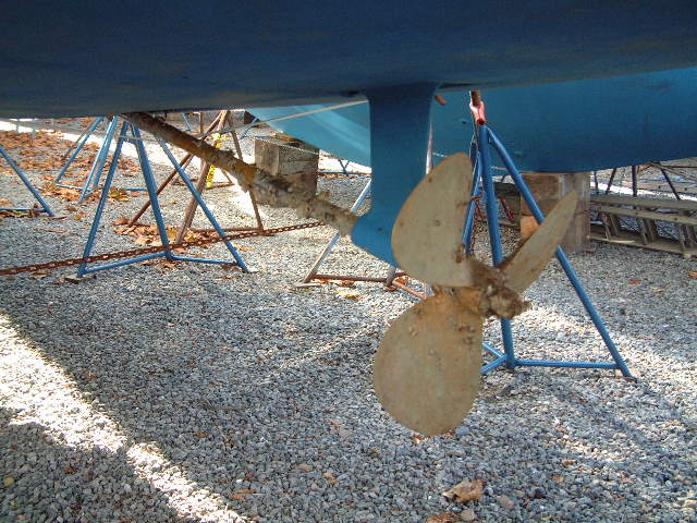

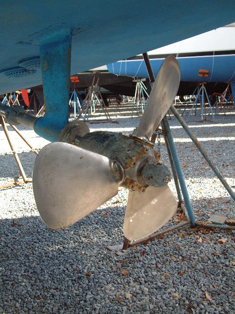

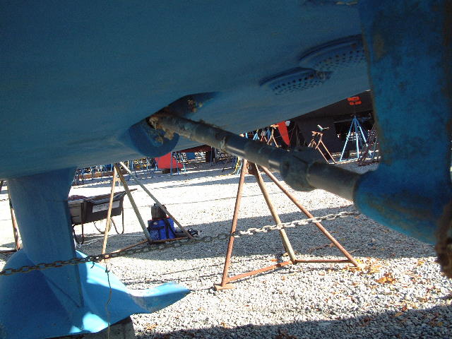

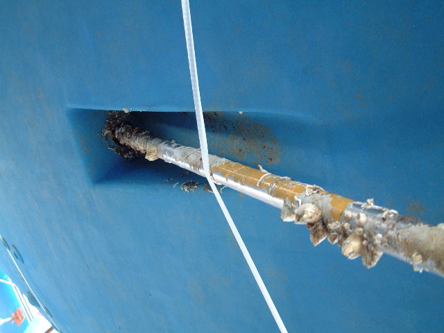

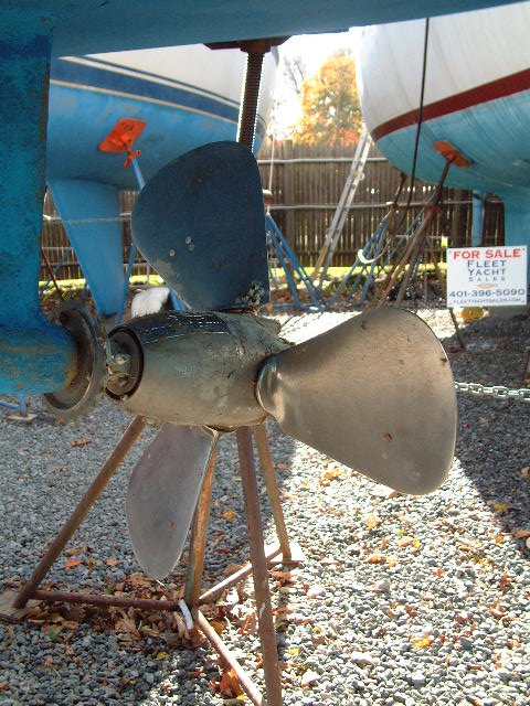

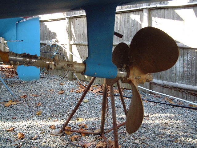

Well, it is a mixed bag. A friend and I split the smallest kit and coated both of our props this Spring. We used our boats differently- I went to Maine and motored extensively, and then the boat sat on the mooring for almost three weeks before hauling with no use. I had a few barnacles but generally the prop and shaft looked better this year than in previous years with the Pettit Zinc Spray coating. Look at the first three pictures.
My buddy used his boat most weekends and his boat also sat for about two weeks before hauling. He motored about a normal amount - probably about 125 hours for the year. His prop and shaft has about twice as many barnacles as mine. See the last three pictures.
So it this a success or a failure? I am disappointed that nearly all of the Hawkspeed product is off our running gear. I was in hopes that I might get 2-3 years out of the application. I suspect that it came of with the power-washing because if it was off while the boats were still in the water I think we would have had much more fouling. The cost to each of us was about $75, but I think the product did work for me. Is it worth the effort and expense? I' still deciding.....
