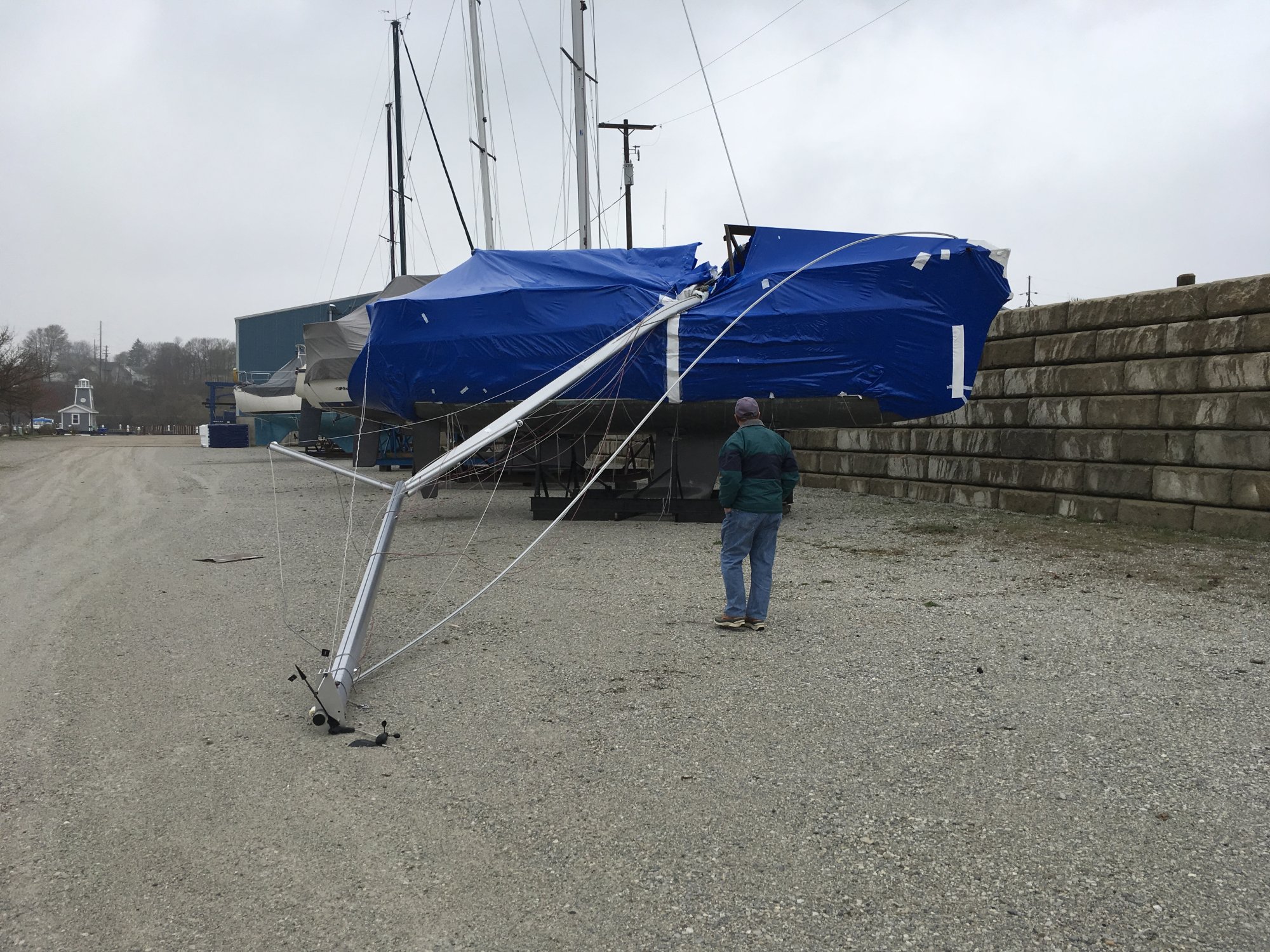

This is what happens when the rig is compromised. What we think happened was that when the boat was shrink wrapped the lower shrouds were disconnected and taped to the mast.
An extremely high wind did the rest of the work.

Mother Nature can be cruel if you give her a chance. Hope you can get her back together before the season starts.

No problem getting it back together. That all happened in 2017. Boat was in winter storage and not used in 2016 because my wife passed. Got a complete new mast, standing rigging, head foil, all running rigging all in the space of about 4 weeks. Had the boat back in the water then.
My daughter in law helped me put everything back together.
I would hate to think how long it would take to get the parts with covid and supply chain issues we’re having now. having trouble just getting belts for the impeller pump now...

I have seen mast failures before due to disconnecting lowers. They are there for a reason even without sail stress.
