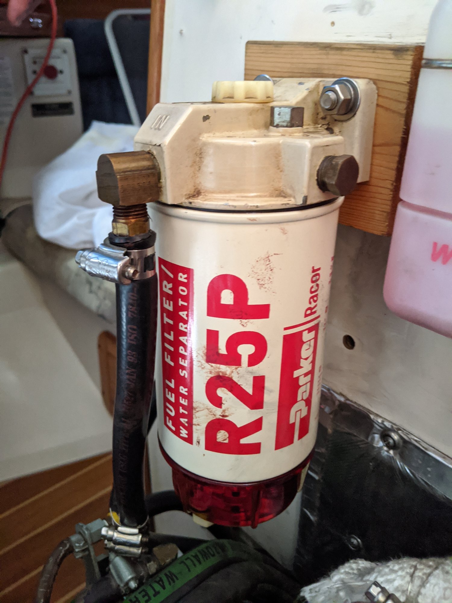

I currently have a Racor 245 series primary fuel filter with a plastic bowl. It is installed in my engine compartment and, I believe, was the stock installation. I have a '93 Catalina 310. I read that the ABYC and Coast Guard now recommend that all primary fuel filters installed in an engine bay have a heat shield. I can't find one that fits my model filter, nor can I find a screw-on metal bowl to replace the plastic bowl. My preference would be to find a shield that preserved the ability to use the plastic bowl to be able to see if water is present. Has anyone done anything like this or are most still operating with a primary filter with a plastic bow? Thanks!

On my C36 with M35B engine, I use same filter set up. There is no heat shield. All works OK with plastic bowl. You can see if there is water in it. You can drain it using the valve on the underside.

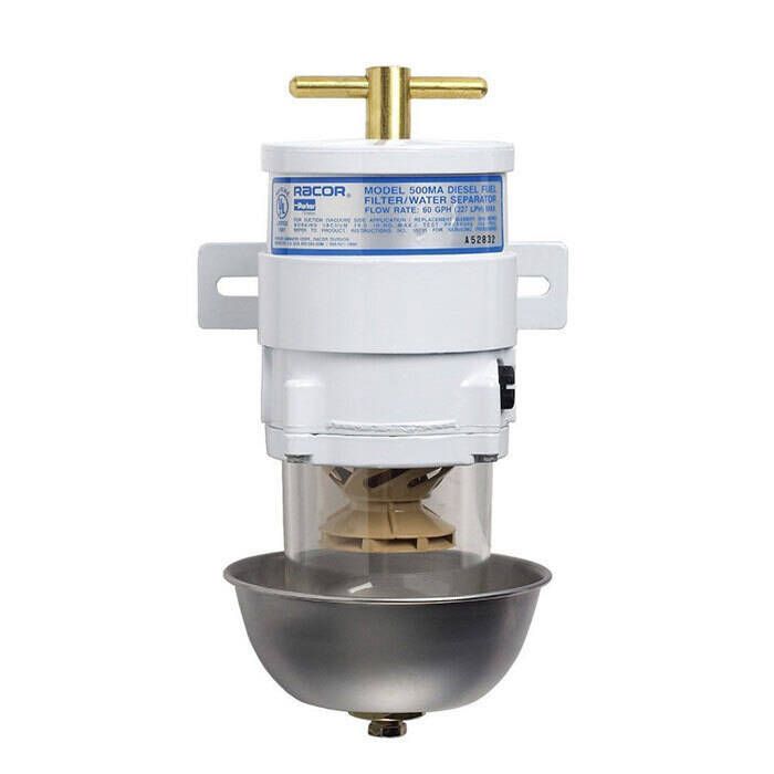

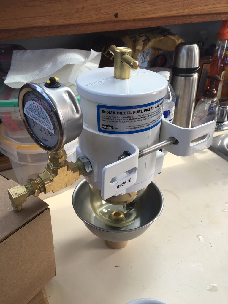

I chose to use a Racor 500MA when I installed a replacement for the original Ford Diesel Motor filter.
It was the only one that met the CG requirement at the time.
It was a great upgrade. Filter changes are simple, cost about $10, and there is no spill of diesel fuel during the process.
Suspect it could work for you.

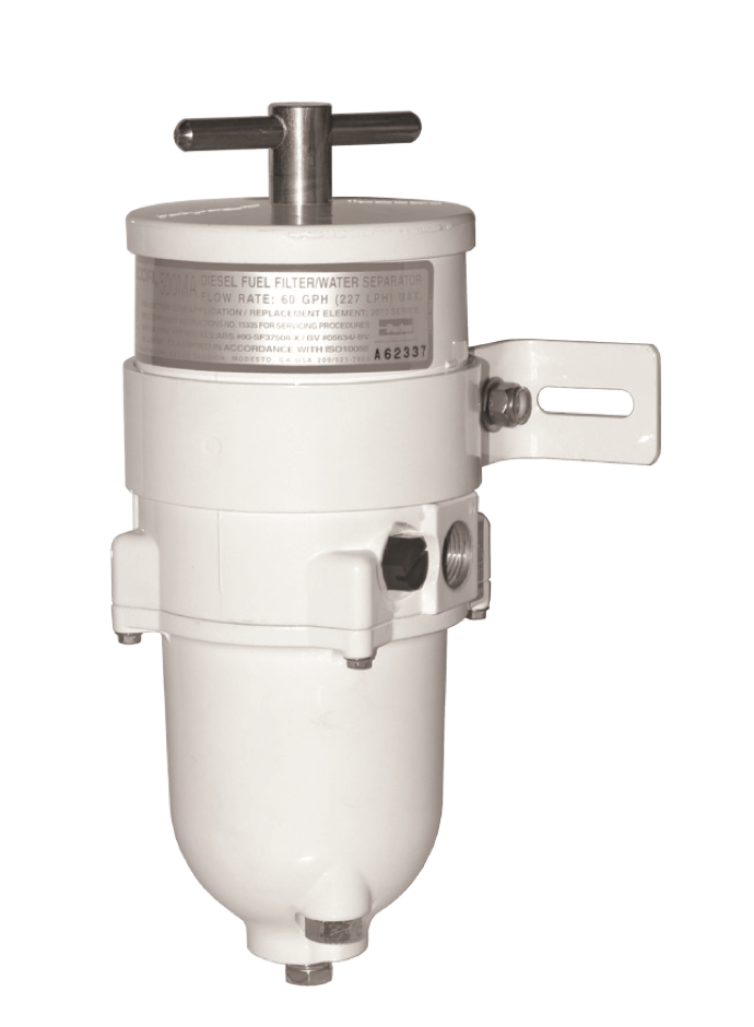

To pile on to the questions, one thing that's not clear to me is if the plastic bowl plus heat shield meets the coast guard requirements in the engine compartment or if a full metal bowl is required. In terms of the Racor 500 series, I think that's the difference between:
500 MA, plastic bowl with heat shield
500 MAM, metal bowl
The 500 MA seems a lot easier to find.

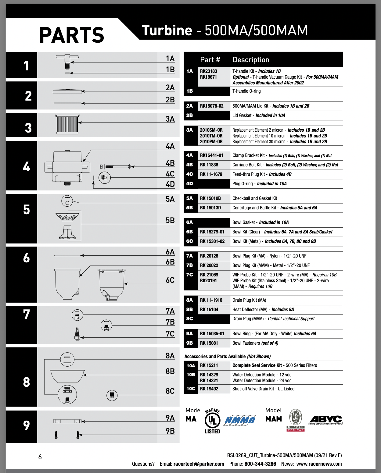

Yes, the 500MA is identified as an approved unit. It is called a "Heat Shield" and reportedly meets the 2.5-minute CG heat test.
The part list for the 500MA is attached. It shows several certifications at the bottom of the page. I have not found data on the Parker site that speaks specifically to the issue.
