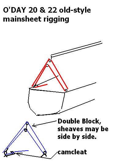

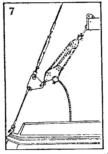

Just got 20 foot daysailer and am having problems rigging the block because it does not seem there is any place to attach it? Have sailed quite a bit but have not seen the proper set up for the Oday. I bought it off of an older gentleman who haddent sailed the boat himself and couldn't really answer any Q's. I would love some pictures. Sorry Im a beginner with Oday.

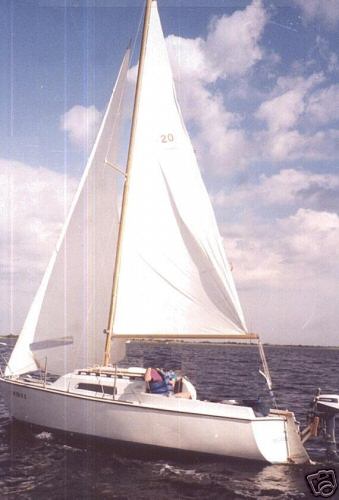

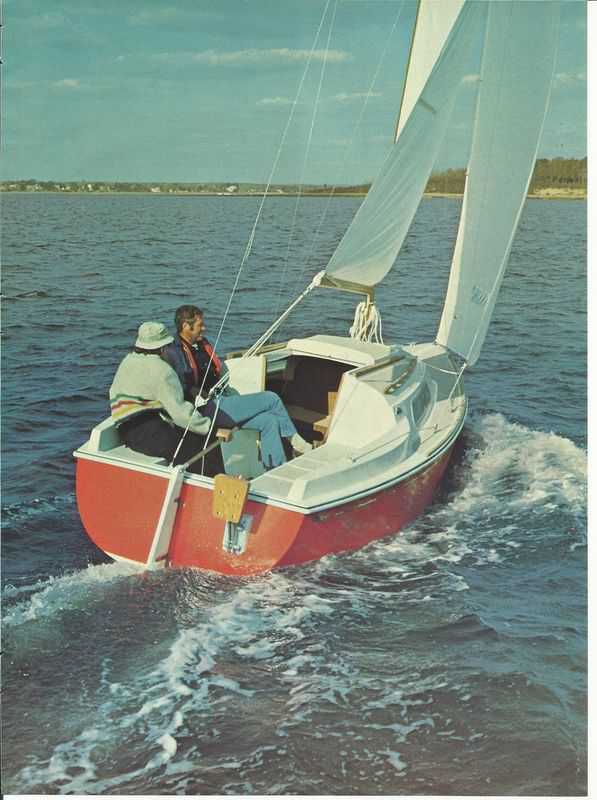

I own the bright yellow Day Sailer II moored off Willow St and would be willing to offer any advice or help I can. I had noticed that there didn't seem to be anywhere to attach the lower block of your mainsheet..... it is possible that there is a piece missing from your backstay, the 20 at that time attached the lower block to a triangle plate about 12" up from the backstay chainplate, and the rest of the backstay attached to the top of that plate. (Theoretically, I'm not actually sure excatly when O'DAY switched to that setup from the original mainsheet rigging that had 2 blocks at the transom corners.) I have posted pics below to help, the O 22 had the same mainsheet rig as the 20, so even though the sketch showing the mainsheet attached to the backstay is actually from the 22 manual, it is still pretty correct.
