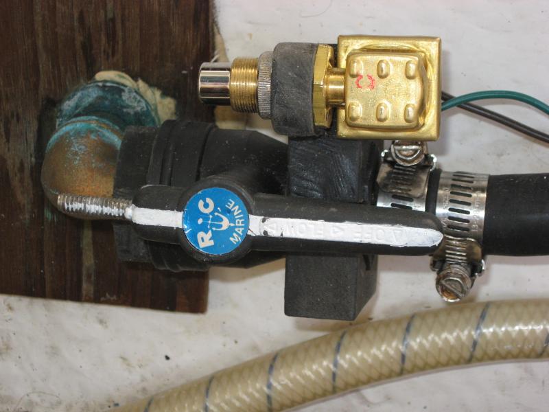

We got different Cherubini Hunter models, but I would expect that the thru-hull types might be the same. All the thru-hulls on my boat look to be original. Bronze with a plywood backing "plates" inside the hull. Not the method of more recent construction, but none of my thru-hulls are leaking. The plywoood is still good. No rot from constant wet. Each time I have hauled, I sand off some of the bottom paint and check that the bronze thru-hull fittings are still yellow (good) and not pink which indicates that the bronze has lost electrons and has become brittle and will most certainly fail at some point. A PO installed Marlon valves on all of the original thru-hulls. Like in the attached picture of my engine's raw water intake. I have felt comfortable with the PO's choice. You should install valves on the sink drain thru-hulls. And close them when not in use. Otherwise any failure of the drain plumbing can sink your boat.
