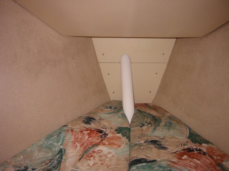

In my case, (1996 H376), it was EITHER a beautiful forecabin OR trouble free anchor handling.
The 2" dia plastic plumbing tube feeds the chain into the centre of the top of the chain locker whereas previously it fed or rather slid down the Vee in the fibreglass of the bow - where it piled up until everything jammed solid.
Now I can lower and raise the anchor single-handed and from the helm position.
Never fails.
See photo. It really does not cause any problems for sleepers in the forward berths.
