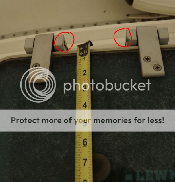

Did you remove the hatch assembly from the frame yet? (Push/knock out the pin that secures the hatch to the frame at the hinge assembly - red circles below ). Once the lid is off, you'll have better access to the screws securing the frame that remains attached to the deck. You can try penetrating oil and then either an impact drill or impact screwdriver (the inexpensive one's from HF can work fine if you're careful). You may want to reinforce the deck from below when using the later depending on how hard you intend on striking it. I wouldn't go crazy as you risk damaging the frame and your deck. If you intend to apply heat, do so through a conduit (screw driver/punch) so it's directly applied to the screw and doesn't dissipate into the deck/gel coat.

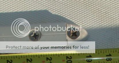

A little thread drift, but our track end caps are secured underneath with a nut (it's a bolt/nut, not a screw). Do you have access to yours from below decks? Ours looks like this from above. If they're stuck it's best done as a 2 person job so you can put more force/torque on the nut and hold the bolt stationary from above. Once I got them free, I can now disassemble/reassemble on my own by using a pair of vice grips below decks with the handle secured against the hull or a bulkhead while I tighten from above (I use butyl tape to bed them).
