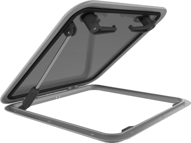

If it is a Lewmar hatch, yes the lid can be removed. There are two plastic covers that need to be removed at the hinges. There are two threaded barrel hinges that need to be loosened. Refer to Lewmar instruction on their website for specific instructions.

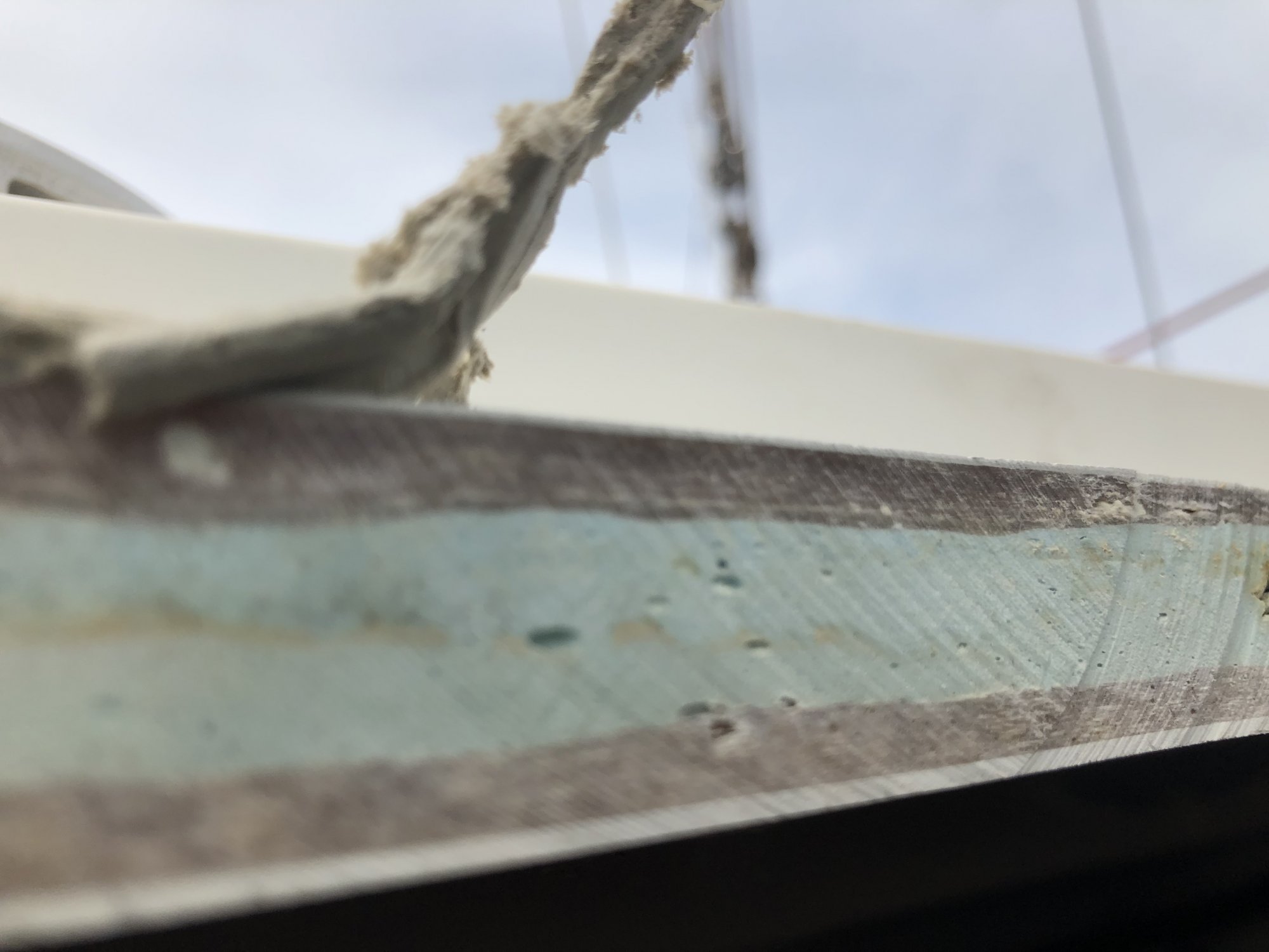

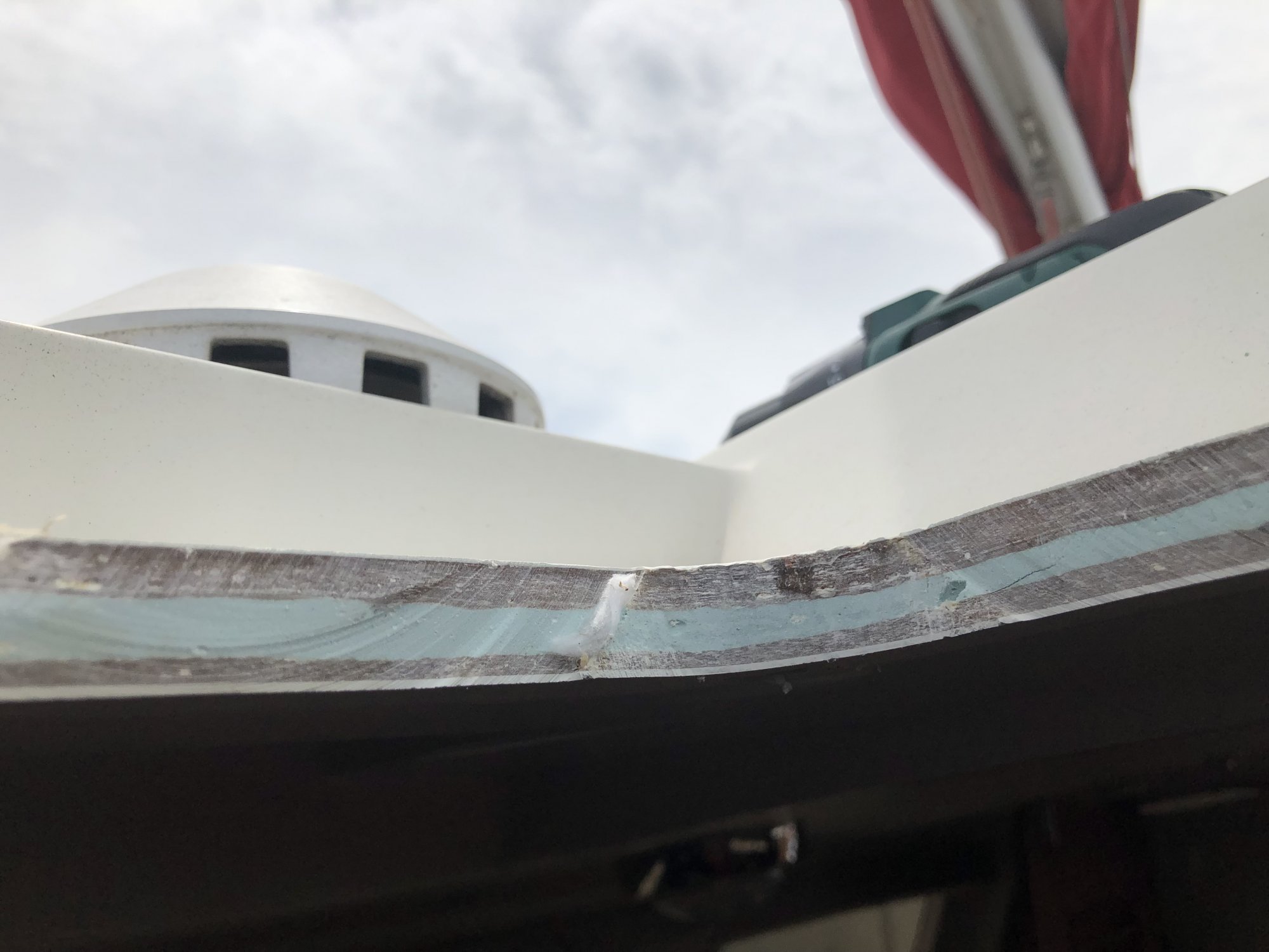

I pulled one of mine (O’Day 322) to rebed it…interesting laminate.

That's pretty typical. The blue stuff is probably Interlux Watertite fairing compound. It serves 2 purposes to close up the gap between the deck and the headliner so water can't get between them and to add some firmness to the deck around the hatch. Similar to the hatch opening in my quarter berth.

Interesting Dave…I assumed that there was some sort of foam board in the laminate (at least around the hatches).
Next time I pull one of the hatches, I will probe around a bit more.
Greg

Another technique some builders used was to put gobs of polyester putty on the headliner before the deck was lowered. This glued the headliner to the deck. Gobs is a very precise quantity. :biggrin:
