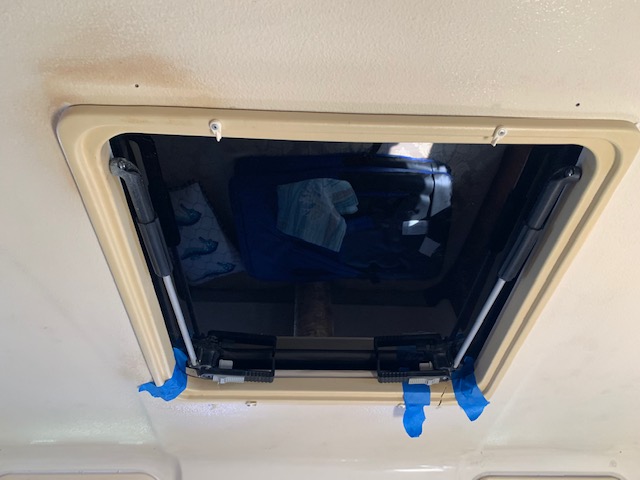

Hi there -
Where can I find replacement "frames" (not sure if this is the proper term) for hatches? I have a '97 Hunter Passage 42. I just replaced my hatch lenses and I now want the interior frames to look good - not the dicolored plastic. I'm also open to custom framing ideas (wood etc). The picture shows my large aft hatch and, due to its old and britle state, it cracked in a couple places as can be seen in the photo.
Thank you!!
John

I took mine off and painted them. They look great. Found some spray can paint that pretty much matched the interior.

Like Sailgunner, I took mine off and painted them with plastic compatible paint. I fixed several cracks using just a bit of Kitty Hair. After painting, they look like new.

Thanks for all the input. I'm going to try to glue (as needed) and paint them. Has anyone painted them brown or a color similar to the wood throughout the boat? Not sure if that wouls look good or not as an accent. Or else just match the headliner shell.
