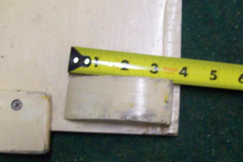

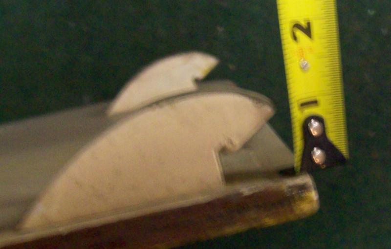

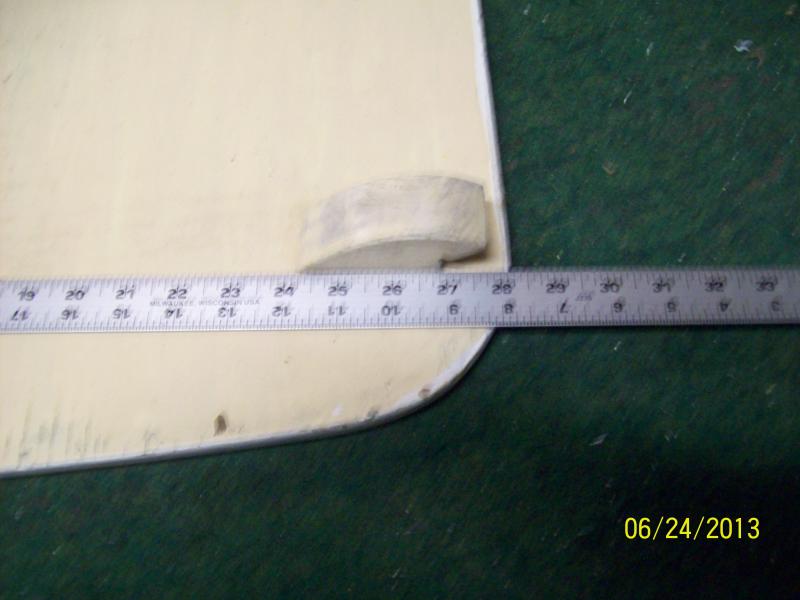

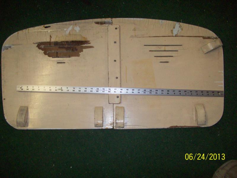

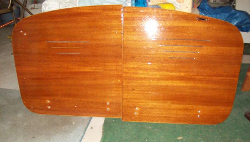

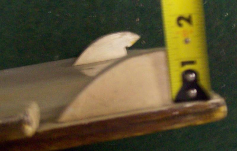

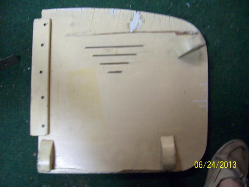

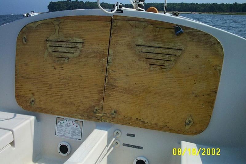

I have pics of the front side (new one purchased from D&R when old ones wore out), can take pics of backside using my old one. The old one was the 1979 original. What year is your DS II? The early model years for the DS II (about 1971-73 or 74) had a smaller opening, but you could adjust size based on your boat (actually, until at least 1973, the opening had a vinyl-coated canvas cover that snapped on.
Anyway...... here are my pics: Unfortunately, they don't really show the slot for the locking tab too well, but I can try to show that with another pic or two if needed.

Thanks for the pictures! Mine is a 1979 model. Until I saw your pictures, I had assumed that it was a one piece unit, but now I can see that it's made in two pieces. Shouldn't be too hard to replicate it based on what you posted. I traced the actual opening size on poster board, so I have the profile of the opening. I'll just enlarge it using the dimensions you provided with your pictures.

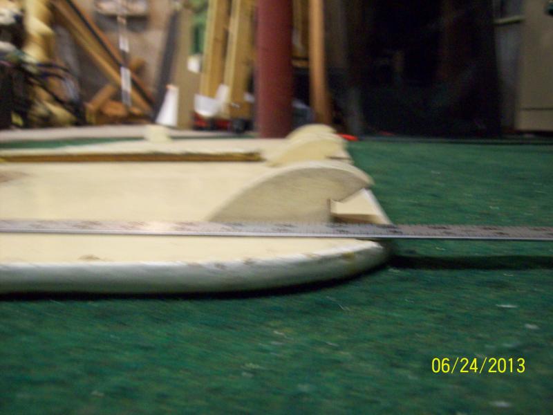

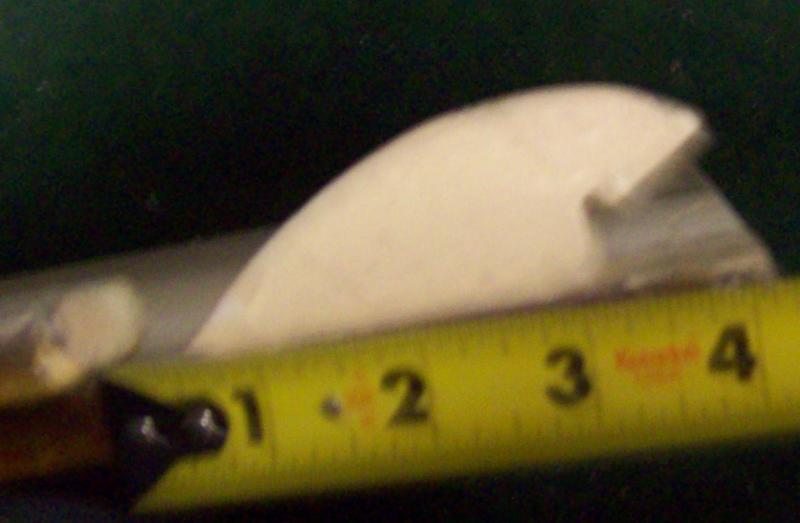

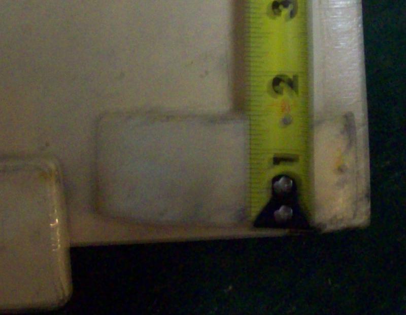

Oday DaySailorII Lake Arthur, PA
Any chance of a pic or two showing the cleats on the backside with the tape measure. It was a bit hard reading the first picture. Thanks!
Hatch Cover Photos
Thank you very much for the pictures. That helps. Hopefully I'll get one built in the next few weeks!

Thanks again! As soon as I get back home, I'll give it a whirl and make up a set of doors based on your pictures and dimensions.
