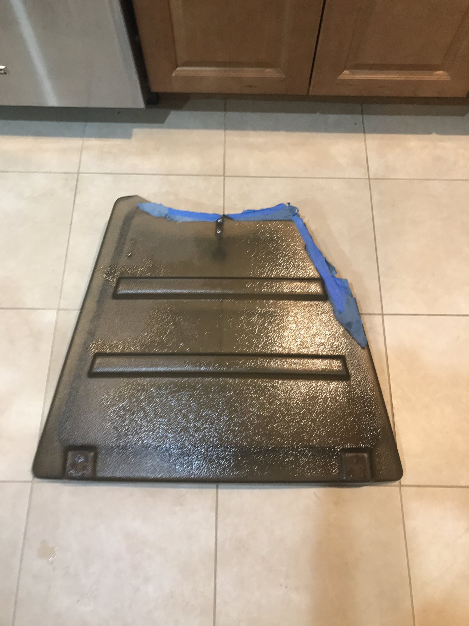

I need to replace the Hatch cover for my 1981 O Day 23 ft. Dimensions are about 26.5 inches across top, 16 inches across the bottom and 21.5 inches from top to bottom in the middle. It is trapezoid shape.

Ralph, I am still having a problems getting this done. Could you tell me where you ordered this acrylic. The local shops in NJ and CT originally said they could do it and then reneged. The hatch I am replacing is the forward hatch in front of the mast. See attached picture—-any suggestions welcome. Thanks
