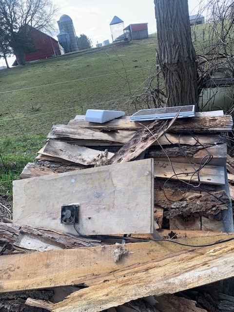

In an effort to keep the dampness to a minimum
And reluctance to put any more holes of any type in the boat , I cane up with I consider a valid alternative. The solar panel will sit over the sliding hatch . The bottom hatch board utilizes a single 12 volt muffin fan .
The fan disconnects easily when removing the hatch boards .
Any suggestions of something I may be overlooking ? This is a standalone unit , not in any way wired to the boats electrical system . Thank you

Why the bottom hatch board and not the top?
I will say this about cabin ventilation, in general: Most folks think only about the intake or the exhaust, but do not put much thought into the entire path of air movement. Air will follow the path of least resistance, so it is pretty easy to direct. As a result, I see a lot of fans installed that really only move a little air right around the fan area.
Assuming you are intending this fan as an exhaust fan, then this creates low pressure just inside around the fan. Where will the air come from to fill this low pressure area? Unless the hatch is pretty airtight, most of that air will be drawn in around the edges or in any vents in the boards. Very little air will move in the rest of the boat.
As far as this exact installation goes, about the only thing I would suggest is to consider putting the fan on the top board to create the potential for a smoother circulation of air in the cabin. And, installing this fan will be MUCH better than not having it. But, without being deliberate about the intake and airflow channeling, it will have limited effectiveness.

Uhm .. thanks ,I think . We heat mostly with wood . There large piles of wood in the back of the yard .
If something goes wrong with a project ,I prefer it to be there ,instead of inside the boat 50 miles away.

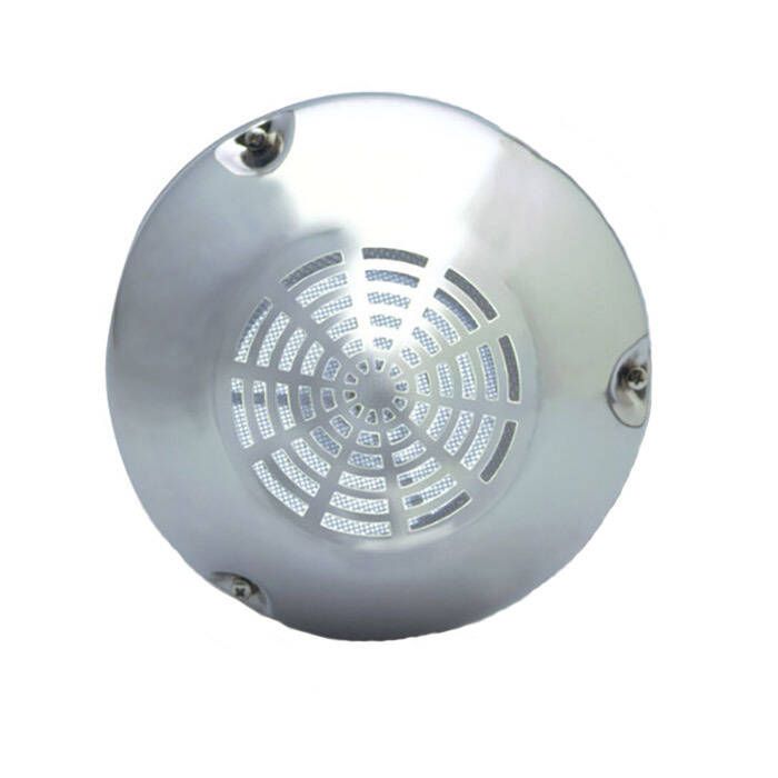

I put in a passive exhaust vent in place of the "circular solar powered exhaust fan" when the battery bit the dust (normal cause of failure). It doesn't move as much air as a fan, but it works year in and year out whenever there is a breeze. Normally, the batteries in the solar fan give up after a year or two. The 1st year, works fine. 2nd year fan only runs when there is direct sun on it. 3rd year, zilch.

This is the "mush
Might I ask, what does your "passive exhaust vent" look like?
Not very different from a mushroom ventilator. Beckson Vent-O-Mate Ventilator. Here is a picture from Defender Marine:
Had to enlarge hole in deck very slightly to replace the solar ventilator. I bought the stainless steel version figuring it would hold up better to the UV, and if stepped on.
