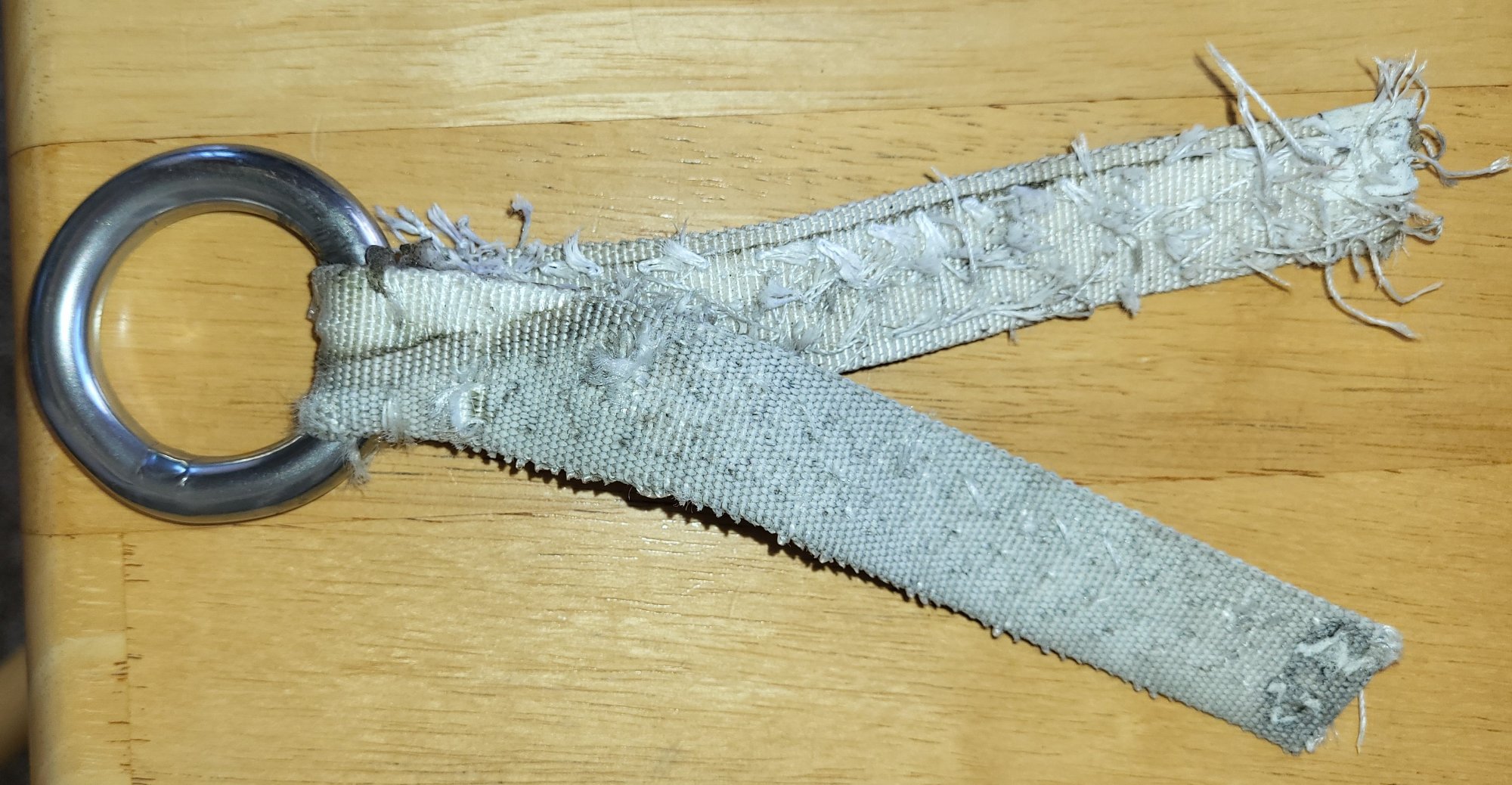

Close reaching through Huntington Flats, returning from Newport Beach in about 16-17 kt apparent wind on Friday, the cringle ripped from the clew of my 120% Genoa which set the headsail flapping "clew-less." We were punching through only 2 to 3 ft "seas" when the thing ripped from the sail. Quite a sudden surprise!:yikes: We continued sailing under mainsail, pinching to weather, until I could get the Genoa furled, but of course I could not get it fully in--a handkerchief remained which got larger as we continued. After that I located the sheets: both lay on deck still attached to the cringle. With diesel assist to keep our distance seaward of the rip-rap lining the channel into Anaheim Bay (which juts out pretty far toward our rhumb into Alamitos Bay), we got into harbor without further difficulty.
But why did this happen:doh:? What I figure is that the threads in the straps holding the cringle to the clew of the sail were sun damaged and parted. This b/c that part of the sail evidently remains exposed when the sail is otherwise fully furled, I believe. Ever seen other evidence that this might be the answer?

That happened to me. The cringle didn't have UV protection fabric over it, as it should have. The sail was otherwise excellently made. The loft that repaired it for me encase the cringle in UV protective fabric so when furled nothing was exposed.

Chain Stitching is my thought. It‘s a technique used by sail makers because it easy and faster. But the results of one stitches becoming unraveled, dry rotted, sun damaged or any number of causes weakens the integrity of the other stitches and they start to pull out. The end result is what you are seeing.
I can’t speak for any sailmaker, but I do know when Ted Hood started his sail making, he was adamant about never using chain stitching. So much so that if he ever saw anyone doing it he would rip out the work and start over.
So if you repair or replace yours make sure your sail maker doesn’t Chain Stitch.

Mine is a UK sail built in 2014. The rest of the sail seems fine. Taking it to our local loft for evaluation tomorrow.

Original thread used may not have been highly UV resistant.
It does not look like a substantial cringle also. Only two straps? I think my foresail has five or 6. Maybe more. It's built ina kind is star pattern, if I'm recalling correctly. With two going up the leech, two going along the foot, and several running in angles between the two.there is also reinforcing fabric in the region. I can't image ending up with something looking like that if it were to part company from the sail.

You may have a point, but there is a starburst pattern of I think 4 straps converging along the clew on each side to the two cringle straps.

Interesting. Next time I unroll my foresail, I'm going to look more closely. I think that ring is captured by more straps. But I could be wrong.
My staysail has a very substantial cringle - but it is also my storm sail so isn't a good comparison. It has a metal plate, not a ring, with several holes to use for connecting sheets.

It's not unusual at all to have the thread fail. Especially on roller furlers where some thread is always exposed. As people have said, often the thread is not as UV resistant. The threads are also subject to chafe and stress. Inspect your sails at lest once a year. You can take them in but is is very easy to do this yourself. Stitching that is about to fail can be fixed pretty easily. Again you can have a shop do it, but is is also pretty easy to do yourself. If you live where winter stops you from sailing, that is an excellent time to inspect and repair your sails. Assuming the admiral will let you sew sails while the rest of the crew watches TV after dinner.

:plus:That’s what the damage appears to be in the image.

I’ve made several sails, here’s a few observations. The underside of the straps are a massive rats nest of bad stitching. The top sides look like nice jig zag stitches but the bottom is a mess.
You see the way the strap angles so one side is along the leech the other along the foot, there should be another strap going the other way so the sail is “sandwiched” between two straps. Then there should be a third strap bisecting the angle of the clew up the middle of the sail.
A clew typically has the sail fabric, five sheets of additional fabric that strengthens the clew, two layers of straps, and a sun cover to sew through. This is nine layers of material so a very hefty sewing machine is required. On top of machine stitching the ring should further be hand stitched with heavy thread using a sewing awl to the sail before adding the straps.
Thread comes in many sizes and materials, some is UV resistant and others not so much. The right thread for the job is also important. V69 polyester thread used on canvas and exposed will last about five years then it tears apart like tissue paper. You can get thread that won’t rot like that but it is very expensive.
Im sure Sailrite has instruction information on assembling the clew, tack etc. check their website for the latest and greatest.
many sailmakers geared towards racing try to minimize weight and thus make things less robust. They assume racing sails will be replaced more often and inspected a lot more. Cruising sailors are more interested in strong and tough and long lasting. It’s important to specify what you want.
