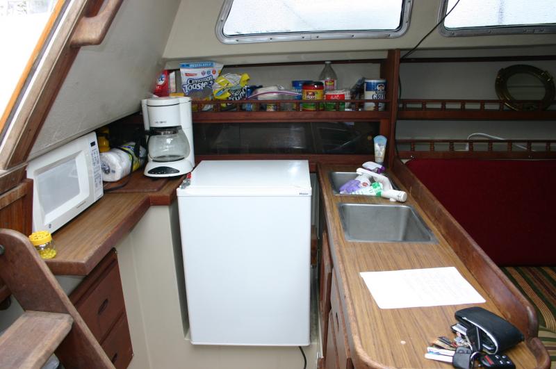

Hello all, I was wondering if anyone else has replaced their original equipment alcohol fired stove-oven unit with a new propane model.
My P.O. had already removed the oven & replaced it with a big refrigerator, which is great except that its 110 volts only. I would like to puchase a new stove for the galley to keep its functionality intact, & relocate the fridge to the right of the Nav. station to get it out of the way. I have seen an inexpensive stove for sale from Bass Pro Shops of all places, that is S.S. & has 2 propane burners & an oven for around $350. This is about half the price of a Seaward or Origo stove that go for around $800. I would have to find a place to install the propane tank as well; presumably on the stern rail. I know that I should also invest in a cold plate 12 volt cooler for the ice box, but that is a project for another day. Any suggestions? Thanks.

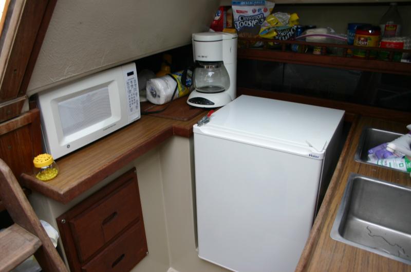

I took the oven out, keeping the stove intact and put a microwave in its place. Works and looks great. I can put pics on if your interested

Thanks for the info Stu. I actually bought a new stern mounted propane grill on sale at WM last fall. My old one decided to loose its lid over the stern along with the burner that it was attached to. Ouch! Its Davy Jone's grill now. I figure that we only grill/cook in the summer months & better to keep all that heat & fumes out of the cabin. Plus I don't have to worry about propane gas migrating to the bilge. I did wind up buying a small microwave & toaster oven (& coffee maker & blender....) tucked away beside the icebox. The C 30 galley has an amazing amount of space, knooks & crannies for storage for a 30 footer. My old S 2 couldn't hold half the stuff the C 30 can. But maybe that's my problem, too much stuff!
