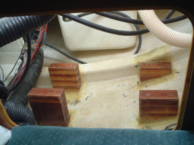

I installed a fresh water Fischer Panda 4Kw in my 3 cabin 411. Do not buy an older saltwater cooled 4Kw. The FP was the only one that would fit. I cut an opening in the stb aft cabin bulkhead, built a bed from glued 2x8s epoxied to the hull. I installed cherry molding around the cut out and the "door" for a tight fit and put insullation on the back of the door. Very quiet and all in all worked very well.I would like to install in my 411 , generator and air conditioning.

Very impressive work - and a job well done. I'm contemplating doing the same thing, but I'm wondering how you got this thing into the hatch area? If you went down and through the aft cabin, how on earth did you get it through the aft cabin door!? I have the 411 2 cabin version, and thinking of doing the same. Again - impressive work - and thanks for the insight.I installed a fresh water Fischer Panda 4Kw in my 3 cabin 411. Do not buy an older saltwater cooled 4Kw. The FP was the only one that would fit. I cut an opening in the stb aft cabin bulkhead, built a bed from glued 2x8s epoxied to the hull. I installed cherry molding around the cut out and the "door" for a tight fit and put insullation on the back of the door. Very quiet and all in all worked very well.
