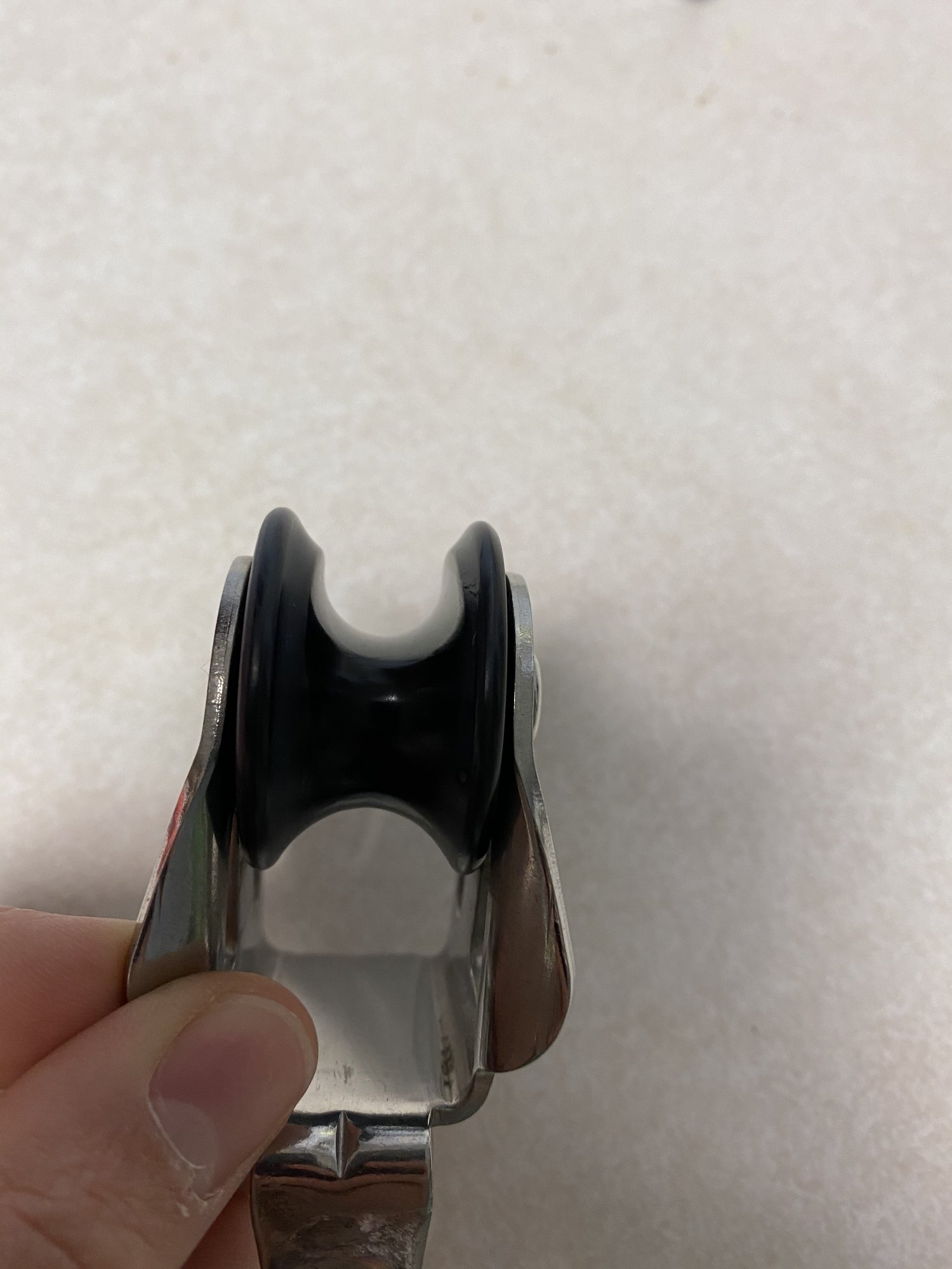

I noticed the other day that the sheave in one of my jib sheet blocks has a flat spot worn into it-
The block is 7 seasons old. Anyone seen anything like this or have any ideas on how to prevent it? Or is it just routine wear? I checked the one on the other side and it feels like it might have a bit of a flat but definitely not as severe as this one.

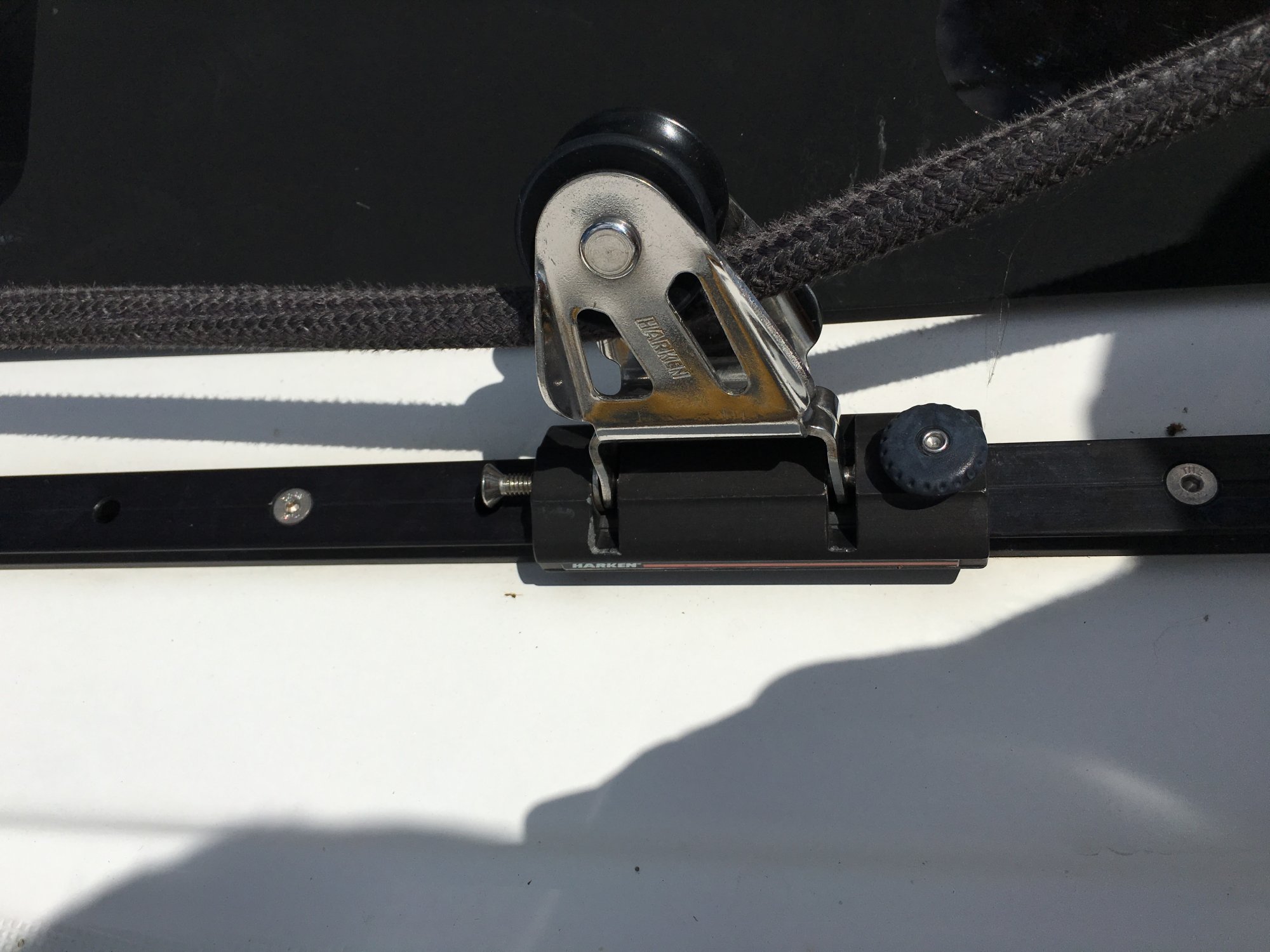

Incidentally, if you have blocks like this do check periodically that the set screw on the back of the base is still tight. On both of ours the screw has worked out over time. Once that happens the pin that holds the block to its base works out, letting the front of the block escape, and bending the flange on the back of the block. Here is what the whole base and block look like (with an improvised replacement set screw on the back) -

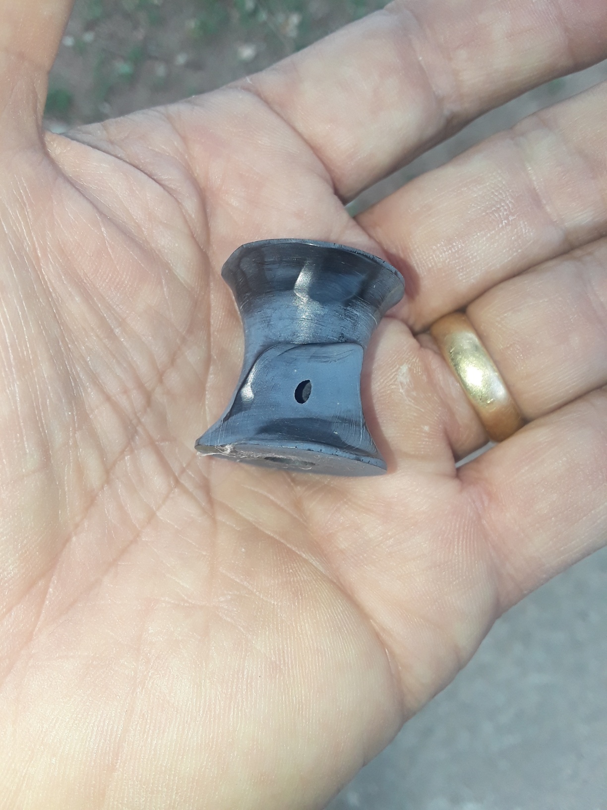

My furler line did the same. In order to make a flat spot, the bearing/bushing must have been stuck.
I suspected salt or other junk kept it from rolling. Now if I could just find a replacement sheave. So far, no luck for me.
I just replaced all of the worn sheaves for my Hood 810 continuous line furler. Got them at Garhauer

Thanks for the ideas. The sheave does spin smoothly when not under load. I have it at home now so I can’t really test it fully loaded. I could try Harken support though to see if they have any suggestions.

It's common wear. Rolling sheaves need to roll, so need to be soft enough to generate friction against the line. So they wear, and flat-spot. High tech lines make it worse. It's becoming more common to see those being replace by low friction ceramic rings.
Nov 8, 2010
11,386
PS - its worse on newer boats with non-overlapping headsails. The angle off the roller is usually much higher and tighter than you see on a big genoa.

My '88 Lewmar wide genoa sheaves experienced that same failure back in the 90's. Rolled easily when not under load, as others have commented. I still recall my unhelpful phone conversation with a Lewmar tech.... he told me that they did have problems with the axel of that series. So I asked about a solution....... and he said I should buy their newer version. :(
I pointed out that this was not much of an endorsement, and he relented and sent me two new ones at their wholesale price.
This is in marked difference to Harken, who rebuilt my mainsheet block system at no charge when some of the ss bent under load.
Looking back at my boat's prior usage in salt water, I imaging that salt crystals had jammed up around the axel. Fresh water environment here, and no recurrence of the problem.

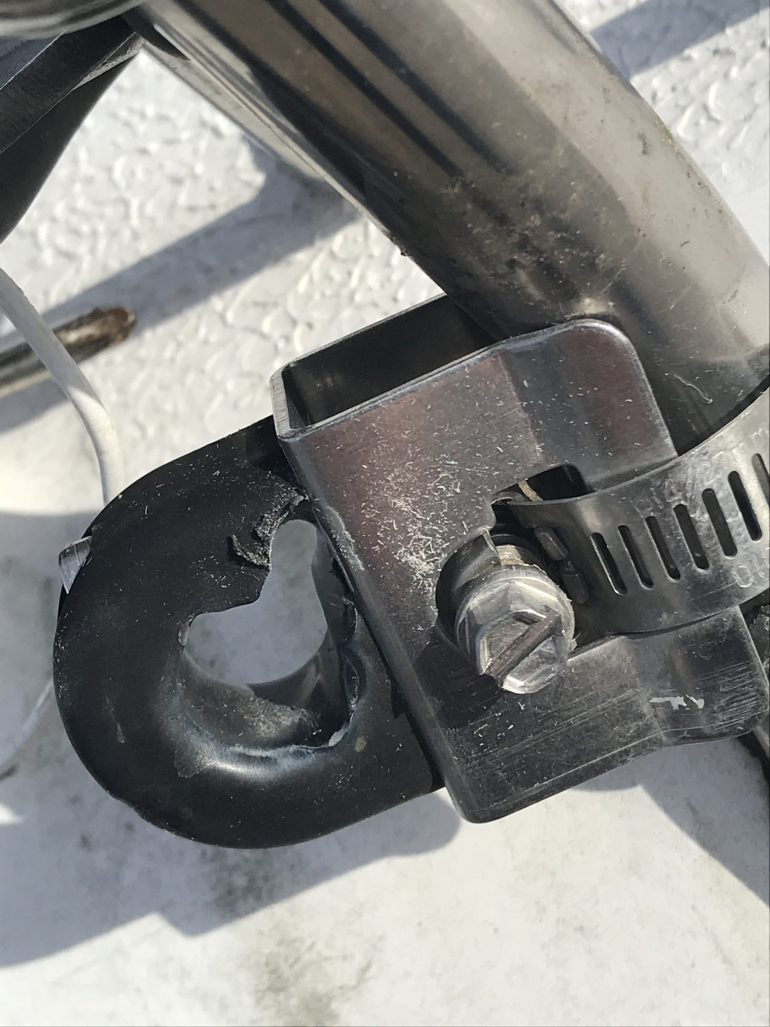

Also happens to fairleads... I replaced all of mine for the furler last season.

Possible I guess. Water where I sail is pretty much all fresh so I don’t think salt is involved. But I don’t really wash the lines other than whatever rinsing they get when the boat is washed. In the case of rgranger’s worn fairlead that makes a lot of sense because the line is meant to slide through the fairlead and causes friction by design. The sheave is meant to spin so there really shouldn’t be any friction involved, until a bit of a flat spot starts and the line slides instead of rolling.
