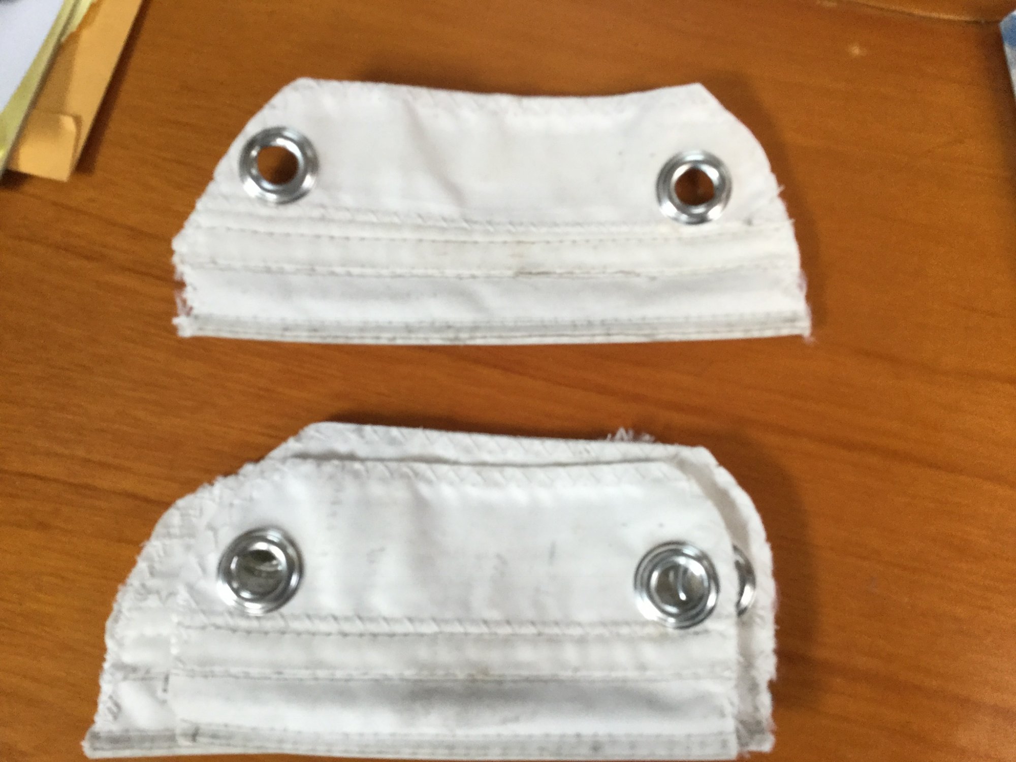

To lubricate my roller furler, I made a few of these from old sail materials. I spray the bolt rope then use lines to run it up and down the slot. Maybe this will help if you modify my design.
