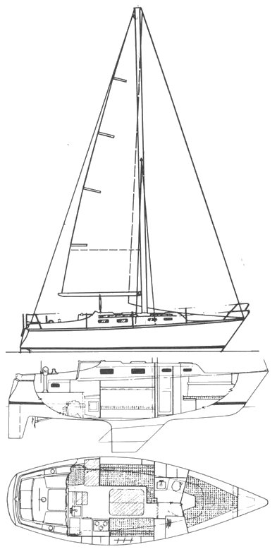

As JBP says you need to go sailing and make some measurements. However that may well lead to a bimini height that is inconveniently low. Ideally you should have close to standing headroom. Some boats have a two step height, with the higher portion aft of the boom end (depends, of course, on your sailplan and cockpit relationship) Alternately the boom end position may deterimine the fore-and-aft dimension of your bimini.
From the drawing below the helm might have adequate shelter if the entire bimini was aft of the boom end. (In Florida I imagine you're after shade rather than rain protection...) YMMV and it also will depend on whether or not you want to connect to a dodger.
