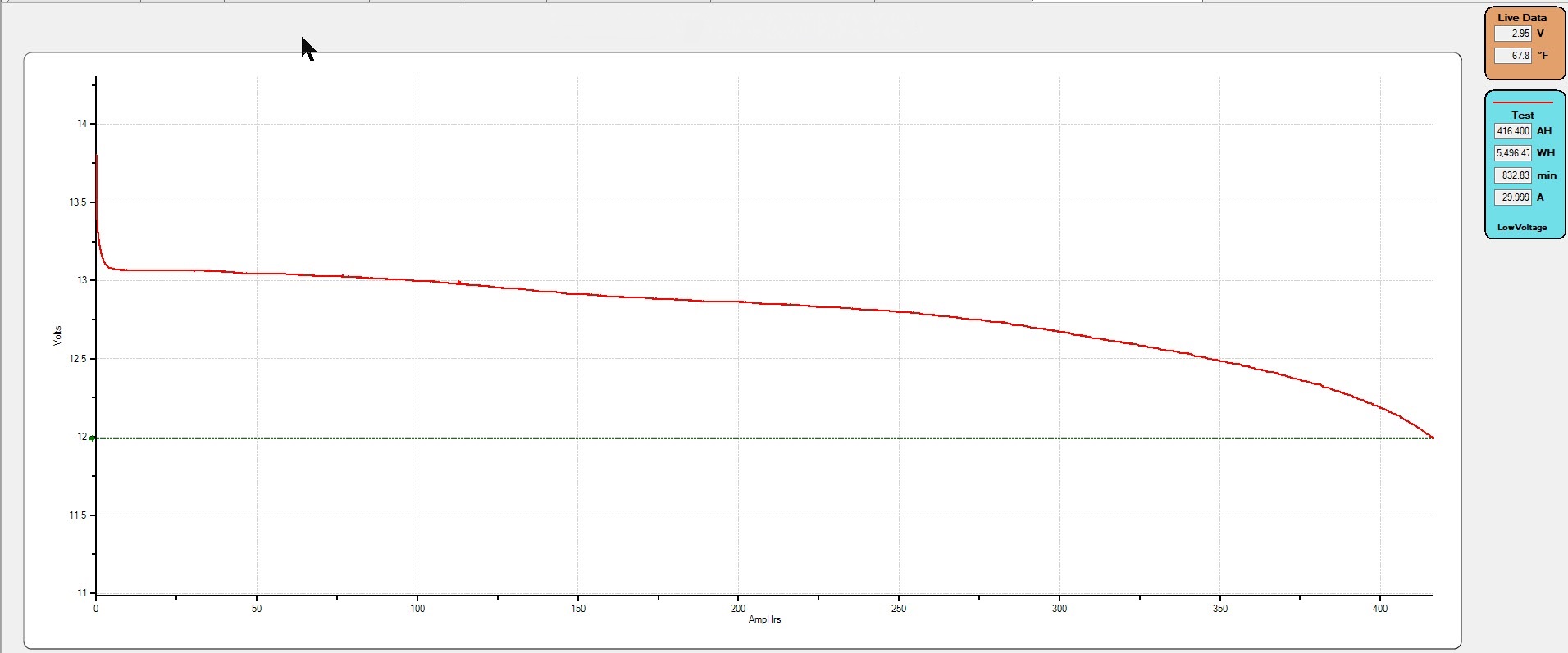

For my own banks charging I decided on 13.8V @ roughly a .4C charge rate with a 30 minute absorption and no float. The primary charge source for this bank has been the alternator and a Balmar MC 614 regulator. While we had plenty of solar solar it remained off most of the time. We used this bank with just 30 minutes of engine runtime a day. This is pretty easy in Maine with the light winds we have in the summer. Doing all the charging from the alternator worked out perfectly. If we needed to stay at anchor for more than three days I would simply flip on the solar array just to slow the discharge. The original charge regime I set up for this bank back in 2009 has worked amazingly well. Today the battery has over 2300 cycles on it with almost every cycle going to at least 80% depth of discharge purposely. As of the last discharge capacity test the bank could still deliver the full 400 amp hours of capacity (Technically a little bit over). So, for those who say LiFePo4 hasn't been around long enough to see how long it actually lasts, I'd say 13 years & 2300+ cycles is pretty good data so I am personally sold.
Cycle 2000 capacity test 416Ah

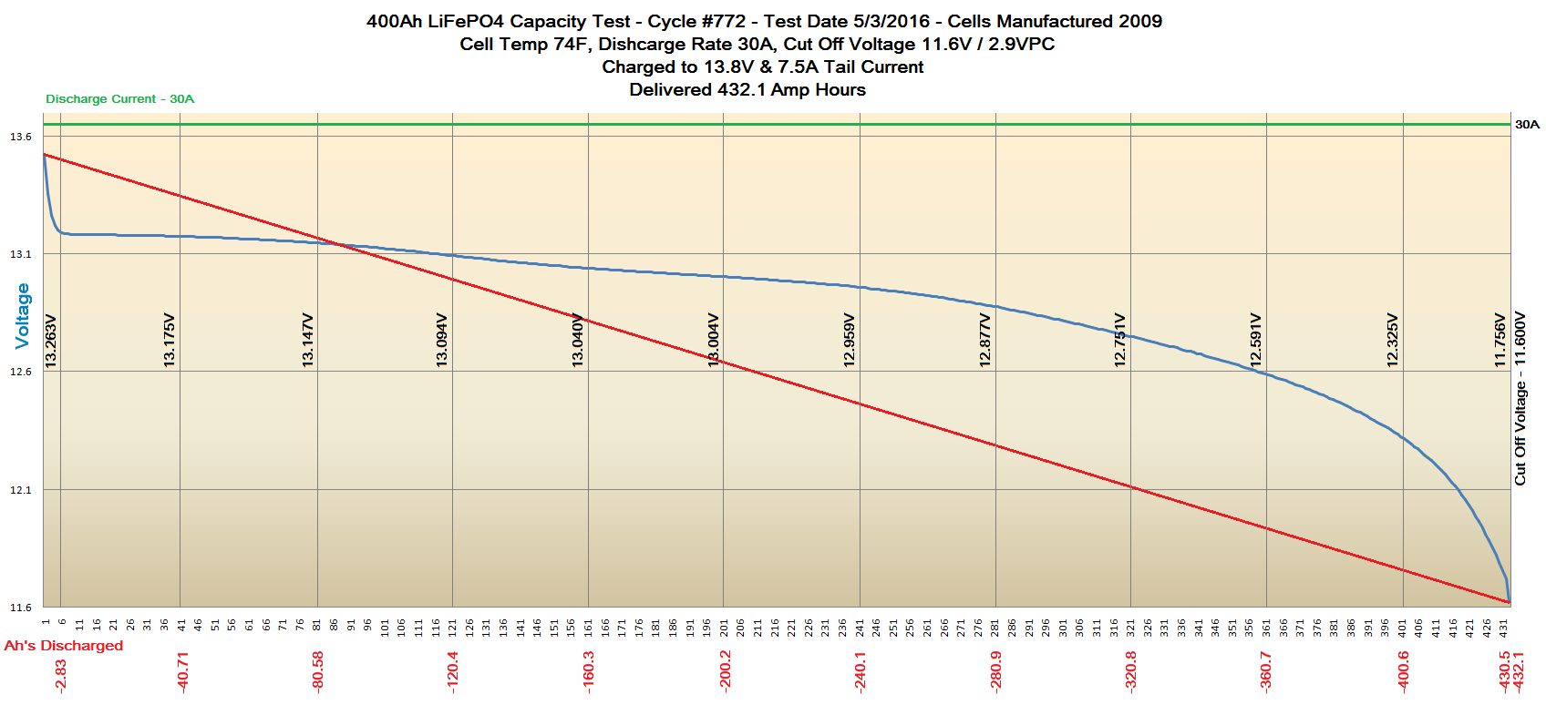

I still don't fully grasp the charging characteristics of LFP. I assume that you designed this charge regimen to avoid harming the bank, while putting a good deal of energy into them. I thought that LFP cells didn't turn the corner until about 3.6V/cell, or 14.4V for a 12V pack. If you hold acceptance at 13.8V, 3.45V/cell, won't they stop charging when the cell comes up to that voltage, which could be about 85% SOC? That's fine, just trying to wrap my head around this.
I assumed you could do all of your charing in bulk mode, and that the smart charger would go to accept mode at the set point, say 13.8V, and then almost immediate go to float since the charging current would be below 2%C. And I further thought one would keep the float voltage at nearly that level so that while the engine's running you don't discharge the bank.

You thought incorrectly..here is a capacity test from cycle #772. Note the charge voltage and tail current cut off... Drop in makers push the 14.4V to 14.6V narrative because their BMS usually does not begin to balance until 3.6VPC. This is why I like Kilovault...They begin to balance at 3.5VPC..I cover all this in my drop in article...The bottom line is that an LFP cell can charge to 100% SoC at just a hair over 3.4V
