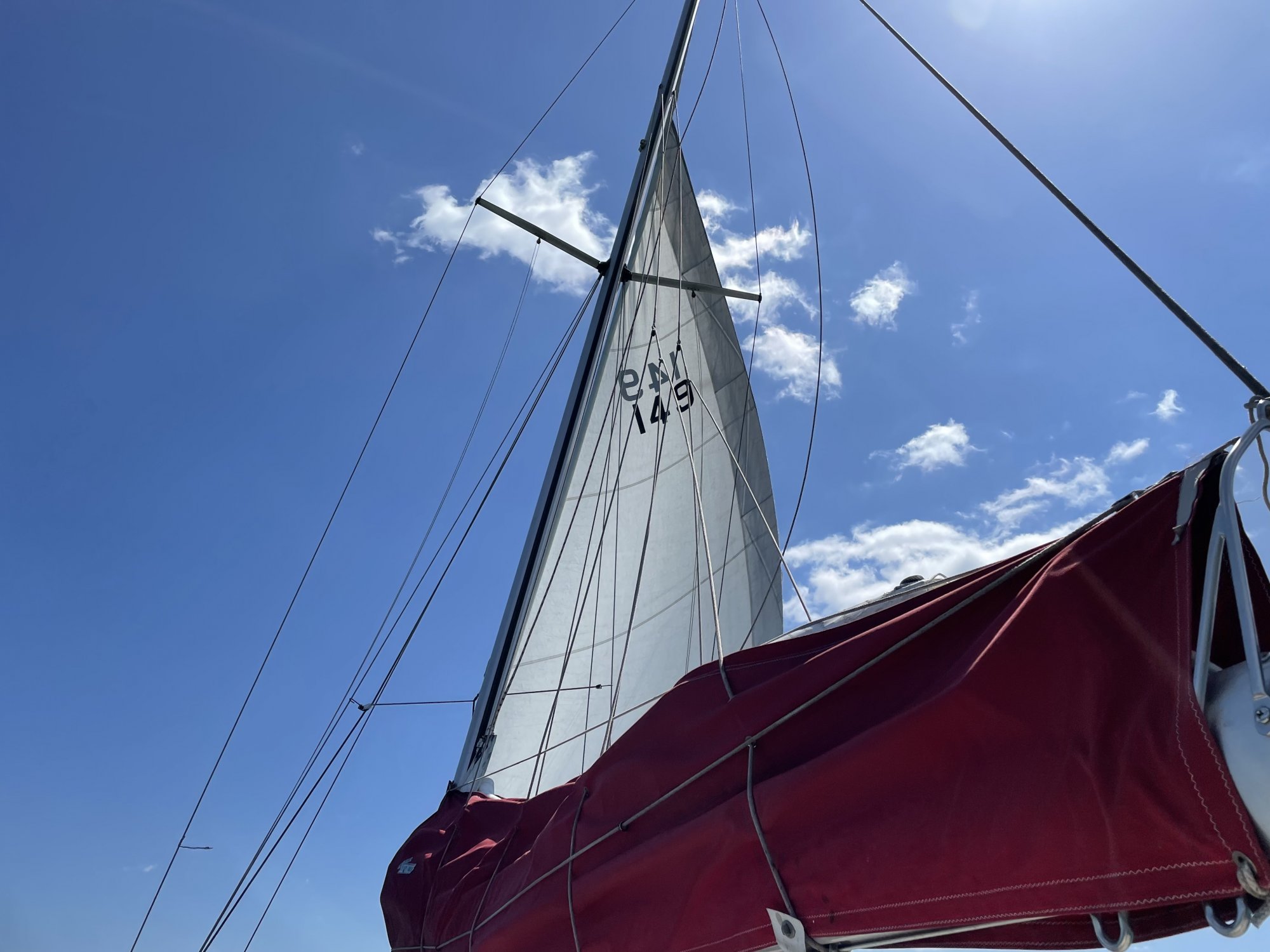

I think hank on gives you more options (if you have the sail inventory). But a furler gives you alot of adjustment in size, without the time (and hassle) of changing head sails.
I fly a genoa on a furler, with 2 distinct reef point markers, but can make almost infinite adjustments to the sail size but rolling it or letting it out.
i bent the sails on my O’Day 322 Tally Ho today, and shook out the sails (well, the head sail at least). Lots of wind, made 6.4 knots with 2 reefs in the jib…
For full disclosure, I will say I have never sailed without a furler.
