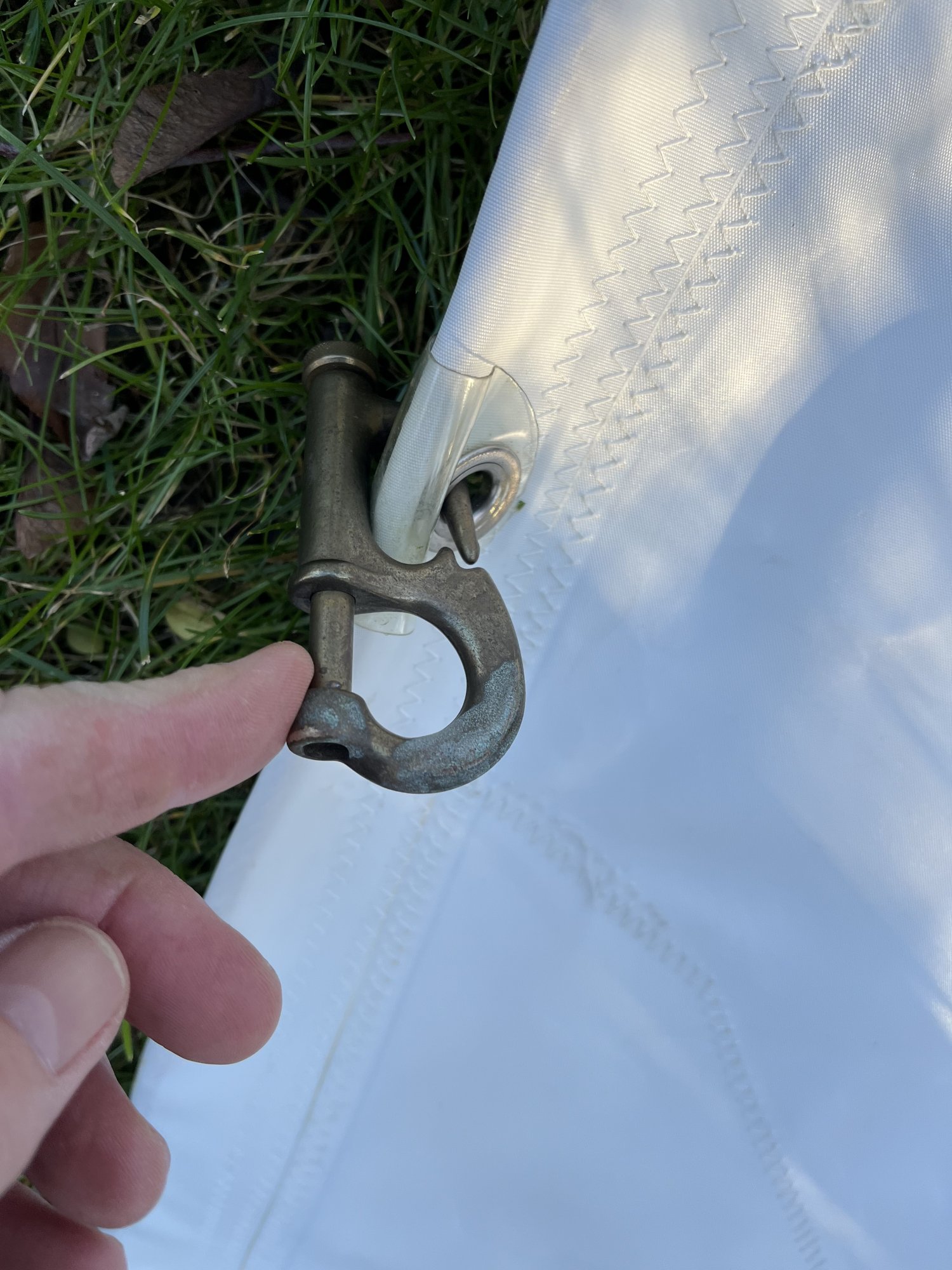

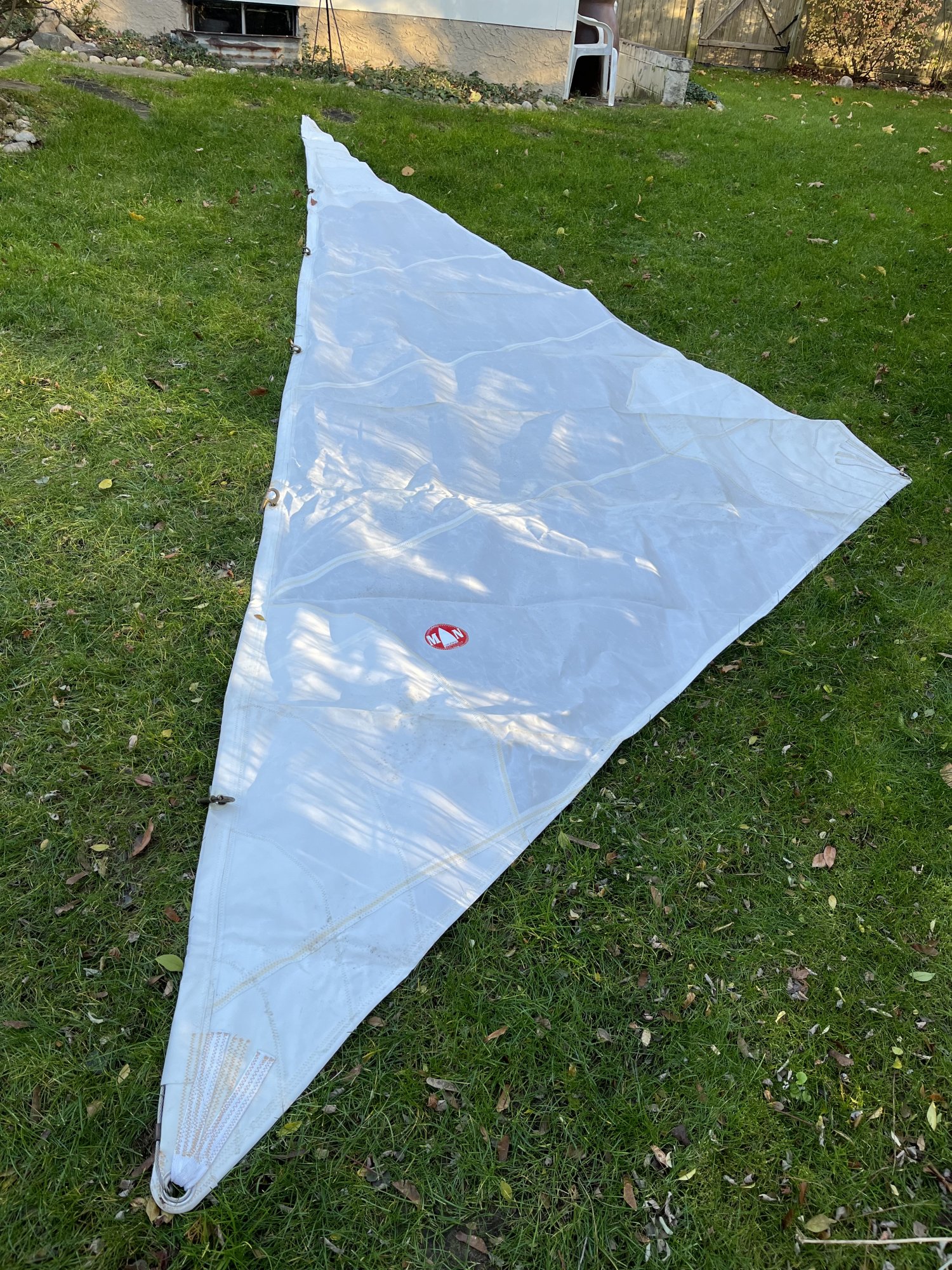

So going through all my stuff this off season and came across a long forgotten Hank on storm jib from a previous boat. Was trying to figure how to rig so I can hank on “over” the in place furled jib.
Thought about making amstele soft shackles with plastic balls to attached or a reinforced with webbing “sheet” that would act as a sleeve. Figure if the storm sail is being pulled up there will be a lot of wind and pressure…… don’t want to damage the furled jib.
Any suggestions / input?
thanks

I would think a long sleeve made from Dacron or Nylon cloth might work, whatever diameter would easily fit around your jib and as long the leech of the sail. It would essentially be a long rectangle with grommets along the long edges. Once wrapped around the furled foresail, you would use your soft shackles to attach each luff grommet through the grommets on the sleeve.
If you want to use the hanks just run a short loop of rope through the sleeve grommets.

That's what I was thinking too. If you think your storm jib needs the support of a stay along the luff, perhaps a sailmaker can add a reinforced bolt rope.

That’s what I’m thinking would work best….

That is how the ATN storm jib is set up…Hank over the furled headsail.
But I do wonder how hard it would be to raise it, in a storm.

That’s it…… maybe ask my sailmaker for a piece and have the wife do some sewing.
I recently sewed a dousing sock for my new drifter with our household sewing machine (thanks to the tutelage of my lovely and patient wife). Looking at the construction of the Gail Sail system, it definitely looks like a job for a sailmaker or someone with a heavy-duty sewing machine and the skill and knowledge to use it.
