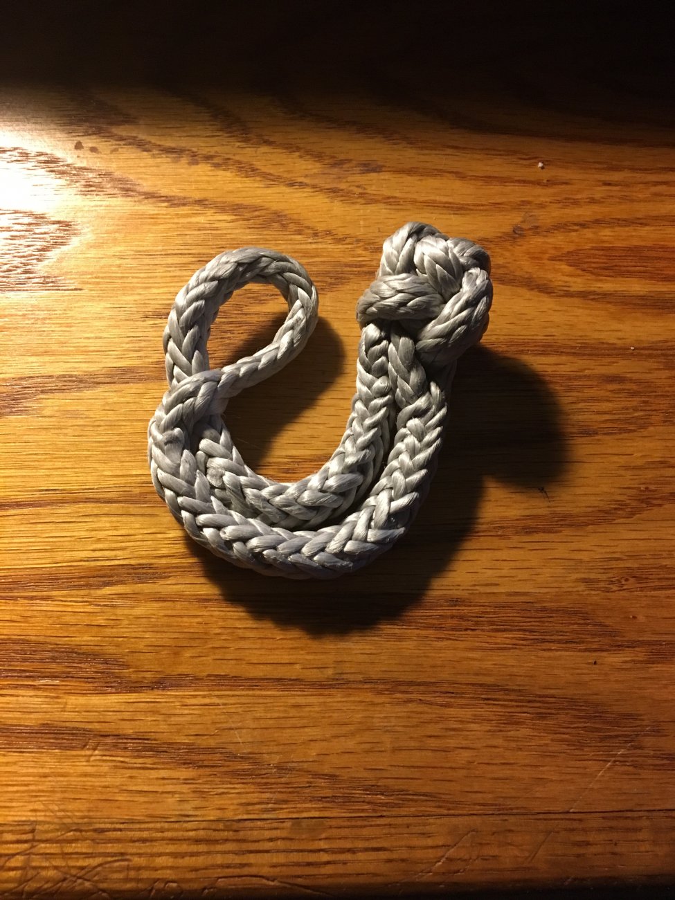

First I favor a “soft shackle”
to a carabiner or snap shackle. When I go forward to reef a jib it usually when the wind is blowing. As the jib is loosened it starts to flog about, whipping the clew about. That chunk of metal whipping about always scares me. The soft shackle is much easier on my hands. It is just as quick to change as a snap shackle and quicker than a carabiner.
Drop the jib to the reef point tie off the tack, switch the sheet to the reef clew, tighten the sail halyard. Then head back to the cockpit.

Soft shackles. You don't want a big metal carabiner clip flogging around on a foredeck even if no one is up there. On the last boat I sailed on that had jib hanks, we would hank on the jib and run sheets. Even on that 23' boat the various jibs had different leads so they would have needed to be re -led anyway. The skipper wouldn't have left his sheets out in the Sun. If you do, you need UV resistant covers. Most furling sheets live in the Sun 24/7.

I'll be using sailbags attached to the forward life lines and pulpit for easier stowing. I like the soft shackle. Will get a bunch of them. I'm sure I''l loose a few while I gain experience. Thanks everyone for your input.

I had hank on sails on my previous boat. I used a large snap shackle to attach my sheets to the sail. I got bopped once or twice by it and today I would definitely use a soft shackle. I have made many of them of different sizes. There are plenty of resources on the web on how to make them. Definitely easier than using individual sets of sheets for each sail.
It is not difficult to learn to make them. The line cost is $2-5 depending on the line you use ( I prefer dyneema) plus maybe 90 minutes of your time to learn to tie the first one. The diameter of the dyneema will determine the strength. A finished soft shackle can exceed the breaking strength of a metal snap shackle that can cost hundreds of dollars.
I have posted a youtube link of instructions to make your own a couple of times here on SBO. If interested and can find it, PM me and I’ll send it to you.
