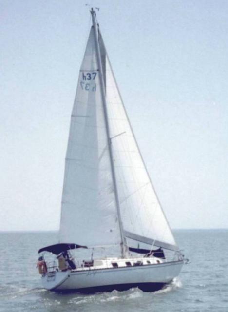

But Mark, the staysail is hanked on number one and a bear to flake number two. Then you have to cover it. I would much rather just unfurl/furl. Not to mention that my staysail is original and only of use when sheeted in real tight.
P.S. - just noticing in the photo how small that slot is. Looking at the front of the staysail cover to the headstay, that's a pretty small gap to tack the oversize yankee through. Yet I don't have a problem with it.

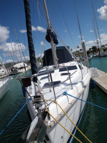

I found a picture!
Greetings!
In an earlier post on this thread RichH asked if I happened to have a picture of the inner stay. I've attached a picture that show the attachement point of the inner stay on the deck behind the anchor locker.
Now what I thought was the tensioner for the stay is most likely the quick disconnect in what RichH described. For those of you having a look at the attached picture--please let me know if you think that this deduction is correct?
I'm learning all the time--aren't we all, but it never occured to me to just unhook the stay and sail without it. I can also check the owner's manual to see if that stay was on the original rigging chart. The boat didn't come with a staysail or the hardware to haul it up on the stay.

Jimlay - from your pic it looks like you have a Hyfield lever - detachable stay connection. If so just detach the forestay and tie it, etc. to a cap shroud, etc. when sailing 'normal'. When you need the staysail instead of the jib/genoa because you cant roll/furl a genoa much beyond 30% area reduction and have any 'good' sail shape, simply dowse/furl the jib/genoa, reconnnect the forestay/staysail ... and youll be 'good-to-go'.
