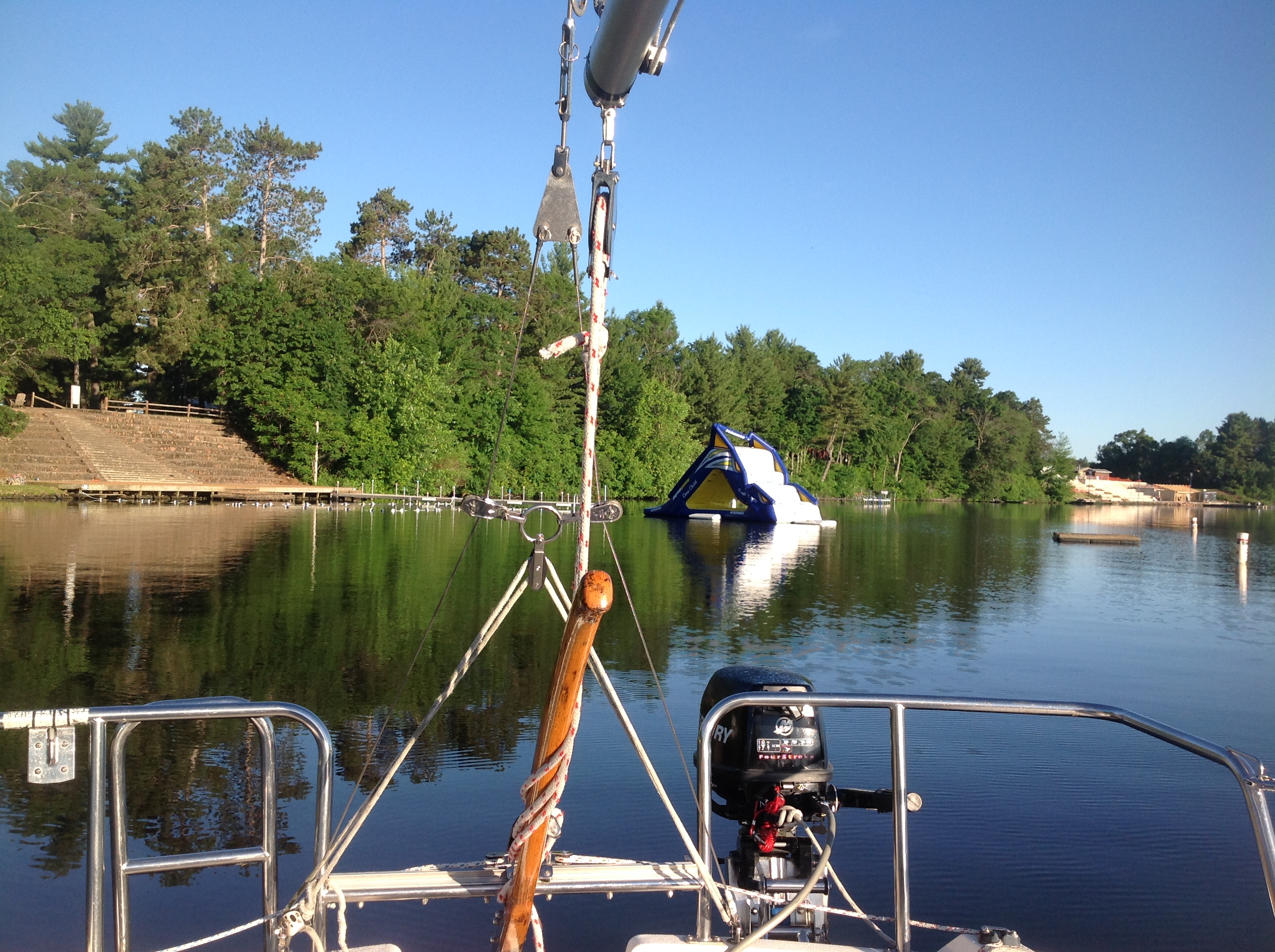

Wow my head almost hurts.
Thanks fellas for the explanation I think I understand both of your arguments and I now understand the rake vs bend so much better. This is why I like this forum lots of people smarter than I am from whom I can glean great information.
Now for something to encourage us toward spring and illustrate the almost page of the thread now devoted to the backstay! To the OP, with time we all improve and heal can be managed through a variety of factors. Don't give up or become overwhelmed just Learn all you can and go sailing!
