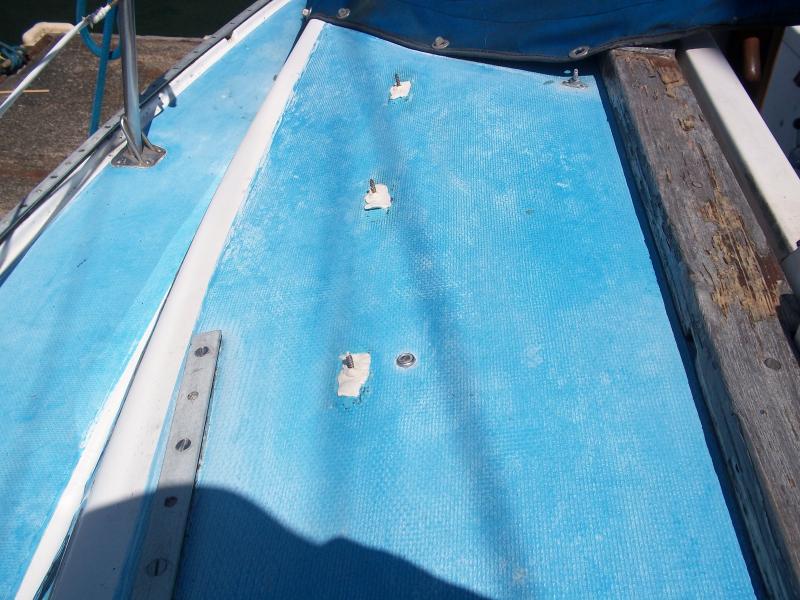

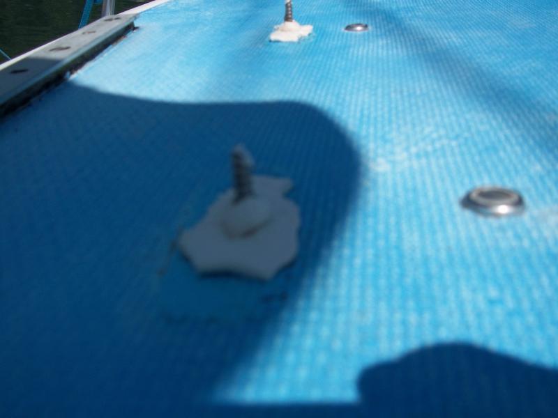

I rebedded my exterior handholds. I used
the butyl tape and countersunk the screw
holes. I tightened the screws over 3 days.
I hope this stops some inscrutible drips that
seemed to come from nowhere.
