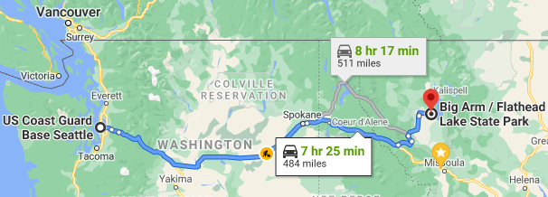

DSC is a really nice feature, press the button and everybody including the coast guard knows you are in trouble and knows exactly where you are. That is beyond the basic feature set but isn't that expensive. How warm is the water you sail in?
Apr 3, 2020
191
Hunter 23.5 Frenchtown, MT
Right now, about 72 degrees water temp. Funny that you mention the Coast Guard. IF they hear the call, it's gonna take them a long time to get there. :)
