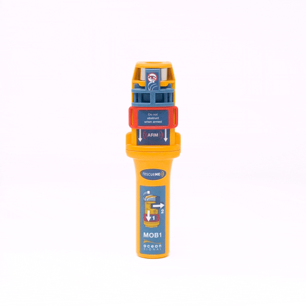

A better choice is a MOBI, it sends out an AIS signal with the location and can send a DSC message back to the mothership, so the crew can find you.
If you opt for a VHF instead, it should have DSC and GPS to make it easier for someone to find you.

The device I referenced earlier, Ocean Signal MOB1 sends a DSC emergency signal and GPS location to the mother ship's VHF which sets off a loud alarm and transmits an emergency AIS signal to all boats within the reception area (about a 5 mile radius) with the GPS coordinates.
Ocean Signal also has device that sends a SARSAT signal and an AIS signal but not a DCS back to the mothership.
Clearly the MOB1 device has advantages over the DSC handheld (such as battery life and possible automatic activation) but at the risk of asking someone else to do my research, what is the difference between the range of a handheld DSC signal from just above the water's surface to the range of an MOB1 AIS signal (assuming the same receiving antenna height)? Aren't they both VHF signals subject to the same limitations?
13,451
Yes, they both broadcast in the VHF range, however, transmitting data is more efficient than transmitting voice. Additionally the MOB1 is designed to have the antenna more or less vertical while floating in an inflatable, the handheld requires a conscious effort to hold the antenna vertical. The AIS signal will continue to broadcast until the battery runs out or it is shut off. The DCS signal only broadcasts until someone aknowledges (I think.) The MOB1 will work if the COB is unconscious or otherwise impaired.
