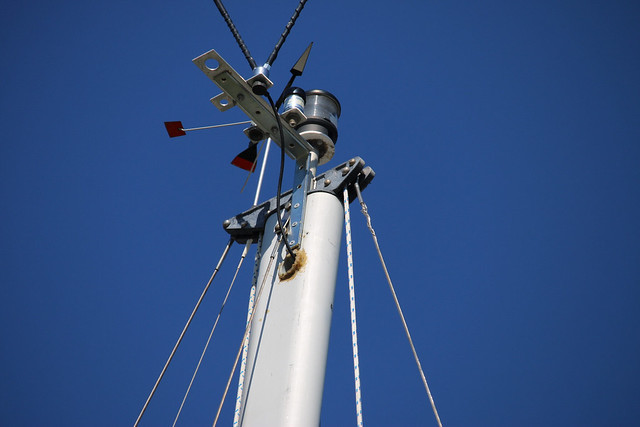

I was taking my sails off today. Ran into a problem taking the genoa down. It was a little windy(boat facing north and wind out of the south at the slip). It unfurled fine and then would not unfurl the last few feet. Fortunately I was able to refurl it and secure the sail. I looked up and it appears that the halyard is wrapped once around the furler and the sail is down about 4 to 6 inches from the usual position in the furling track. I am thinking I may have eased the the tension on the halyard some and created some slack while unfurling. Here is my question, I am thinking I can by hand while looking up rotate the furler and furled sail to release the wrap and then pull the halyard back up? Does that sound workable? Any suggestions welcome.

You may need 3 hands to do all of the task. Things I would keep an eye on
  • Make sure my backstay (if you have one) is snug. Slack Backstay equals relaxed forestay.
  • Snug up halyard and try to recover those 4-6 inches. That is unless the sail is already fully raised. Then the 4-6 inches is just normal
  • With the sail wrapped on the furler extrusion and the sheets removed, I would try to rotate the furler extrusion and unwrap the halyard, taking up halyard slack as it unwinds. This will allow the sail to just rotate with the furler.
  • Once halyard is free I would unwrap the jib/genoa from the furler and drop the sail by releasing the halyard and pulling the sail down.
A Halyard wrap happens. Not to get worked up about. Also not to be just left there. Too easy to forget it and then get in real trouble.

Once you get jib down you may want to install a halyard restrainer.
