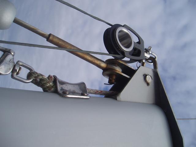

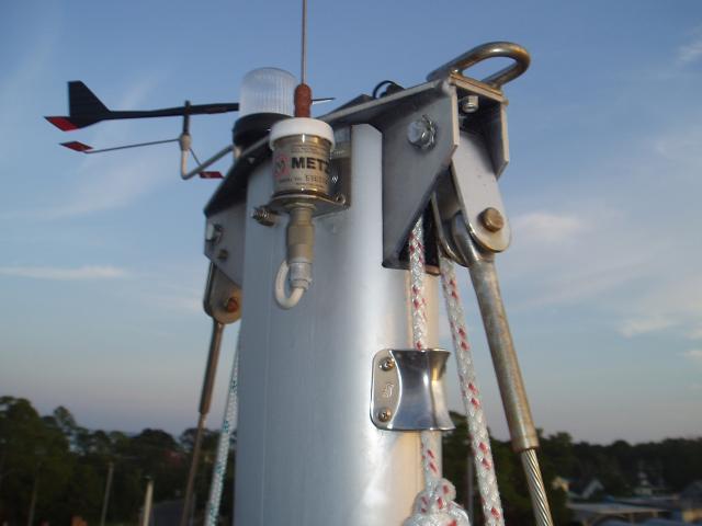

Jun 2, 2004
36
Catalina 310 Fort Walton Beach, FL
Retainer Photos
I have attached a couple of pictures showing the halyard retainer. It shortens the effective luff available by a wee bit but does prevent the furler from wrapping the halyard.
