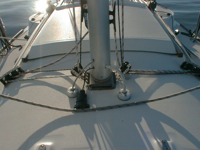

Jun 4, 2004
273
Oday 25 Alameda
Harken Bullet Blocks attached to an organizer plate from Dwyer Mast. The Oday25 uses a DM-500 profile mast extrusion
