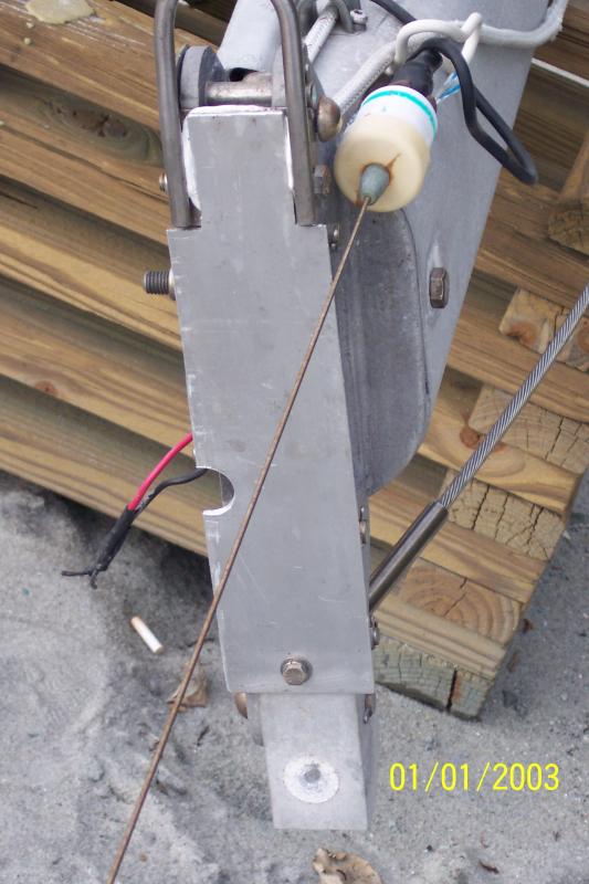

Speaking of this, I had a scare I found myself in. I used my Top Climber 4 times one weekend doing steaming light changeout, spreader boots & Windex/antenna changeout a few years back. On my 4th. trip up, I discovered that my cast aluminum crane had a vertical full top-to-bottom crack along where one sheave shaft 1/4 to 5/16"" dia. was attached w/cotter pin.
There I was, almost 50 feet up & my crane had failed. Oh let me tell ya, it was a scary trip back down. After dropping the mast, I discovered the shaft had also bent. Now, I only weigh in @ 150# & yet, my crane had failed. Could this cause me to fall, I don't know. Was there a chance of this happening?

My story here in thinking, here's what I thought could have happened to me with the cracked crane.
The initial crack happened at the front sheave. What if the crane now being stressed, developed the same type of crack along the rear sheave? Remember this is cast aluminum, not the strongest material against structural failure.
With external halyards, had the whole side failed, there was a distinct possibility of the halyard rolling off the sheaves & now nothing to stop the rope from falling to the deck, with me attached.

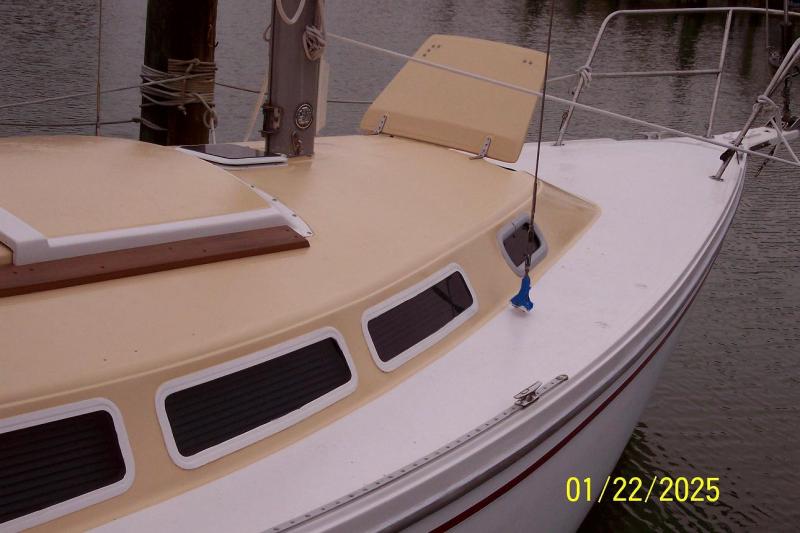

I did my own new crane install while my mast was down at the boatyard. I cut a removable top plate to cover the open top crane & screwed down. To ensure my halyard stayed in the sheaves, I epoxied a PVC filler piece to the underside of the cover. I used a thickness that left a 3/16" gap between the sheave & the PVC. This will stop the halyard from jumping the sheave.
I now have minimal rainwater intrusion to my mast base. I also redid my wiring penetrations at the mast base, added air venting & deck draining to ensure no intrusion to the coring.
Here are some pics of the top plate & mast base to give you an idea. Sorry, but no pics of the PVC spacer piece underneath. Two pics of the cover & one pic that shows a circular vent on the mast. I have another on the opposite side to allow for rainwater drying. This is the same principle of those large concrete cooling towers with steam coming out the tops. They remove vapor using pressure differences & suction created by air moving across the tops. My crane cover is not a full seal thus the effect is the same. I remove the vent fitting from time to time for checking any water buildup inside the mast base. It's always dry.
