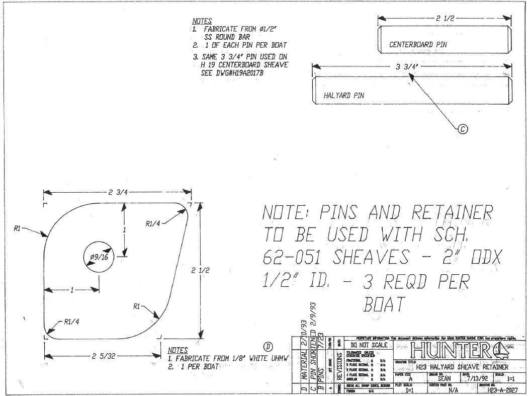

I looked for common materials for my H26 sheave separators. You know the cheap white resin plastic patio chairs they sell at "dollar stores" (e.g., Dollar General)? I was too cheap to buy one of those chairs for $8. So I bought the small table for $5. From that, I cut the flat top surface off into several triangles that are somewhat rounded at the points to form triangular- type ovals, similar to giant guitar picks . I cut about 5 of these from one table top. That was 5 years ago, and the first one is still holding up. BrianW

The one I ordered from SBO arrived today.... I'm slightly disappointing. It is just a square piece of plastic, not much larger than a credit card. It is not even pre-drilled. I can easily mark it ... go to the shop and drill out the hole... but for $30 why am I doing all of that. The most time sensitive part is getting all of the tools out... once I've done that, I might as well make my own.
I've ordered several things from SBO and so far this is the only time I've not been super happy with the service.... so I guess I'm okay with it in the grand scheme of things.... but...:cool:

Suggest you trace the part, scan it and post on this forum! BrianW
13,054
This gives you everything you need.
Scotty 147 already posted a schematic. I'll have no trouble getting it to work. I'll just have to do a bit of work... which is what I thought my $30 was buying. :confused:
