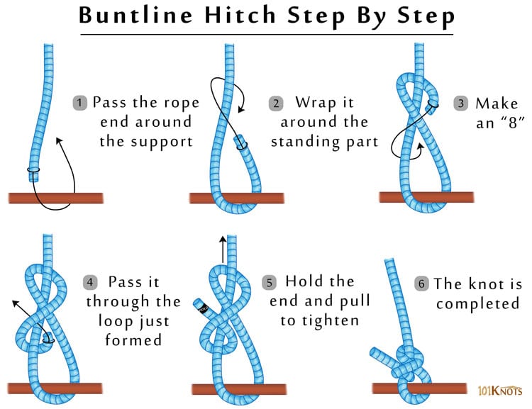

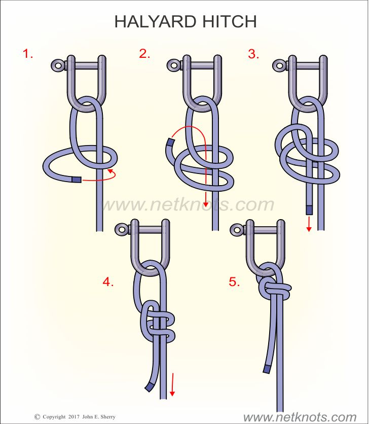

There's actually a knot for tying the line to the shackle, the "halyard hitch".... but if you want to go without a shackle, as many sailors do nowadays, Charlie Jones' buntline hitch recommendation is excellent.

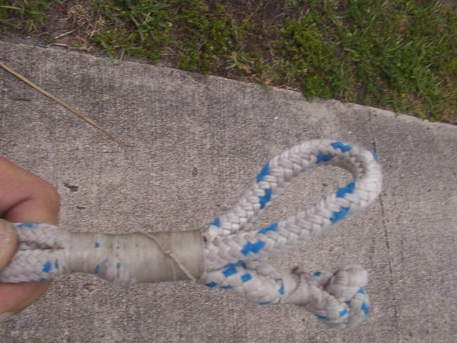

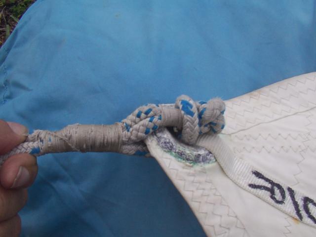

Here is an article about tying an integral soft shackle knot similar to what @Charlie Jones s/v Tehani uses on his sheets but with a cinching eye loop.
Integral Halyard Soft Shackle
Looks pretty easy to use. Would still need to explain it to a lubber, but then you'ld want to check the shackle was snapped or screwed on all the way, if a non sailor were doing it for you, anyway.
