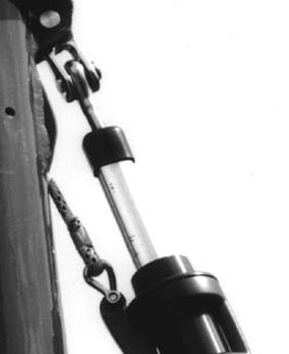

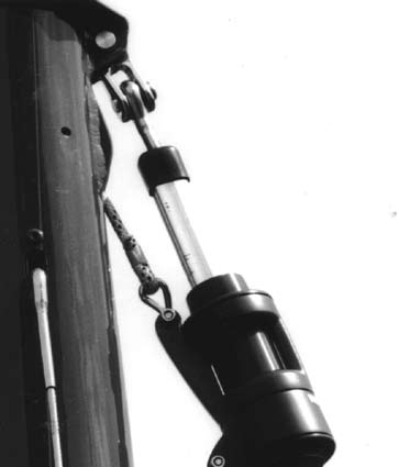

To prevent wraps, the halyard must exert a slight pull to the rear.
1. Halyard swivel should be within top 4" (100mm) of foil unless a halyard restrainer is used.
2. Halyard must pull slightly to rear (8 - 10°).
3. Halyard must be snug, but not too tight.
