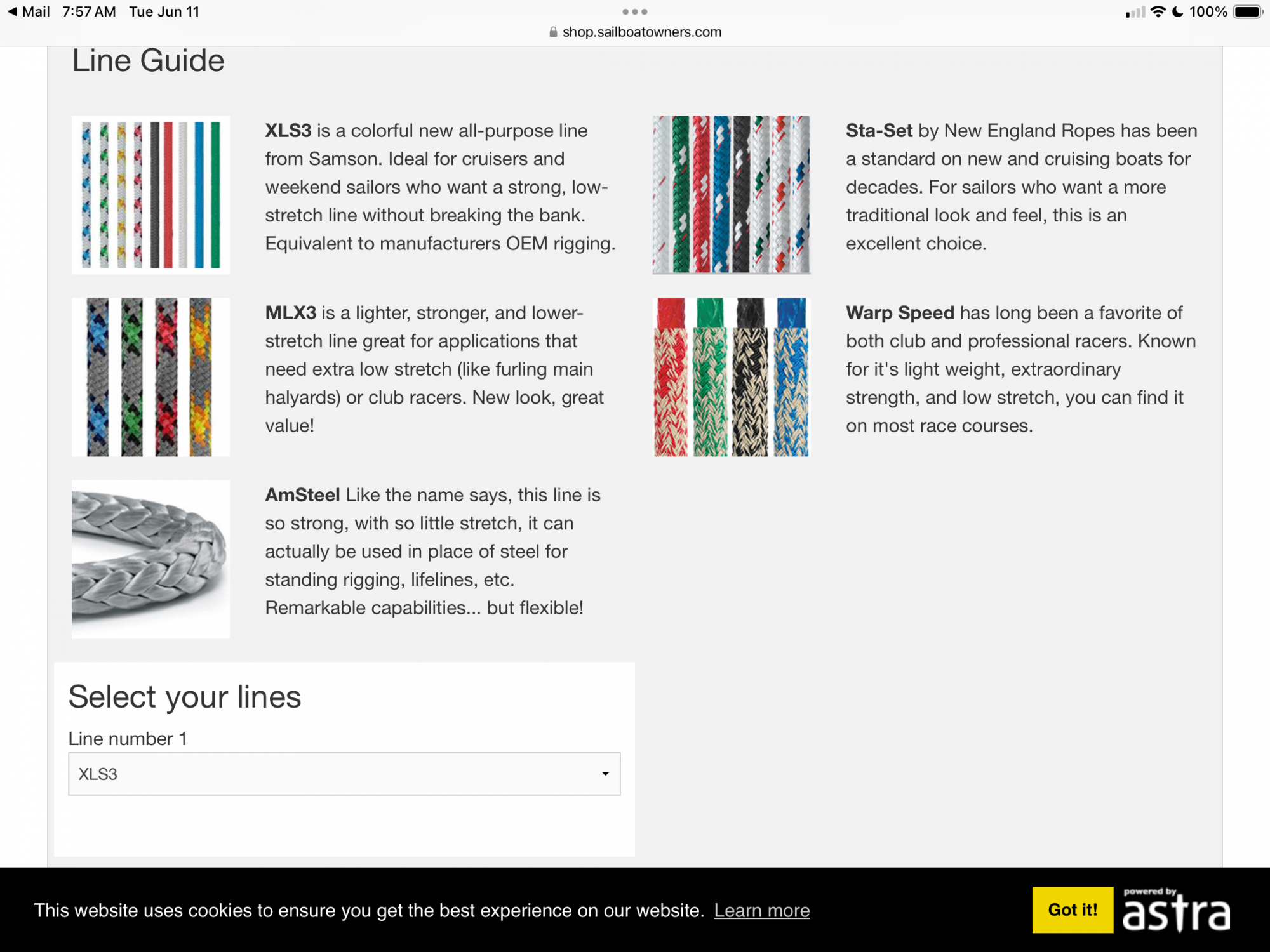

I am currently leaning towards Sta-set line. Seems like a decent quality for cost. Agree that higher quality would be better but have to stay on budget :) Any thoughts on the sta-set line?
8,115
It’s OK. Don’t go to Stay Set X. It is too stiff and doesn’t go around blocks easily. It adds friction. We’re assuming you raise and lower halyards for each sail. If that’s not the case, then there might be another Rx.
