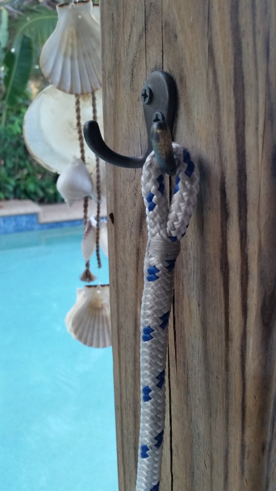

Pictures of halyard being installed in 2014

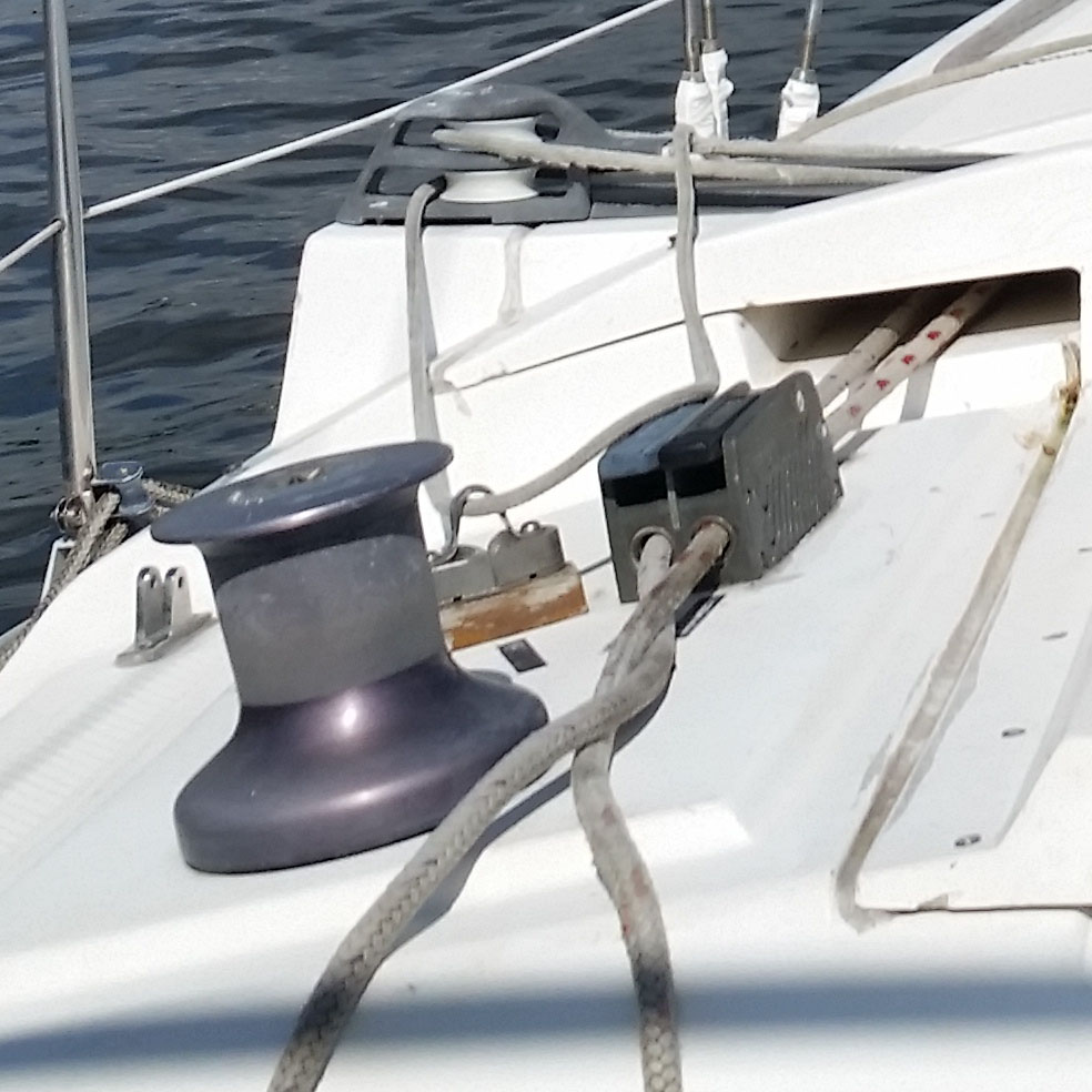

Spinlock clutches on the port side showing old jib halyard and old main sheet. both of those lines have been replaced, and main sheet is now rerouted to a triple with cam on the traveler: Pair of identical clutches on starboard side are Main halyard, and down-haul.

@pateco ... Chip.. That is a great looking halyard splice.;)
3 and 1/2 year old line should be still working. The request was:

What are your thoughts about the clutches? The image appears to show some age, and that some aged (perhaps line with accumulated salt/dirt) line has been run through the clutch at some point in time.

I can't take credit for the splice. It was done by the resident expert at Sailorman when I bought the halyard.LOL.
Their line is sourced locally from Miami Cordage It seems to have held up well.
