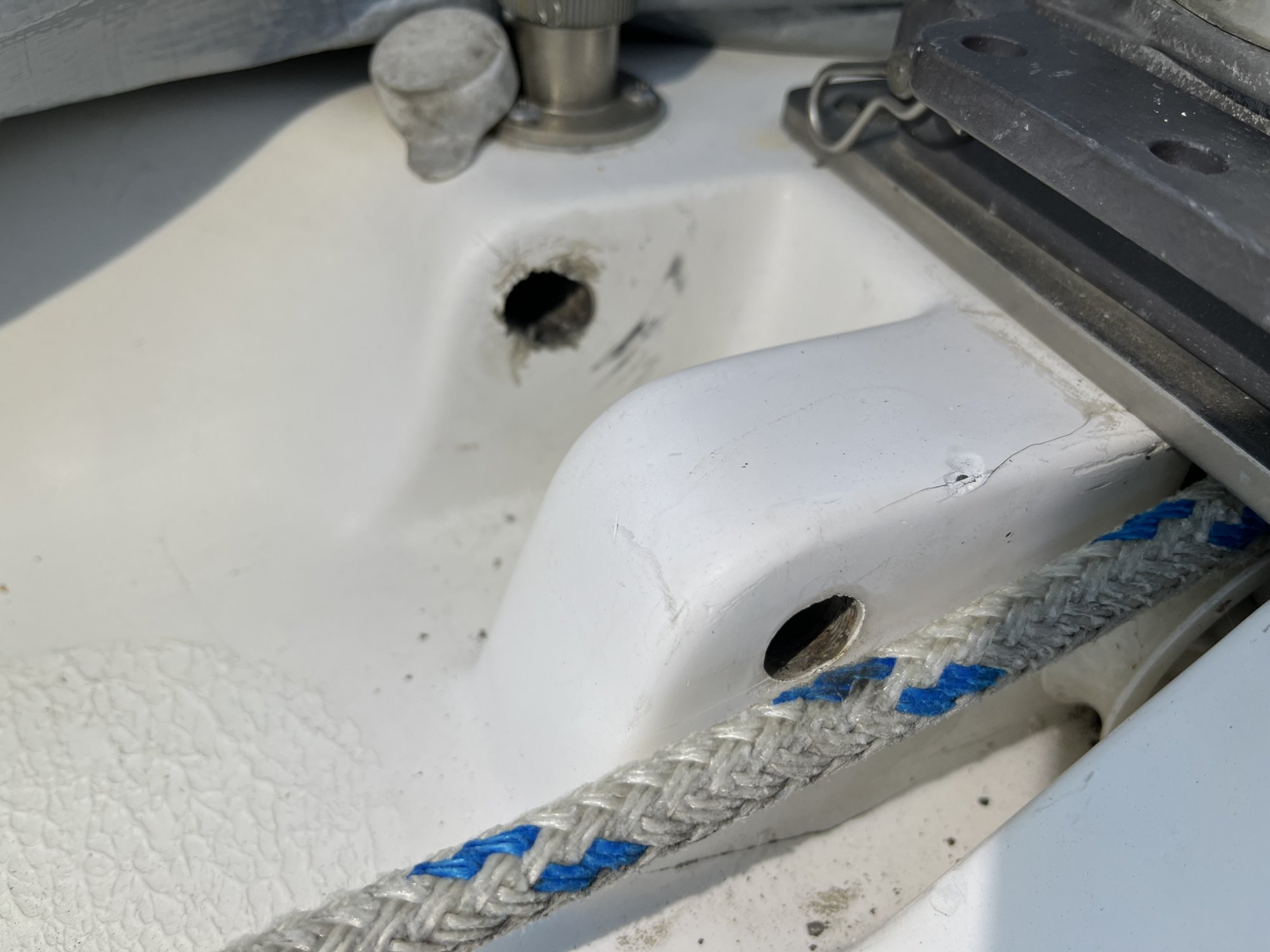

Took a few pics. You’d think a simple stainless snap ring on the end would be what secures the pin. It does end float a little. Perhaps an expansion ring? May just need to figure out a way to force it out.

Thanks for the photos…. I was thinking it was a bolted on deck organizer…so this is helpful.
Nothing in the open hole on the end (no bolt or screw head in there?

Nothing at all. Has to be an expansion ring. I’m going to try and force the pin out like Rick Webb had suggested and I’ll be sure to post process and results in this post.

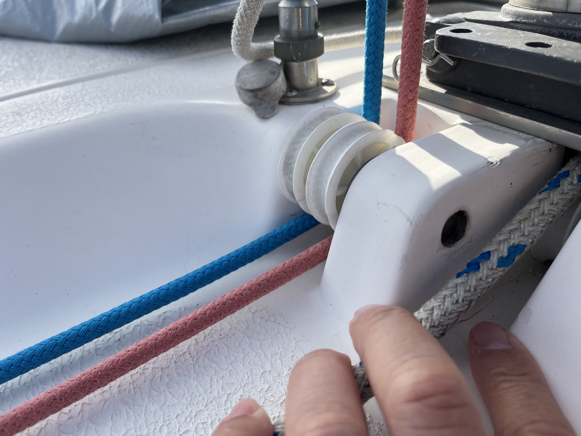

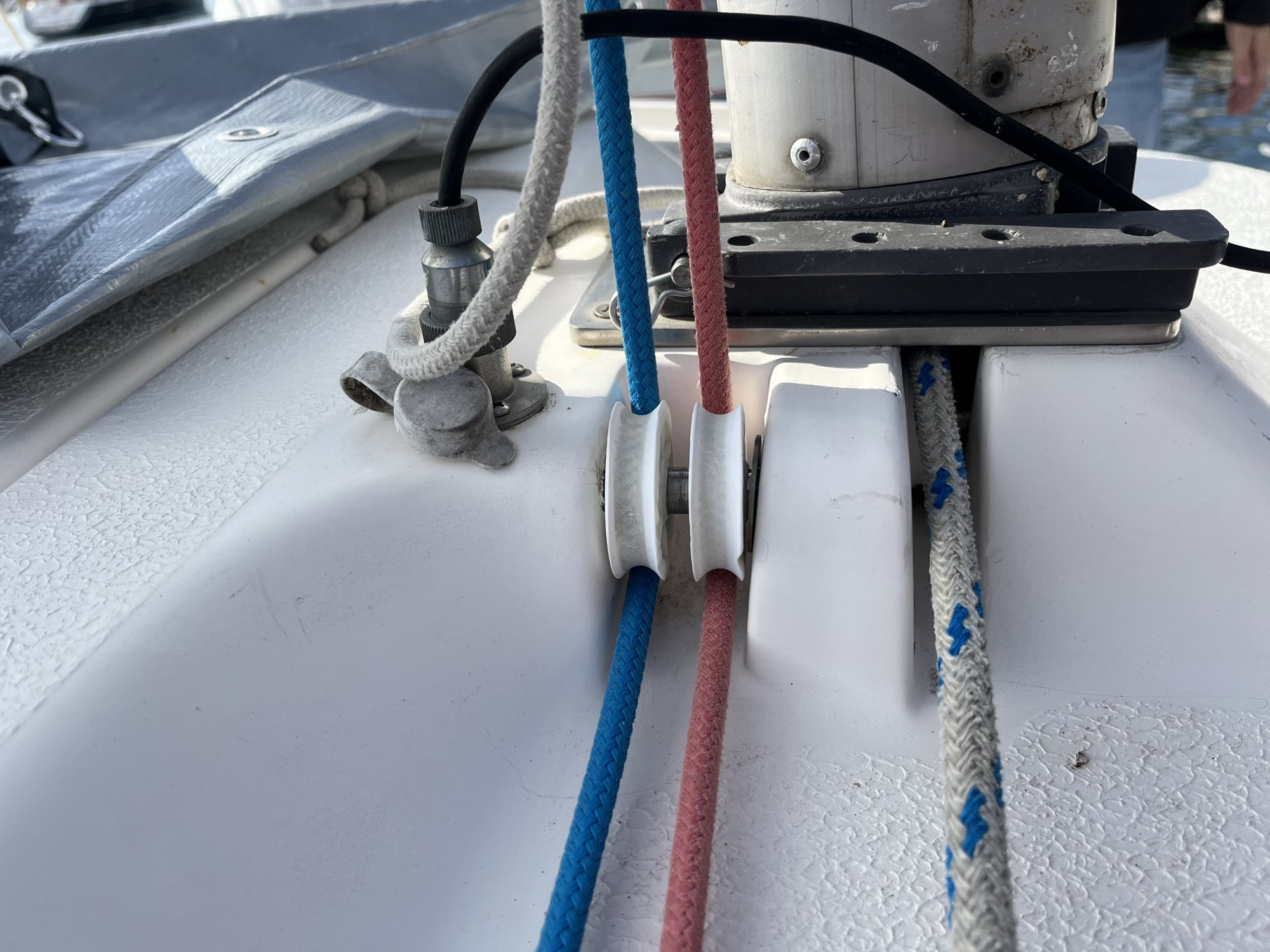

Just went out and looked at mine.
If I squeeze the sheeves together so I get a bite on the axle I am able the slide it out to the edge where I can get a hold of it. It comes out too easy actually something I am going to have to address. The goop at the end has fallen away and is nonexistent.

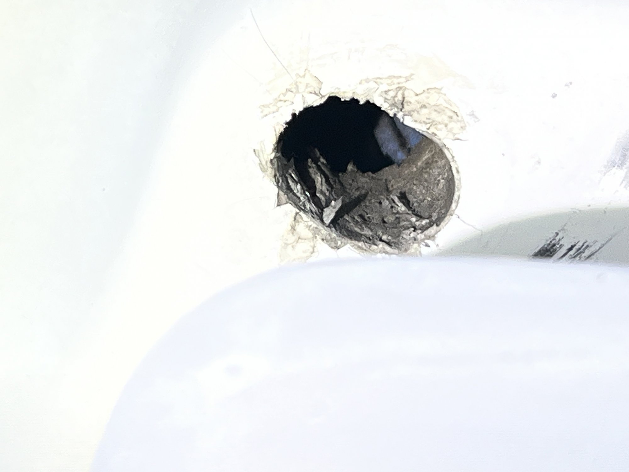

Finally made it down to my boat. Funny, after all the fiddling around, I’ve done with this over the past few months, it decided to do what yours did and just slid right out. That aft hole is not looking very good though. I definitely have to do something about that.
I don’t think that’s supposed to be completely through. I can even see the blue conduit from the deck to mast wiring. How does yours look, Rick?

I think it is supposed to go completely through. You could get a bushing and set it in with thickened epoxy or the two-part clay epoxy. Don't bother with gelcoat just mask it off and hit it with some Krylon from more than six inches away you won't be able to tell.
