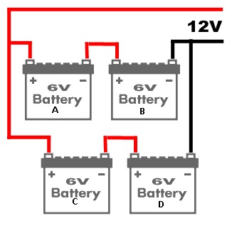

I've been messing about with 'electrickery' for a number of years, but this one leaves me wondering.
For 5 years I've had 4 Trojan T-145 deep cycle batteries connected as below, series/parallel.
To the best of my knowledge the bank performed just fine, but as of late things were not going well. A stint at the dock with shore power and a Xantrex charger has left me with half the bank.
Batteries A & B are completely trashed, yet C & D seem just fine and quite able to run the boat's systems. I don't understand why just two went so very bad.
All connections were tight and there has ALWAYS been plenty of water in all the batteries. No corrosion on any of the terminals. All the cables are soft and flexible and the crimps seem good.
It's almost like the boat has been running on only A & B all this time and C & D are like new.
So now I need two new batteries and 'they' say, "never mix old batteries with new". Am I supposed to chuck what seem to be good batteries and spend an extra $450.00 for four new batteries, instead of two? OUCH!

one thing about the diagram you have posted... you need to remember that electricity will ALWAYS take the path of least resistance, so amps out will always be drawn from the closest batteries.
this means that the first to two batteries in your diagram will be the "working" batteries in the system (except in cases of very deep discharge cycles)....
with batteries having a limited number of charge/discharge cycles in their lifespan, and with the first 2 batteries in the system being cycled, the wiring is letting the other 2 batteries just set dormant, but they are still aging.
and as you are learning thru experience here, it would almost be better to not even have them in the system if they arent connected into the system correctly.
the pos and neg wires coming from the boat to the bank will need to connect to the "bank" at opposite corners so the protons all have to flow thru the wires and all the batteries an equal distance so the bank is drawn from and charged equally all the time.
this will allow all the batteries to all be cycled together and age equally...

This arrangement is supposed to give me one, 12 volt battery bank, with one positive and one negative connection to the system.

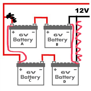

If you would be so kind as to draw me a diagram of what you are trying to explain, I would very much appreciate it.

The battery voltage and specific gravity of batteries C&D being good don't really tell you anything about their life remaining or capacity. All it tells you is that they are charged for their current capacity.
Wired the way in the original post, batteries A&B would carry more load than C&D. But I don't see why that would result in A&B being trashed and C&D being fine. If A&B discharged C&D should have supplied them and died the same death.
There must be something other than this different, or it could be that C&D really aren't far behind A&B far as remaining life.

Sorry but my drawing on a tablet sucks. But here is basically the way it should be wired.
Yes... if we take the scribbles out of the picture, thats correct.
It will allow for a more evenly balanced electron flow thru all the batteries, rather just the first two in the bank..
Thinking about it, I certainly did not have any splices or joints in the wiring, so the actual configuration was as you drew it. All cabling ran to and from lugs.
I guess that is why I don't see how A & B could be totally trashed and yet C & D seem fine. I've been running the boat on C & D without any problems for a week now.
