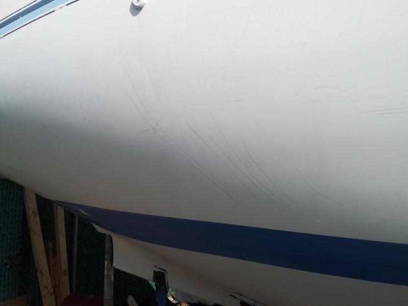

After cleaning the hull very well last week above the water line I noticed three areas of very fine cracks in the gel coat. if you dont look carefully you have a difficult time seeing them.
This one is on the Starboard side just in line with the cockpit and cabin wall.. its only located in the center between the boot strip and hull deck joint. None of the spider cracks go very far.. (what you are seeing line wise is the result of me drawing lines along the cracks to that they can be seen.. other wise the 5 mega pixel camera does not show them)

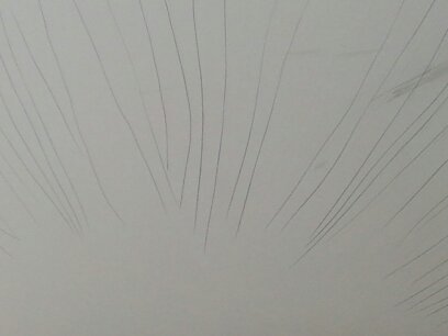

The second photo is on the opposite side from the first pictures...
They are both behind any of the rigging ubolts by about 3 feet to the stern of the rigging lines.. There is no impact sight or evidence of anything hitting it that I can see.
I am wondering if anyone else has run into this and what you may have done to repair this.. I am suspecting its gel-coat and not thru the fiberglass.
If I need to grind this down to be safe to the fiberglass then Id like to get on it before it gets to cold this year...
If it indeed is gel coat cracks can one grind then down to fiberglass then prime and fair to lvl again. Asking this as I am going to paint the above waterline ....I am hopping that this would stop the cracking through the new paint... I am sure it would crack through the new paint.
My concern is two fold.. water getting in through the cracks in gel coat and the appearance after painting.
