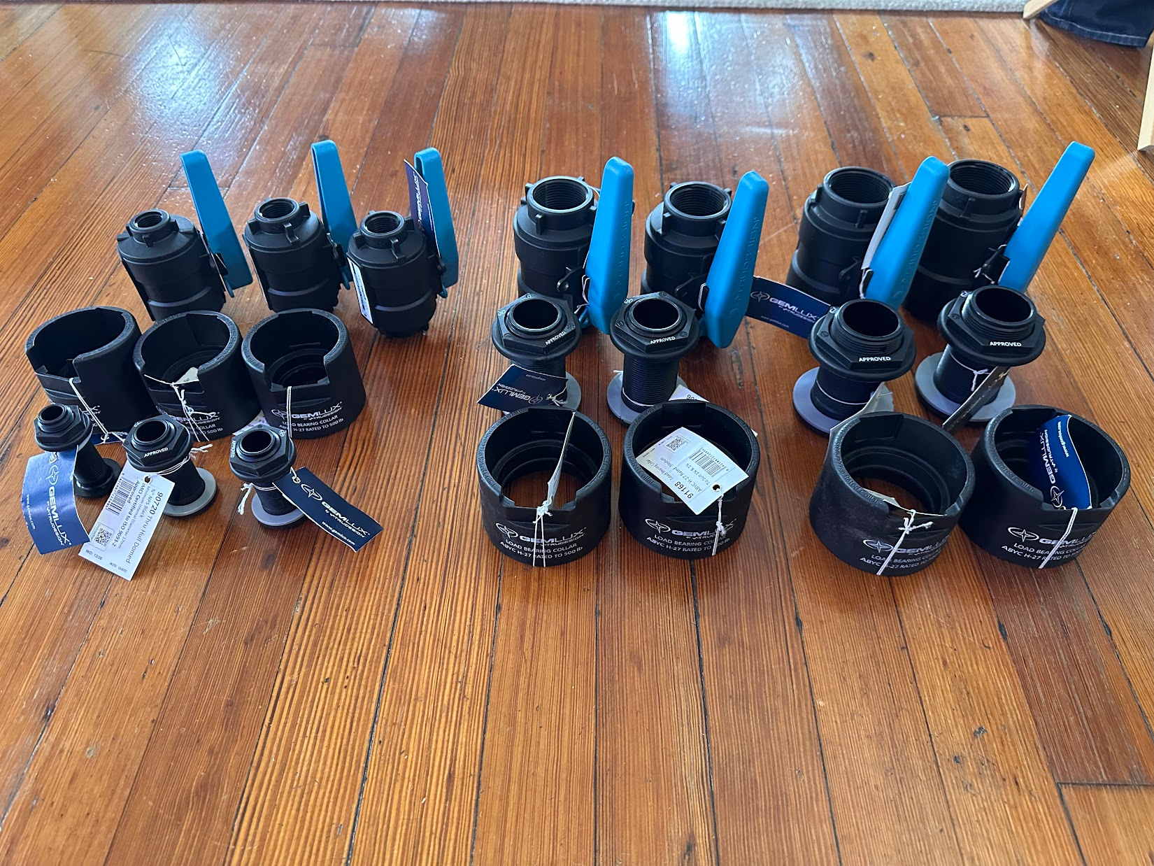

Forward Head Intake 0.75
Aft Head Intake 0.75
Engine 1" (I ordered 1.25), But I think this is the one that was supposed to be 1" - let me confirm
Port Cockpit Drain 1.5
Stbd Cockpit Drain 1.5
Macerator 1"
AC Water Intake .75
Generator Intake 0.5 - Let me confirm, I think its supposed to be 0.75 or 5/8
Galley Sink 1.5
Forward Sink 1.5 (Above the WL)
Aft Sink 1.5 (Above the WL)
I ordered the appropriate load bearing collars. Gemlux should have a 10% off your first order over 100 if you signup for the mailing list. Signup for it.
In the engine compartment, I ended up grinding / sanding down to the glass and made a semi flat mounting ring for each collar. I dry fit, marked the load bearing collar on the exposed glass. Then build it up with new glass so it was flat, and not using wood and the base.
Here is my order.
Don't forget, you'll need a matching thru-hull, collar, valve, and fitting from valve to hose for each one you want to replace.

Thanks @n0where this is what we need to get our order together! I greatly appreciate it, let me know if you are able to confirm the Engine, and Generator intake diameter. Happy Holidays!
