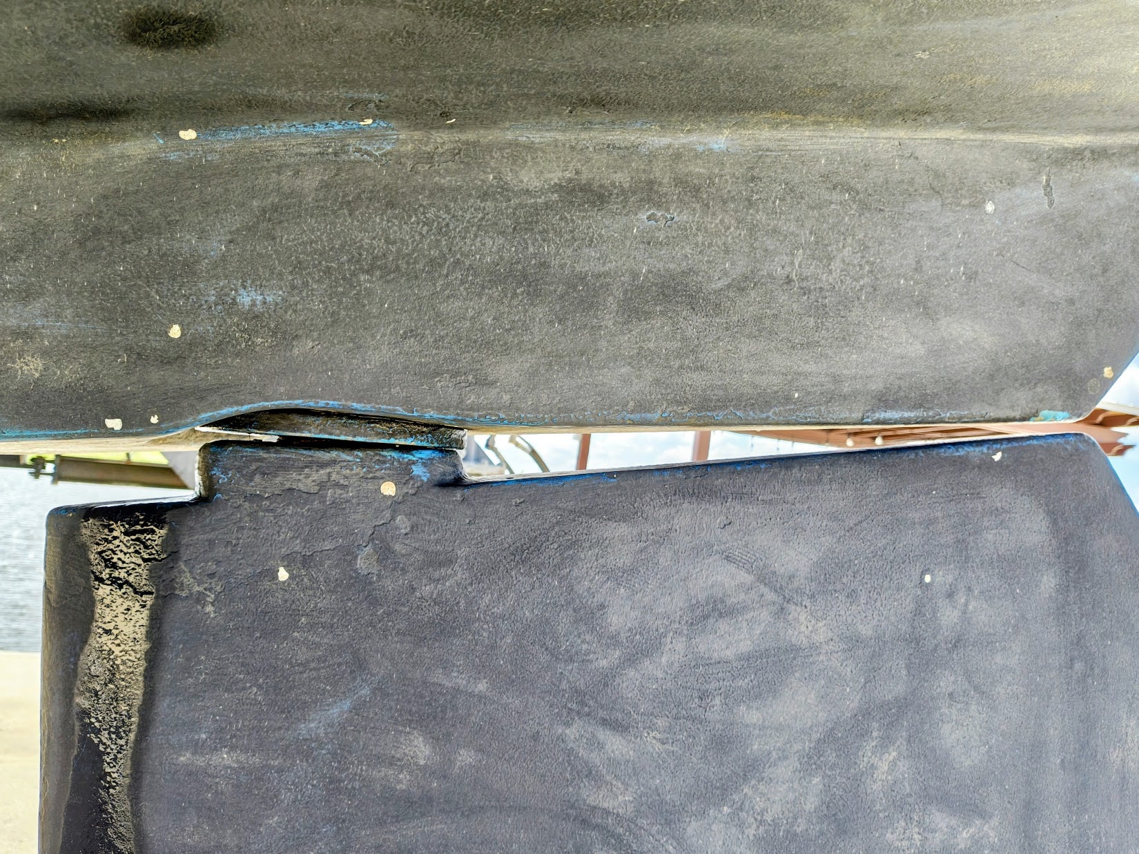

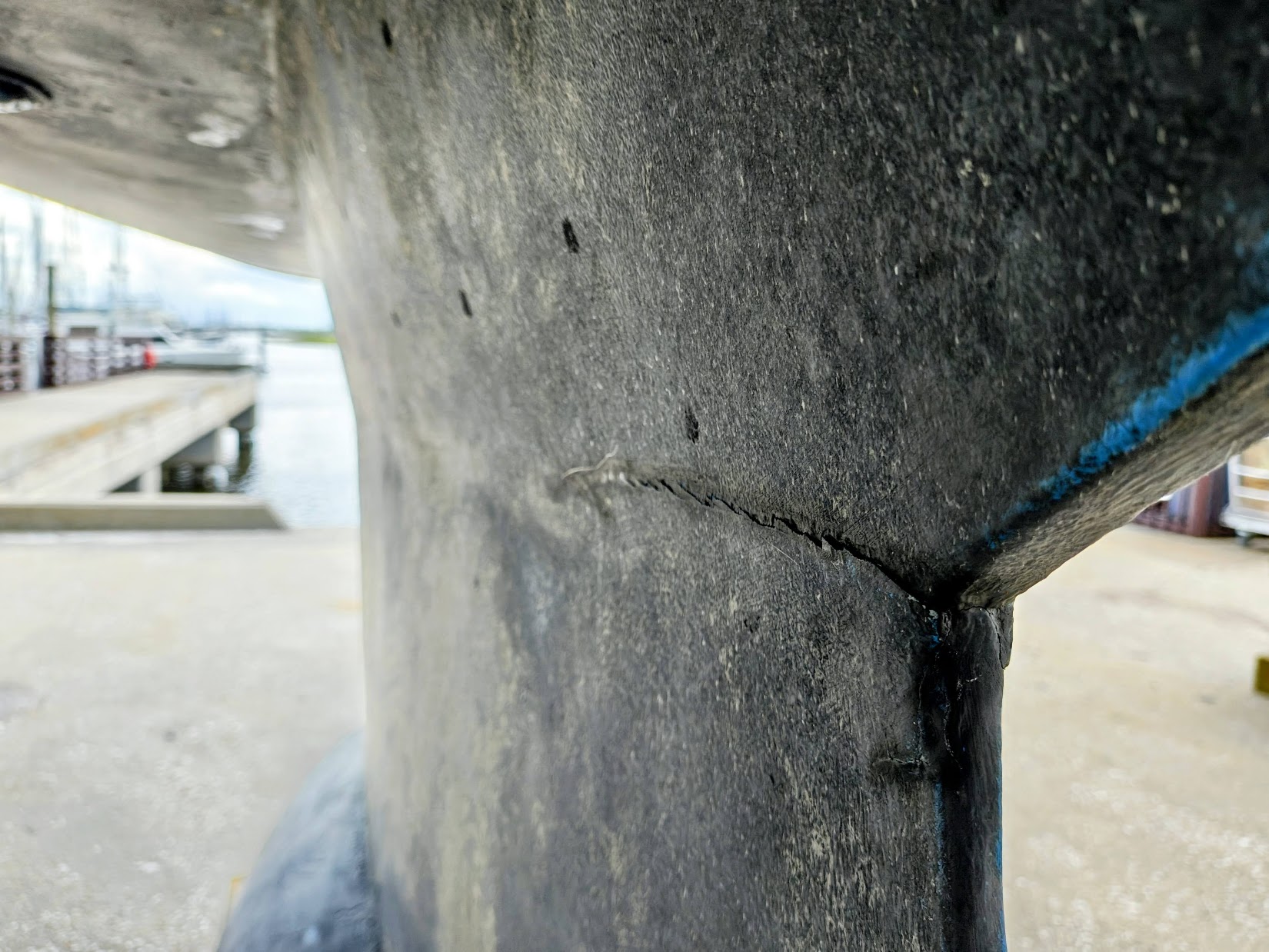

I've looked at a few H380's and recently thought I'd found THE one. Survey was done yesterday and although a few things came up during the sea trial there wasn't anything I couldn't fix. Once out of the water though that was a different story. There's a definite 'smile' on the aft end of the hull/keel joint and the rudder appears to be bent aft a few degrees. If you zoom in on the pic, the offset in the horizontal angle of the collar around the rudder post seem to match the angle between the hull and top of the blade. The owner doesn't have any pictures of previous dry dockings showing the rudder so there's no way to tell how long it's been this way. The broker made light of it saying the 'smile is delt with my torquing the keel bolts and the rudder has probably always been this way. (I doubt both)
Question is, do 380 owners out there have experience repairing the smile, or do you have any similar pictures of your rudders so I can compare if this is in fact normal? Bolts appear clean with no corrosion and the rudder works freely with no grinding or rough sounds.
Current owner has only had the boat 2 years and just returned from and extensive Bahamas cruise.
Any past experiences or input would be appreciated. Purchase is on hold till I get the full report from the surveyor and do more research about these issues.

That's not much of a smile, more of a crack from a good grounding.
Be sure to count your fingers after shaking hands with the broker. This is how much damage from the grounding that you CAN see. What CAN'T you see from this impact ?

If it's like mine, it's just the polyester fairing that cracked between the lead keel and the fiberglass stub. Every single one i lookedmat had that (or had it repaired). fairing compound is quite thick. Corrosion of the lead would not be a big issue from this minor displacement. Does it open up in the slings? If not, put it on the hard, retorque the keelbolts (250 ft lbs for lubricated threads) , grind down the fairing and either repair with polyester fairing or thickened epoxy. Mars metals in Ontario can provide the instructions.note, you'll need a special 8 to 10 in long socket (1 1/2 in diam) to torque the bolts and about 30 inch extension for the torque wrench.
As for the rudder, that's not normal. Hard to tell what the issue is without dropping it. A new rudder should be available through Foss Foam. How's the bottom leading edge of the rudder? If the boat is in Florida, replacement would not be very expensive.
Also inspect the top of the rudder tube block... need to remove the aft cockpit floor pan for this.
For sure has a bent rudder stock or displaced tube.
Nothing serious is evident from those photos. Has your surveyor inspected the grid (and inside of it with an inspection camera? That would be necessary to determine if there are more serious underlying issues. Remove all the floorboards....
So long as the grid and rudder tube are intact, it's all easily remedied.
If it's otherwise the right boat in the right place, I 'd drop the offer price and have the owner remedy to your satisfaction... they might be able to go through their insurance.
If they object, walk away... you'll likely then see it advertised for $20k less as now they know about the defects...

Thanks, that's exactly the information I was looking for. Sounded like the smile could be repaired but many unknowns with the rudder. Current owner is a very nice guy but didn't offer any explanation on to how came to be like this. Said he's had the boat less than 2 years and didn't have a survey when he purchased.
Nice to see the rudder replacements are available. I removed the small panel behind the bunk in the aft cabin but couldn't see much of the tube the rudder shaft is housed in.
Expense is relative, but I do know a replacement rudder from Foss in Florida will be a minimum of $3,000 if they have the mold for it, and an additional $1,000 if they need to make a mold. I don't know whether this is inexpensive in context of the value of the boat.

You may be able to have the bent rudder shaft straightened - I had one with a good size bend in it straightened perfectly.

First, no one can reliably tell the extent of a keel issue from a picture.
Second, the PO can’t possibly NOT know about either the keel or the rudder post issues
Third, I wouldn’t trust anyone’s judgment or integrity when the PO claims he didn’t have a pre-purchase survey done.
Last, Foss Foam rudders of that size typically cost around $6000 for replacement.
Rudder post appears to be bent, according to your picture. A certified marine surveyor can tell you whether it can be repaired and approximate cost. As far as the keel smile goes, the right way to repair it requires that the keel be dropped, fair both surfaces, re-bed with 3M 5200 or equivalent, torque keel bolts. Have a marine repair tech determine whether the keel threads have been stretched from the strike. If so, shim the keel nuts up to fresh threads before setting. Our smile repair done this way in 2004 has remained solid ever since.

The keel to hull joint uses an epoxy adhesive.... Lift the boat, unscrew the nuts and the keel won't move....
Every 380 I looked at had this, or had it recently repaired with just a few hrs of Labour.... There's no evidence of a grounding that we've seen, except maybe for the rudder.....
If it doesn't change in the slings, it's just fairing that's getting brittle with age....
