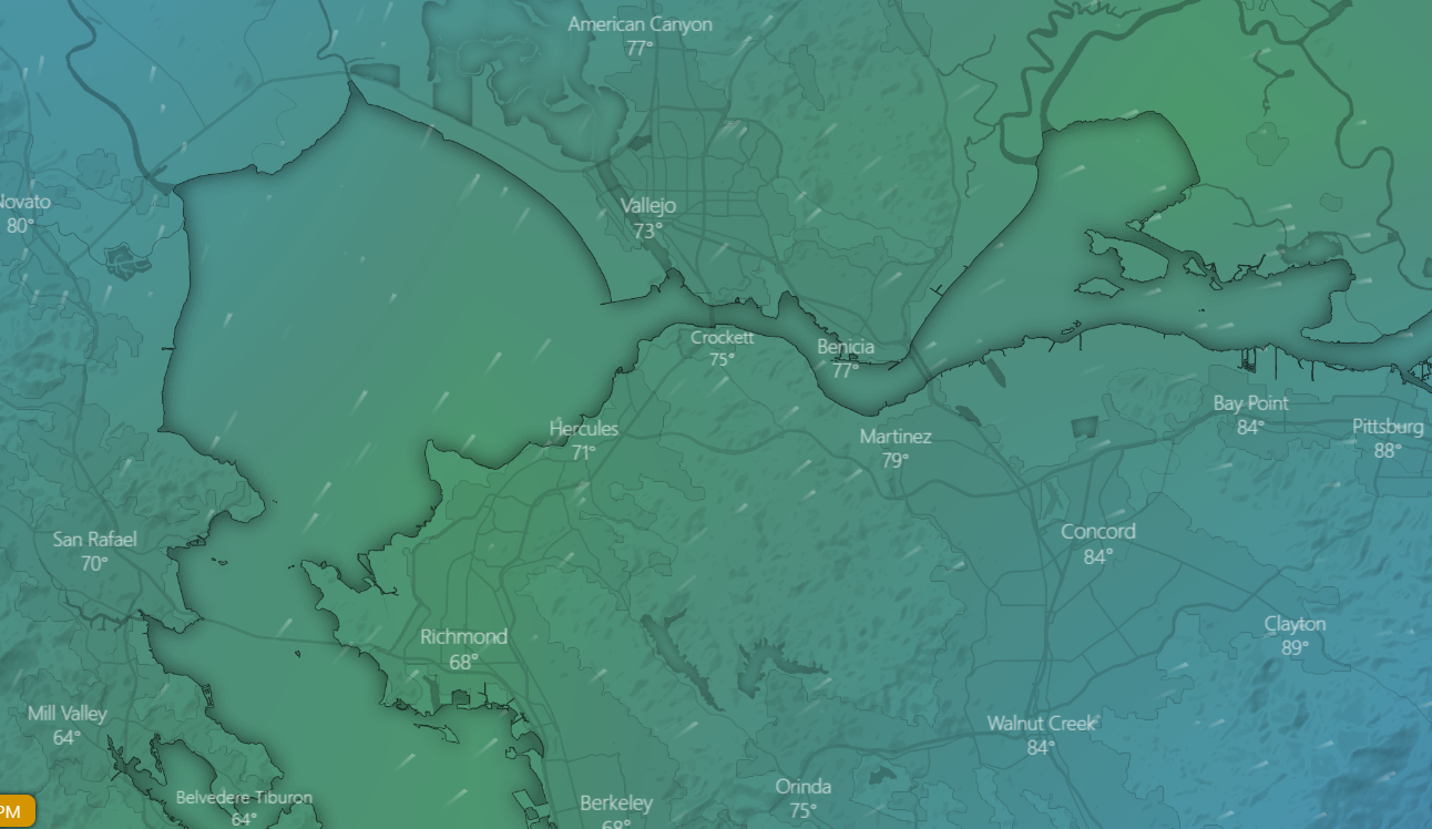

Not totally..........when you sail to the Delta through the Carquinez Strait from the Carquinez Bridge in Vallejo to the southwest side of Benicia you are often on a beam reach and when you sail back to the San Francisco Bay you're beating all the way back, except through the Strait. Some where on either leg you might need to reef at some point as the wind begins to gust, so with a furling in-mast mainsail you need to be on the appropriate tack to do so. Below is a snip & sketch from "Windy" Windy: Wind map & weather forecast showing wind directions at various points in the San Franciso Bay to the south, San Pable bay to the north, Carquinez Strait between Vallejo and Benicia and Suisun Bay to the east.
23,152
I know it very well. Sailed the Vallejo Race a couple of times, up both rivers and to The Delta on my C25 and this boat a dozen times. Nice for others to know, though.
