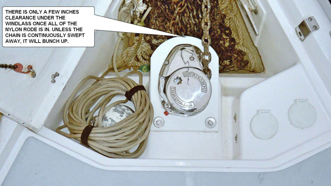

I have an '07 Hunter 38. My primary anchor rode is 50' of rope and 200' of chain.
When using the windlass to pull up the chain, the chain will pile up on the flat angled aft wall of the anchor locker and will quickly get high enough to jam the windlass. When weighing anchor I am at the bow with wife at the helm, and I will just grab a handful of chain every 10' or 15' of chain and move it.
I will be single handing for a month heading south in a few weeks and will need to manage this by myself. I have purchased a wireless remote winch control to install, but this isn't going to help me if the chain issue isn't fixed.
Anyone faced this before? Any suggestions? Perhaps something I could insert into the locker to prevent the piling up?

This is caused by the drop from the windlass being too shallow, the chain just piles up. If there is a slope, you might try putting a slippery plastic on the slope to help the chain slide down into the deeper section of the anchor locker.

Yes, that is the reason. Just reducing friction won't make much difference as the slope is shallow enough that the chain rests against itself.
I was thinking an insert like a peaked roof or something, so the chain falls off to either side.
Anyone with actual experience solving this?

I've got exactly the same arrangement and haven't come up with a solution to the problem yet.

There is no simple solution to this problem unless you want to rebuild the anchor locker and then extend the locker into the V-berth below, hence we use work arounds. In this case it's not even a workaround, it's just a technique and very simple one at that.
I certainly don't want to pull the boat with the windlass
You retrieve short lengths of rode and then allow the boat to coast towards the anchor location with the windlass sitting idle. The windlass motor doesn't build up any heat doing this and that's the only thing of concern to the motor.
Your boat is 38 ft. not 100 ft. with a massive anchor locker. You are not going to be able to hoist your anchor from the helm via remote control without jamming the chain. And you're not going to be able to launch a couple of personal water craft which are stored within your transom.
Your boat .............. accept it as it is with its built in limitations or get a 100 footer.

Been a solo sailor for years, even with crew on board. Our boat has an electric windlass and a shallow anchor well, too. Whatever the conditions, I always bring up the 50' of chain, whatever rope and anchor the same way every time. Never had a problem with the chain bunching/jamming. While the engine runs at idle and in neutral, I pull in any rope by hand unless a strong wind. then I use the windlass drum to bring the rope in, paying it into the locker by hand as it spools off of the drum. When the chain/shackle wraps the drum by a full turn, I move the chain over to the gypsy by hand. As the chain spools off of the gypsy, I pay it into the locker by hand thus avoiding any chance of bunching or jamming. Doing it this way also allows me to inspect the whole system for any issues as I feed it into the locker.

If your anchor locker looks similar to @Ralph Johnstone's then it wasn't designed for 200' of chain. Most coastal cruisers use a short, 30-50' piece of chain and a nylon rode. If you use 8 plait rode, it will not harden up like 3 strand and will collapse into a small pile leaving room for the ~30 feet of chain.

It's bigger than that, deeper, and with a sloping bottom, but the same issues. Yes I have 50' of 8 plait on the end of 200' of chain, all of which I deploy when anchored behind Flemming Key.

I use a boat hook and push the chain down as it comes up. If you don't have a remote for your windless you can easily install one, now cost around $20.

On my 38' boat I have no such issue, nor did I on my Catalina 36. It's not the size of the boat, it's the design of the chain locker.
